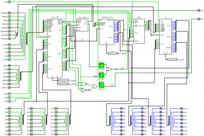

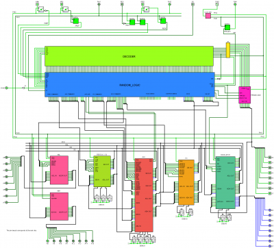

Hi, we have completed the 6502 circuit design in Logisim.
https://github.com/emu-russia/breaks/tr ... 02_logisim
There are two options there: for classic Logisim 2.7.1 (6502.circ) and for Logisim Evolution 3.7.2 (6502_Evo.circ).
The schematics kind of works and all main processor parts are implemented, but it obviously still needs to be debugged.
Probably, it will be interesting for someone and we will finish it together :)
