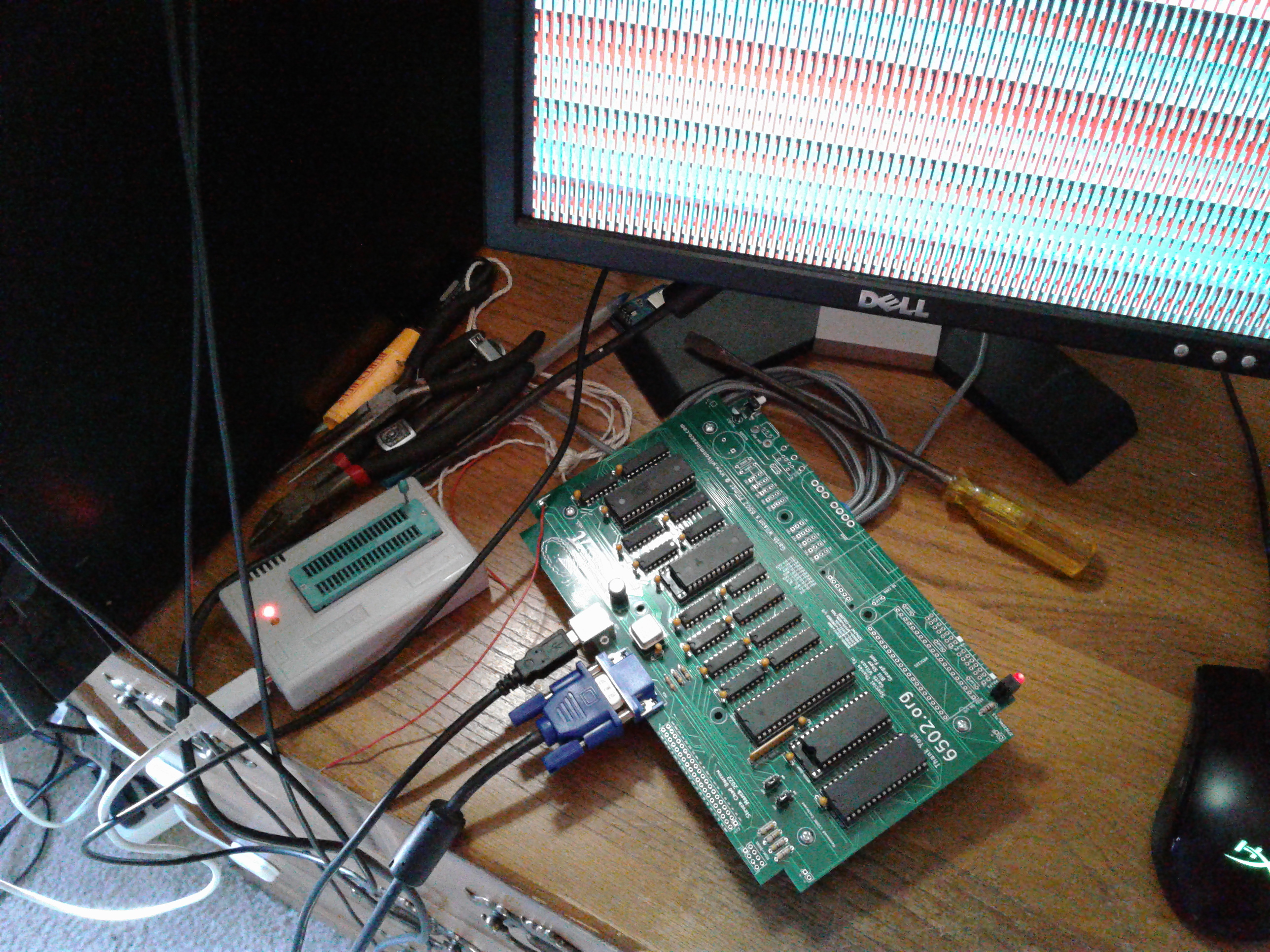

Hello everyone! I've been off doing my own thing for a while, and now back I come with a plan.
I've been inspired by Bill's (plasmo) discussion on Apple II style VGA graphics card: viewtopic.php?f=4&t=6955
So I am attempting something like that. 6502 accesses RAM on the high clock, VGA accesses RAM on the low clock.
My last attempt at VGA failed because of Video RAM access issues. I had stable timing and display, and VGA had clean access to RAM, but whenever I would try to change the image with the 6502, something would go wrong. I hope to prevent the same issues here.
Attached are my schematics in both color and B&W, and also my VCC/GND layout on the PCB, again in both color and B&W. I have run the auto-router already and it finishes in minutes (but optimizes via count for days!).
I am using 74HC' logic chips instead of a CPLD or something else convenient because I want to use this for training and educational purposes, granted that it actually works. I am trying to go for the most simplicity possible (as in, only 16K of Video RAM) while still retaining some basic features (as in, at least some color). I'm also going with a 2-layer board because of cost. I am able to increase the size of the board dramatically to accommodate all the chips without having a dramatic increase in price.
I've been through this thing a lot over the past weeks. I could have mistakes, but at some point very soon I'll just get it printed and test it out. If you want to check it over, I would appreciate the second set of eyes. But do not feel obligated. Making mistakes is how we learn!

PostPosted: Thu Feb 24, 2022 6:45 pm
Posts: 741
I think from the schematic it looks pretty sensible, and clocking it based on 8 pixels at a time should be comfortable enough that you won't suffer badly from propagation delays (things like the tranceivers having to switch back and forth).
Have you made a prototype already or are you going straight to PCB?
I think there may be an issue with the timing between U15 and U16. Firstly, you're using a latch at U15 - I think a flipflop would be better. The issue is that your latch is going to reload whatever is on the data bus throughout half of the eight-pixel cycle (when H4 is low), and for the early part of that time the data on the bus won't be stable (it takes a while for the transceivers U13,U14,U18,U19 to swap over, for the RAM to look up the new address, and for its data outputs to stabilise on the data bus as inputs to U15). In my designs I use a flipflop here and clock it at (or slightly before) the end of the half of the cycle when the video system owns the bus, so that there's been a whole half cycle of time for that data to become stable at that point, and we're about to release the bus to the CPU.
Another issue is with the timing of U16 - I tried something similar, for 320x480, using a quad 2-to-1 multiplexer to split out two pixels of data. The issue was that it's hard to ensure the multiplexer switches in sync with the point at which the new data is loaded into the latch U15 (or flipflop in my case, as I said above). In your case I believe this would be when H2 and H4 are both falling. The latch may operate faster than U16, and present new data before U16 changes which bits it is selecting; or slower, in which case U16 might change first, briefly outputting an old pixel value.
A solution to this is to put yet another flipflop on the other side of the multiplexer, clocked just after the multiplexer (and possibly the latch/flipflop U15) change state, so that there's a little time for both U15 and U16 to do their jobs and U16 to output the correct new signal. e.g. I think you could clock this flipflop with an inverted or otherwise slightly delayed H1 to achieve that. I would then pass HSYNC and VSYNC through that same flipflop, so that all transitions of the signals going to the monitor are in time with some master clock (in this case H1 rather than the VGA clock, but that should be fine as all the HSYNC boundaries are even numbers).
I didn't check the logic gates in detail but it also looks like your RAM is not active for the range that you stated in the notes on the schematic - it's only active for 0000-7EFF, and ~IO signal goes low for 7F00-7FFF, but the VIA is also only active for half that range because one of its CS lines is fed by A7. This might be fine, I just point it out because it differs from the notes.

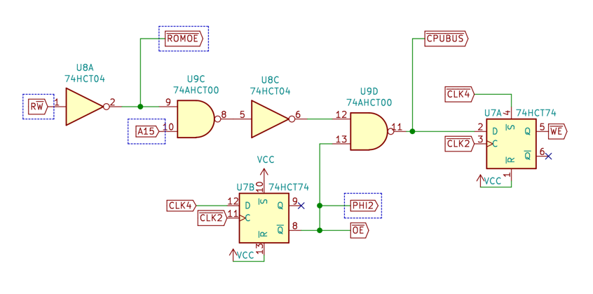

I've been looking at George's schematics much more closely now. And I truly am confused about one little part!
https://github.com/gfoot/simplevga6502
On the '74 flip flops, George is using /CLK2 as the clock. That means, in my mind, that a falling edge is what triggers the flip flop.
But when I lay this out in Excel, I see that it should rather be CLK2, not /CLK2. That is a rising edge, instead of falling edge. I must be terribly confused!
If using the rising edge of CLK2, we get the flip flop holding CLK4 or /CPUBUS in the middle of CLK4. Basically shifting the signal by a time of CLK2.
But if we have the falling edge of CLK2, we get the flip flop holding simply the inverse of CLK4 or /CPUBUS, which is certainly not what George in intending.
I have looked at the datasheet for the '74 and I must be missing something small here. I know what George is wanting to do, but I don't see how the '74 does that in this particular configuration.
Thoughts? Assistance?

PostPosted: Wed Mar 02, 2022 6:14 pm
Posts: 741
Yes, I meant to mention it in the PM just now - that configuration is wrong and I'm not sure why it worked! I was very confused when I discovered that, and double-checked it between the schematic and the circuit because it shouldn't really work - but the schematic matches the circuit.
What I'm actually running at the moment though is a modified version, consolidating those two flip-flops and most of the logic gates into a simple PLD. I haven't had time to really write up the details of that yet though. :(
Edit: Here is the PLD code I'm using now, in case it's useful. Most of the signal names here are the same as on that schematic. LCP is the clock pulse to the flipflop after the RAM. VCP is the clock pulse to the vertical counters.

Well, here I am, giving it another go! I've had a fair amount of time at work to play around with this (no time at the house though!), so here we go:
Attached is my timing Excel spreadsheet, as well as the new schematic. On the schematic itself there is a 'graphical' timing display.
I borrowed heavily from George's design ideas. Instead of using the 74HC74's though, I decided to just use NAND's and NOT's, but the timing is the same.
I also slowed PHI2 down to 3.14 MHz, giving me plenty of time to grab data from the RAM at the tail end of a high clock phase without overclocking. The trade off is that I had to grab all 8 bits of data for color to make it to the next latch! So I moved the signals over to a FlashROM instead, and because PHI2 is slow enough to access it, I was able to remove many logic chips and replace it with a single programmable one!
Writing to the Video RAM is back to the 'Apple II' style, just as George does. PHI2 high is for the 6502, PHI2 low is for VGA.
The logic chip count is FAR less now, and I am able to manipulate the timing using an EEPROM programmer. I still have room to make other timing signals, so I might see about reducing timing logic even further, who knows!
Thank you George, and thank you everyone else. I'm going to print this thing very soon, because I'm tried of manipulating schematics and want to get to coding!
Chad
EDIT: I'm removing those schematics. The timing was *still* off. I won't post any more until I have it printed and working. Thanks!

Posts: 718
Hello everyone!
It works!!! :)
Attached is just about every file I can think of. Schematics, assembly, pictures, and video.
320 x 240 x 4 colors (black, white, red, and cyan). 6502 is running at 3.14 MHz. 32K RAM, 32K ROM (banking possible), and 32K Video RAM shadowing the ROM.
As you can see, I had to do 'surgery' to it. In one place I was missing a connection entirely, and another was inverting something that should not have been inverted.
The oscilloscope was VITAL to this operation. Without it I would have been completely in the dark. And the EEPROM programmer made things efficient and fast. Oh, and these non-circular sockets are *crucial* to popping them in and out so often!
When I get cooler demos I'll show them, but for now, this is good enough.
So much learning in this project. Thank you, everyone, for your help, support, time, and patience with me.
Chad
