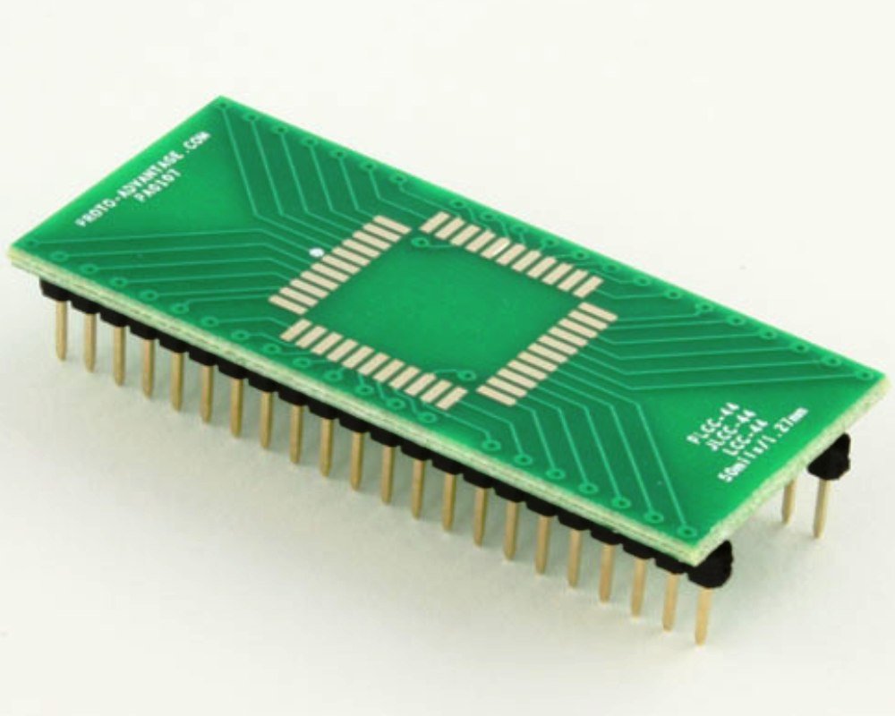

One option that might help the beginner is look for a PLCC44 to DIP44 converter on eBay. These are dirt cheap and will allow you to plug it in like a normal DIP...although they are longer in that they have 4 extra pins. Just be careful and read closely. I bought some once and didn't realize it was a PLCC44 to DIP40 converter (it dropped four pins).
I'm a bit late to this party, but I'd just like to add that I've had good luck with these Proto-Advantage adapters. They're a hair under $15 on Amazon and since they have no socket they don't cover the whole dang breadboard width. They're also a good way to practice your surface mount soldering as you'll need to attach not only the chip but also the surface mount pin headers along the bottom.
