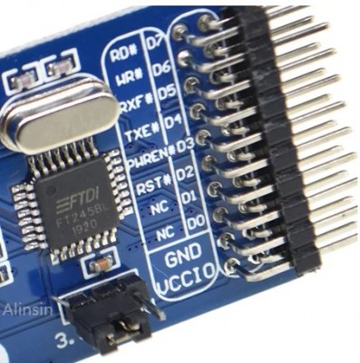

just throwing my 2 sents into this.... for the simpliest possible Serial Interface to a modern machine, the UM245R is pretty good.
i used this thing in my very first breadboard computer, with a Z80 running at 10MHz. it can also reliably handle a 65C02 running at 16MHz without wait states.
it's a 5V/3.3V breadboard friendly breakout board for the FT245R, basically a complete UART and UART to USB Adpater in a single chip. (the board also has a USB-B Connector)
it's the most simplistic option available. all the CPU can do is read bytes from the receiving FIFO, or write bytes into the sending FIFO. there are also 2 output signals that can tell the system if there is space in the sending FIFO (TXE = 0) and if the receiving FIFO has data in it (RXF = 0).
but other than that, it has no extra features. no interrupts, timers, etc. it's purely for communication. (hooking it up through a 65C22 would make it more feature rich. allowing for interrupts when data comes in, etc)
and besides the decoding logic to actually access it, there is nothing extra required to get it running, just the 8 bit data bus and the 4 control signals (RD, WR, TXE, and RXF).
the baud rate, start/stop bits, etc can be changed on your PC when you connect it via USB.
sorry i just really love these single chip 8-bit to USB chips from FTDI. they are so damn convenient.

+1 for the (UM)FT245R. I'm using it on my 6809-based Vectrex and it works great, right up to 921,600 as a Forth terminal on my PC via USB.
Importantly, it has easy driver install and no hangups, unlike several other TTL to USB interfaces I've used.
You've sort of glossed over one of the key advantages it has; built in TX and RX buffers so, whilst you can use it via an interrupt, you don't need to because that's all handled on-chip, you can just poll it occasionally and empty the buffers accordingly.
My minimal decoding for the control lines is one dual 4-input NAND and one hex inverter, because that's what was it the box at the time, it could be done more efficiently with a '138 or '139.

Folks using the FT254RL (in UM form or just the chip) - how are you address decoding the control lines? Particularly the TxE and RxE. I'm currently struggling over a compact circuit over on page three/four of this thread.
I'm just using an SN74x541 with TXE on A0, and RXF on A1 with the rest connected to a pull-up resistor array. B0-7 are just connected to the CPU Data Bus.
the actual address decoding for it and the FT Chip is done by an ATF1502/1504 CPLD. it only takes 3 output pins for both (RD and ~WR for the FT, and ~OE for the 541).
I'm using a Dual 4-input NAND and a 4 Invertors for decoding RD and !WR, for RxE I'm using a 6522 VIA input, I'm not using TxE.

I'm using a 74HC245 as a separate I/O device to put the status lines on the data bus whenever I select it and PHI2 goes high. Of course this will cause a collision if you ever try to write to the status lines, but the answer to that is: don't. Seems fine for a first build but I'll probably use a real UART later. The FT245R has been great for just getting my beginner compy off the ground though.
