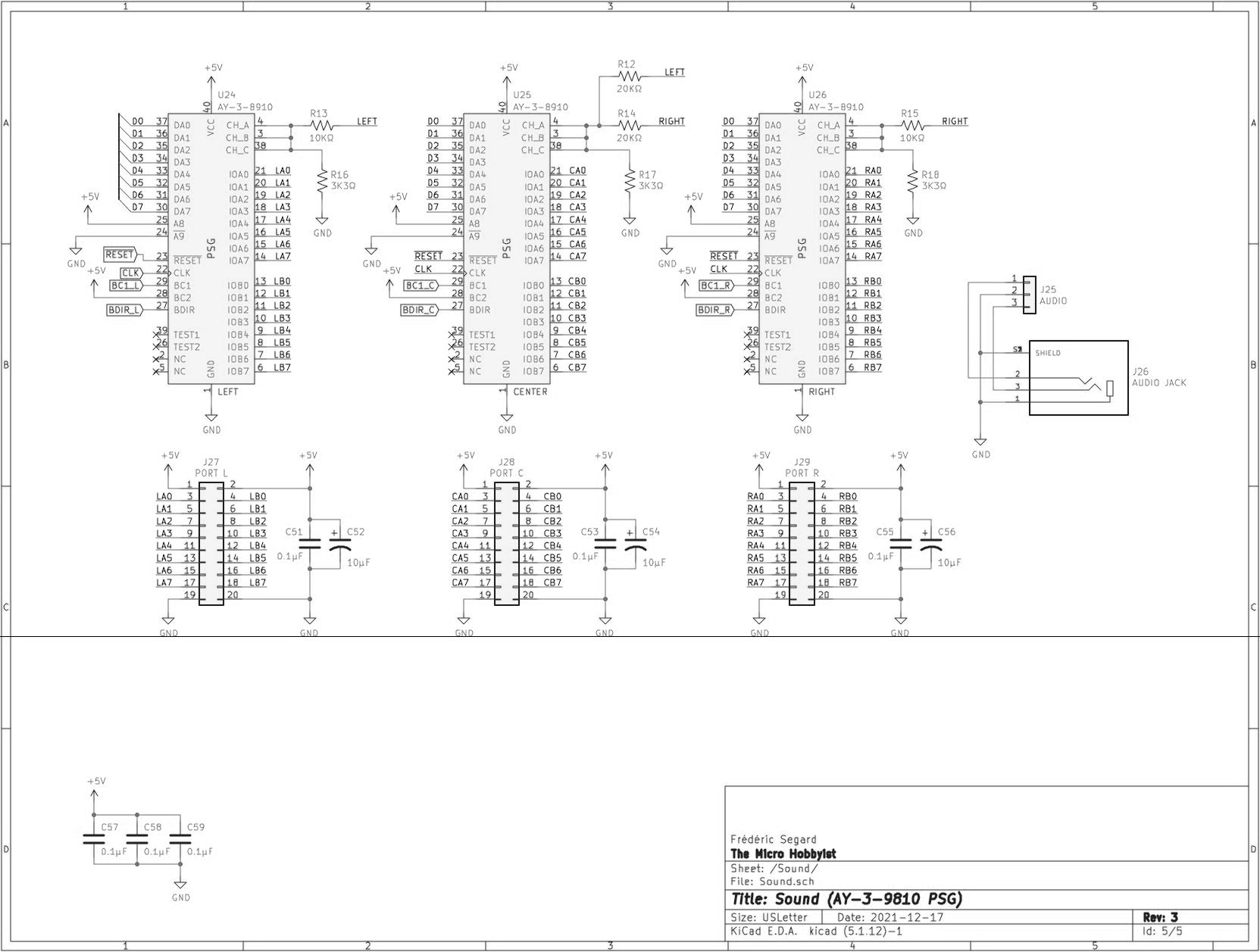

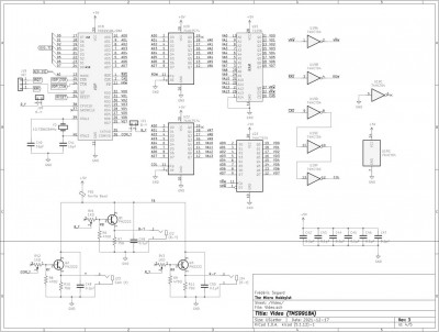

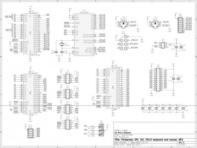

I have finished my schematics for my 6502 computer. Any do's and dont's, advice, ideas, and/or critiques are welcome.
PS: I realize I forgot to put the 40x4 LCD. But then, since I have a VDP, it might not really be necessary.
File comment: CPU, ROM, RAM, decode

File comment: 3x VIA (I2C, SPI, PS/2 keyboard, PS/s mouse, NES controller)
File comment: TMS9918A/28 VDP
File comment: 3x AY-3-8910 (Left, center, right)

PostPosted: Sat Dec 18, 2021 3:51 am
Posts: 8464
Please don't take this as condemning; but I think more people would be willing to take the time to check the details if you draw an actual schematic, instead of just a netlist written around boxes. When the connections just have tags, we have to look everywhere for the matching tag. (A few like address and data lines are understood; but many more are not.) We see this all the time on the forum. [Edit, 12/22/21: I added some tips on how to get forum help, in the second half of the 6502 primer's page about general steps for a successful project, at http://wilsonminesco.com/6502primer/steps.html, after the heading "Getting help on the 6502.org forum:"] I can't take the time now to look at the details; but one easy thing I see that can reduce the risk of damage from plugging something in backwards is that on your VIA port connectors, you flip power and ground on one row, so for example on J15, pins 1 & 24 will be +5V, and 2 & 23 will be ground, or vice-versa.
PostPosted: Sat Dec 18, 2021 3:56 am
Posts: 3366
I'd be glad to help. But, honestly, I find it too laborious reading a schematic like this. Maybe that's a valid critique and maybe it isn't; I'm only speaking for myself.
Oh -- and for BigEd, too, who recently opined, "But the kinds of schematics which just show a field of isolated components with all the connections as stubs isn't, to my eyes, as good as one which follows a logical block diagram."
Yes the information is all there. And some questions are easy to answer, like, "regarding IC pin blah-blah, what signal does that connect to?" But not so much when you turn the question around and want to know, "regarding signal so-and-so, what IC pins does that that connect to?" :evil:
(Oops, I see Garth has posted while I was typing. Like him, I hope you don't take this as condemning.)
PostPosted: Sat Dec 18, 2021 4:30 am
Joined: Wed Aug 05, 2020 8:41 pm
Posts: 47
Location: Montreal, QC, Canada
... take the time to check the details if you draw an actual schematic, instead of just a netlist written around boxes. When the connections just have tags, we have to look everywhere for the matching tag.
Valid point. I'll be careful in my designs next time.
... but one easy thing I see that can reduce the risk of damage from plugging something in backwards is that on your VIA port connectors, you flip power and ground on one row, so for example on J15, pins 1 & 24 will be +5V, and 2 & 23 will be ground, or vice-versa.
Oh! Yes, I see the error of my ways on this. Thanks.

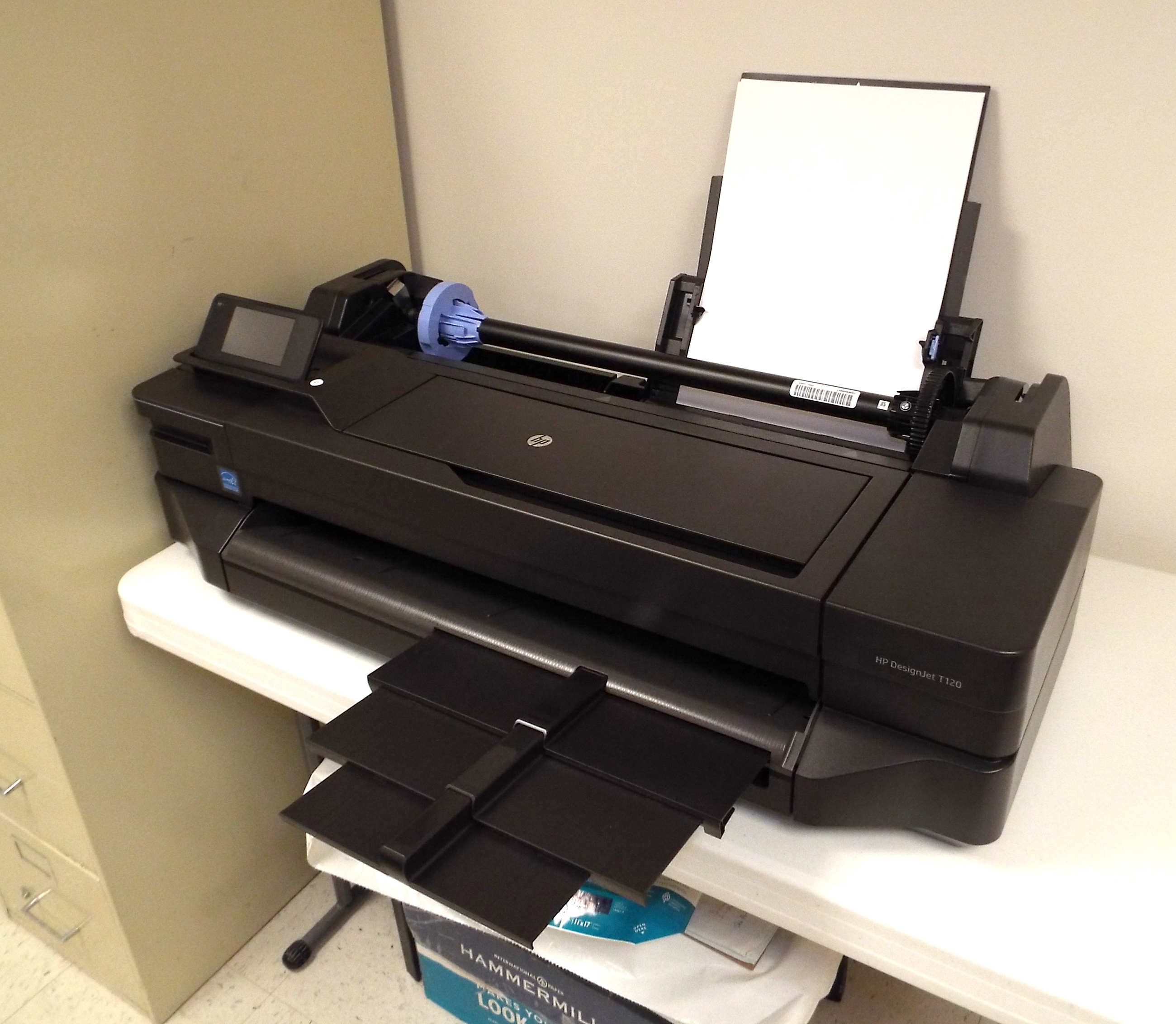

PostPosted: Sat Dec 18, 2021 4:21 pm
Posts: 8252
Do any of the schematic-capture programs allow you to do huge sheets, then print them in sections that fit on 8½x11" sheets and tape them together (since no one has printers or plotters anymore that can handle pages two or four or more times that size)?
Large-format printers are readily available and relatively inexpensive when compared to what was available in the past.  My H-P T120 printer, which takes cut-sheet or roll paper, can do architectural D-size, which is 24" × 36".  It cost me a hair under $1000 US to purchase new.  I got it about three years ago to replace my H-P DesignJet 70, which could do architectural C-size (18" × 24"), but wore out after some 15 years of continuous use.
File comment: H-P T120 Large-Format Printer
For scale, the paper loaded into the cut-sheet feeder in that photo is ANSI B-size, which is 11" × 17".  To print the larger sheet sizes, a 24"-wide roll of paper is loaded onto the spindle at the rear of the printer—rolls typically come in 150 foot lengths.
Pen plotters seem to have all-but-disappeared.  One of my clients is an engineering firm that, at one time, had several plotters, including a monster that could go up to F-size (28" × 40") drawings.  All of them have been replaced by large-format, roll-fed printers using inkjet technology.
Unfortunately, the EPCB schematic software I use to draw my designs can’t do "window pane"-style layout, so arranging drawings into virtual 8-1/2" × 11" pages isn’t possible.  I usually format my drawings for ANSI B, which is a good compromise between amount of detail per page and ease of handling.  The electrical drawings for my large-scale locomotive are formatted to ANSI C, which is 17" × 22".
