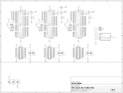

I have finished my schematics for my 6502 computer. Any do's and dont's, advice, ideas, and/or critiques are welcome.
PS: I realize I forgot to put the 40x4 LCD. But then, since I have a VDP, it might not really be necessary.

File comment: 3x AY-3-8910 (Left, center, right)

PostPosted: Sat Dec 18, 2021 3:51 am
Posts: 8462
Please don't take this as condemning; but I think more people would be willing to take the time to check the details if you draw an actual schematic, instead of just a netlist written around boxes. When the connections just have tags, we have to look everywhere for the matching tag. (A few like address and data lines are understood; but many more are not.) We see this all the time on the forum. [Edit, 12/22/21: I added some tips on how to get forum help, in the second half of the 6502 primer's page about general steps for a successful project, at http://wilsonminesco.com/6502primer/steps.html, after the heading "Getting help on the 6502.org forum:"] I can't take the time now to look at the details; but one easy thing I see that can reduce the risk of damage from plugging something in backwards is that on your VIA port connectors, you flip power and ground on one row, so for example on J15, pins 1 & 24 will be +5V, and 2 & 23 will be ground, or vice-versa.
I'd be glad to help. But, honestly, I find it too laborious reading a schematic like this. Maybe that's a valid critique and maybe it isn't; I'm only speaking for myself.
Oh -- and for BigEd, too, who recently opined, "But the kinds of schematics which just show a field of isolated components with all the connections as stubs isn't, to my eyes, as good as one which follows a logical block diagram."
Yes the information is all there. And some questions are easy to answer, like, "regarding IC pin blah-blah, what signal does that connect to?" But not so much when you turn the question around and want to know, "regarding signal so-and-so, what IC pins does that that connect to?" :evil:

... take the time to check the details if you draw an actual schematic, instead of just a netlist written around boxes. When the connections just have tags, we have to look everywhere for the matching tag.
Valid point. I'll be careful in my designs next time.
... but one easy thing I see that can reduce the risk of damage from plugging something in backwards is that on your VIA port connectors, you flip power and ground on one row, so for example on J15, pins 1 & 24 will be +5V, and 2 & 23 will be ground, or vice-versa.
Oh! Yes, I see the error of my ways on this. Thanks.
I also try to arrange things so a circuit path whose ends are on different sheets have their netlist tags at the left or right margin of the sheet, depending on where the other end is, such as in the following:
Thank you for the example. I shall use it as inspiration when I redraw mine.
