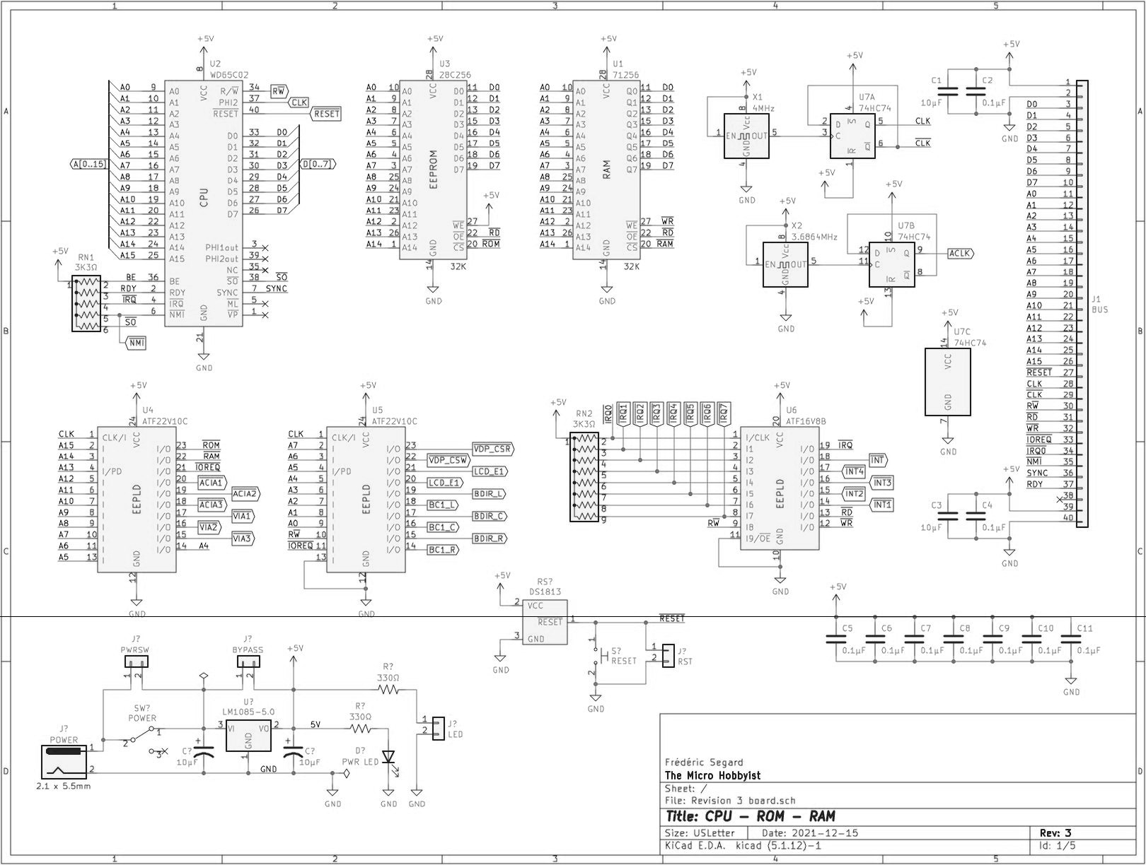

Hi 6502ers,
I'm going back to the drawing board with a rev 3 of my 6502 SBC. Rev 1, a larger board with expansion slots, only contained the CPU, ROM, RAM, and an ACIA; it also was designed to be breadboard friendly. I used it extensively for prototyping. Rev 2, on the other hand, was designed to be only 100mm x 100mm, contained all of the above plus an NVRAM. Rev 2 has daughter boards for peripherals such as VIAs and an MCU for mouse, keyboard, and NES controller, as well as a video card (TMS9918A), and a sound card (3x AY3-8910).
Having said that, Rev 2 is a pseudo flop. The main CPU board is flaky. There are several issues I have identified. Amongst them is the clock (if I leave my scope probe on the clock, my problems are 95% solved). I have posted my woes on the 6502 Facebook group. Many helped me out in identifying my issues. Oh, and one more thing about my woes! My crystals for the ATMEGA328P (Keyboard and mouse controller) and the TMS9918A (VDP) won't oscillate (I have changed my capacitors for different values, just in case). Though I did notice my voltage was at 4.89V (caused by a cheap slide switch, acting as a power switch). All in all, it's time for a redesign. I shall re-read Garth's Primer for sure. And if you have links to design ideas, feel free to post them my way.
- I shall have one big board (instead of expansion or daughter boards)... well probably one mezzanine board if all of the above won't fit.
- WD6502 running at 2MHz (4MHz through a 7474 FF to have a clean strong clock) (some of my components won't support higher speeds)
- 32K ROM, 32K RAM
- Still debating between staying with Atmel ATF22V10 for glue logic, or going all-in with conventional jellybean logic. And which family would serve me better? I have a few F ones (very fast)
- I'll have an MCU to interface the PS/2 keyboard and mouse (as well as an NES controller)
- 4 Rockwell ACIAs: one DTE, one DCE, one for HMI display, and one for future expansion
- 4 VIAs: One for MCU interfacing, one for SPI-10 ports, and 2 others for future expansion
- 1 TMS9919A or TMS9928A (I have both in multiple copies)
- 2 or 3 AY3-8910 (Stereo, or Stereo+center) (I have multiple copies, so I'm tempted to put more
- I'll have to find a RTC
- Still debating to put an LCD since I'll have terminal access, and a VDP
Sounds ambitious, but all of the above (except the RTC) worked on a breadboard prior to the failed Rev 2 experiment.
Do you have any suggestions, ideas, changes, critiques?

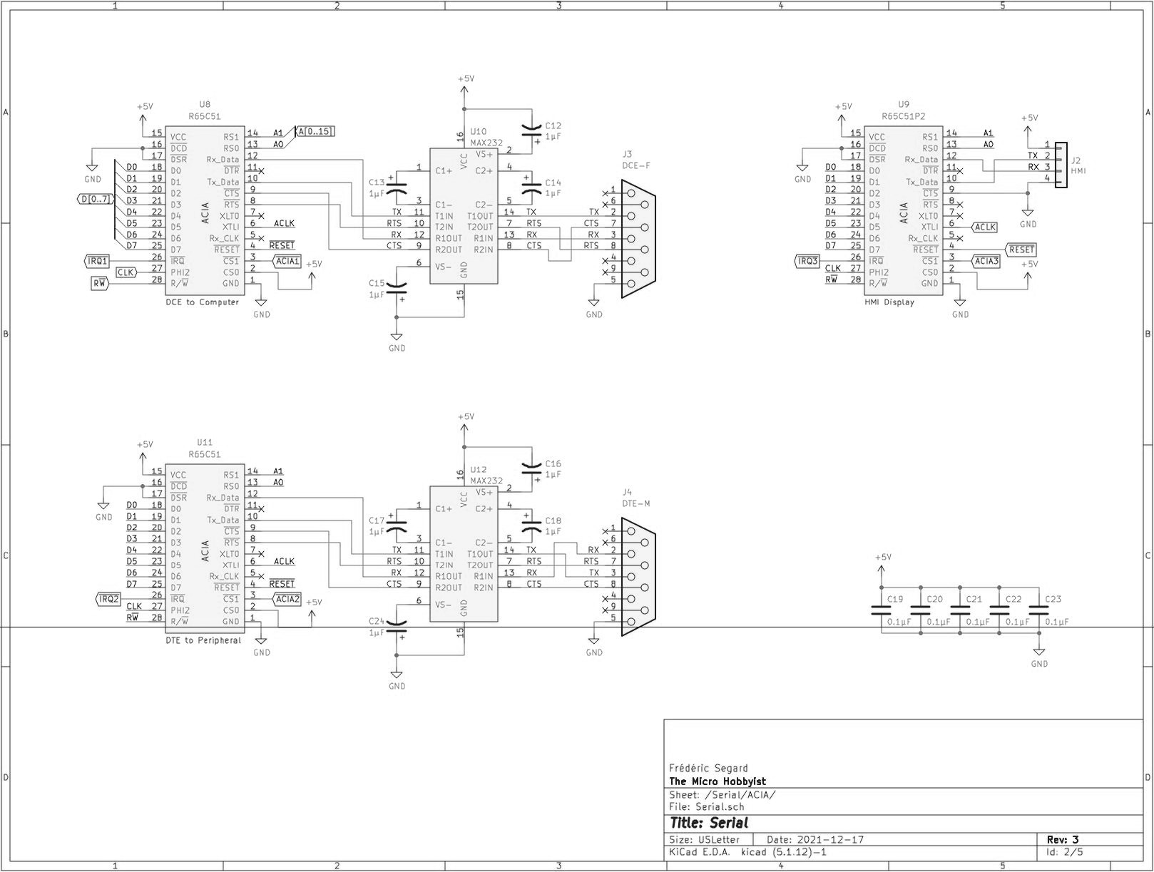

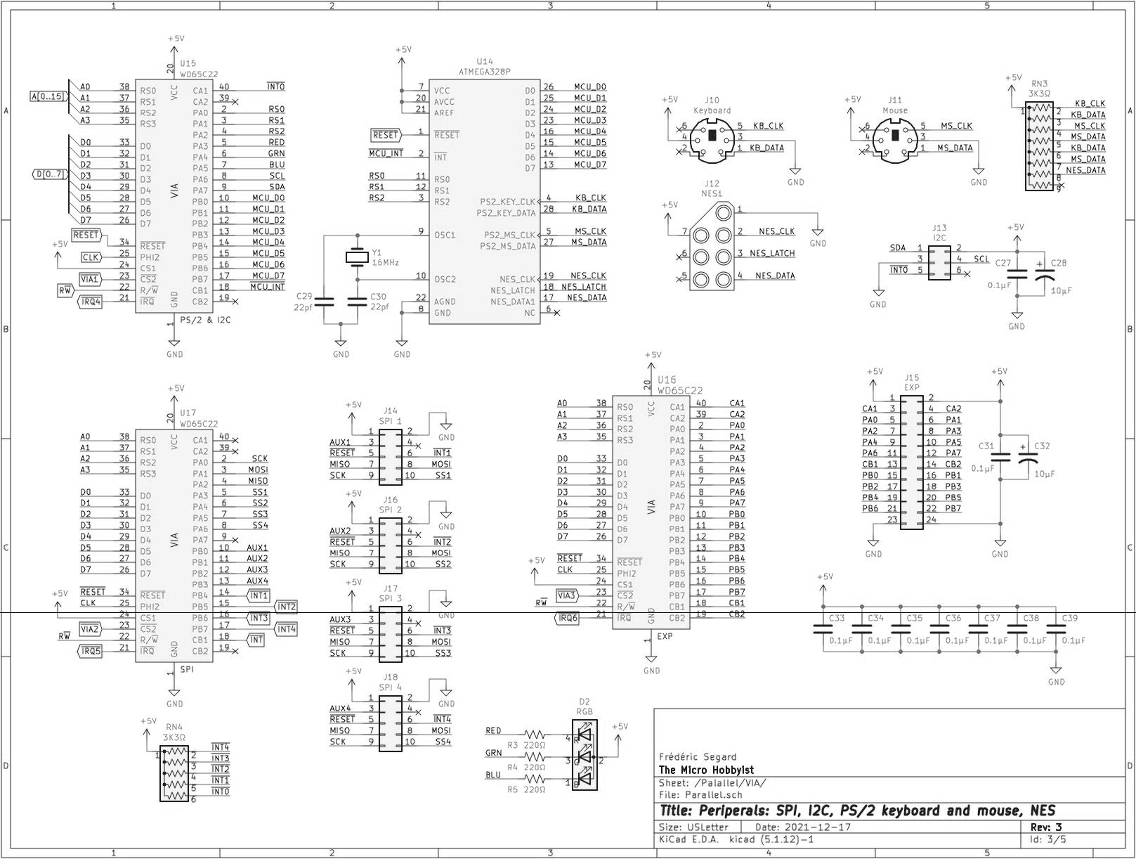

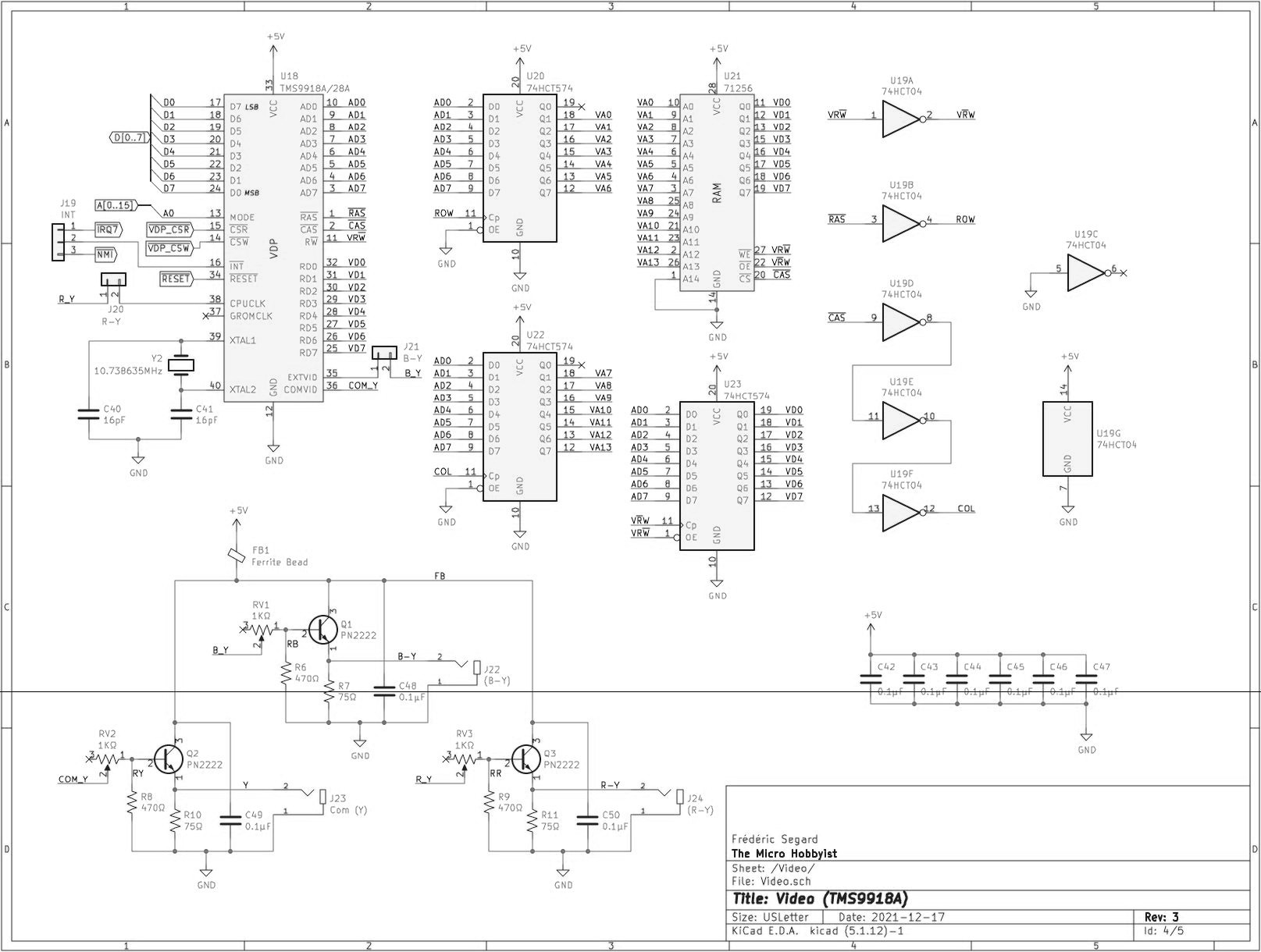

I have finished my schematics for my 6502 computer. Any do's and dont's, advice, ideas, and/or critiques are welcome.
PS: I realize I forgot to put the 40x4 LCD. But then, since I have a VDP, it might not really be necessary.
CPU, ROM, RAM, decode
3x ACIA (DTE, DCE, HMI)
3x VIA (I2C, SPI, PS/2 keyboard, PS/s mouse, NES controller)
TMS9918A/28 VDP
TMS9918A/28 VDP

Please don't take this as condemning; but I think more people would be willing to take the time to check the details if you draw an actual schematic, instead of just a netlist written around boxes. When the connections just have tags, we have to look everywhere for the matching tag. (A few like address and data lines are understood; but many more are not.) We see this all the time on the forum. [Edit, 12/22/21: I added some tips on how to get forum help, in the second half of the 6502 primer's page about general steps for a successful project, at http://wilsonminesco.com/6502primer/steps.html, after the heading "Getting help on the 6502.org forum:"] I can't take the time now to look at the details; but one easy thing I see that can reduce the risk of damage from plugging something in backwards is that on your VIA port connectors, you flip power and ground on one row, so for example on J15, pins 1 & 24 will be +5V, and 2 & 23 will be ground, or vice-versa.
Posts: 3525
Re: Rev3 design considerations and ideas
I'd be glad to help. But, honestly, I find it too laborious reading a schematic like this. Maybe that's a valid critique and maybe it isn't; I'm only speaking for myself.
Oh -- and for BigEd, too, who recently opined, "But the kinds of schematics which just show a field of isolated components with all the connections as stubs isn't, to my eyes, as good as one which follows a logical block diagram."
Yes the information is all there. And some questions are easy to answer, like, "regarding IC pin blah-blah, what signal does that connect to?" But not so much when you turn the question around and want to know, "regarding signal so-and-so, what IC pins does that that connect to?" :evil:
(Oops, I see Garth has posted while I was typing. Like him, I hope you don't take this as condemning.)

... take the time to check the details if you draw an actual schematic, instead of just a netlist written around boxes. When the connections just have tags, we have to look everywhere for the matching tag.
Valid point. I'll be careful in my designs next time.
... but one easy thing I see that can reduce the risk of damage from plugging something in backwards is that on your VIA port connectors, you flip power and ground on one row, so for example on J15, pins 1 & 24 will be +5V, and 2 & 23 will be ground, or vice-versa.
Oh! Yes, I see the error of my ways on this. Thanks.
