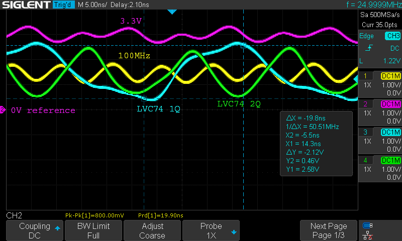

Speaking of speed being the problem... or at least the sudden change. I was curious what would happen if I wired a '74 D-type edge triggered flip flop into a 100Mhz clock.
The result was pretty bad.
Basically I have 100Mhz clock oscillator connected to an unbuffered inverter and from there into a D-type flip flop all on soldered strip-board.
So my question is: What have I done (or not done?) What is going on?

The 2200uF cap was me trying to work out how to get signal off my 3.3V line. It doesn't seem to have any significant effect on anything.
Seriously, what is going on in here? The yellow 100MHz clock signal is very small (about 1V peak-to-peak) but the data sheet for the LVCMOS oscillator indicates it should be 10% VDD (3.3V) to 90% VDD. This could well be my oscilloscope probes, they're rated at 200MHz but I've seen reviews saying they're rubbish.
The purple 3.3V line is wobbling by about half the height of the clock signal? And so is ground which makes it really hard to tell what the 'scope is truly using for reference.
The green 50Mhz signal is at least going above 2.4V and below 0.4V but I'd expected that it would have been "square'er" as it's driven by Schmitt triggered inverted, three of them. Although their datasheet says worst case propagation time is 4ns and as the clock rise / fall time is 5ns. It's wired as a clock divider with /Q into D.
The cyan 25MHz signal is the 50MHz signal wired into the unused side of the flip flop.

PostPosted: Thu Dec 23, 2021 12:55 pm
AndrewP wrote:
Are my oscilloscope probes junk? (They're the default Siglent 200Mhz jobbies)
What about the 'scope itself -- what is its bandwidth?
Whether it's the scope or the probes or both, there's pretty clearly something limiting bandwidth. Notice how the signal that appears to have the lowest amplitude is the signal that's the highest frequency? And the lowest frequency signal appears to have the highest amplitude?
And BTW let me remind you that a scope rated for, say, 100 MHz, will do an alright job of displaying a 100 MHz sine wave but it will disappoint you if you hope to view a 100 MHz square wave. The square wave will appear to be almost a sine wave. That's because a square wave is actually a mixture of frequencies including the fundamental frequency plus a series of harmonics -- fundamental times 2, times 3, times 4 etc. Obviously the harmonics are beyond the scope's ability to properly display.

PostPosted: Thu Dec 23, 2021 1:20 pm
Posts: 10949
(That's fundamental times 3, I think, for a square wave, which is even worse.)
One thing that might be worth trying is to feed this clock-like signal into a divider. Then you can be trying to measure a 25MHz or 5MHz clock, which you can do with much more confidence.
But bear in mind, even 30MHz is on the high side for ad-hoc construction techniques. 100MHz is very hopeful.

I believe the circuit is working. Even though the instruments don't show the waves as being square, it's possible to make out the 2:1 and 4:1 frequency ratios.
Still, it'd be less confusing if lower frequencies were chosen -- within the range that can be properly displayed.

AndrewP wrote:
Speaking of speed being the problem... or at least the sudden change. I was curious what would happen if I wired a '74 D-type edge triggered flip flop into a 100Mhz clock...This could well be my oscilloscope probes, they're rated at 200MHz but I've seen reviews saying they're rubbish.
Are your probes “compensated?” At the frequencies you are exploring, non-compensated ones are likely distorting the daylights out of what should be a square-wave signal. A compensated probe will have an adjustment to “tune” the probe to the scope's input for most accurate signal rendition.
Square waves consist of the fundamental and a series of odd-order harmonics. A theoretically-pure square wave contains no even-order harmonics, and the harmonic progression goes out to infinity. Practical devices cannot achieve that but in the case of fast logic, can produce a harmonic progression that is at least 20× the fundamental.
Realistically, your instruments need to have at least 10× the bandwidth of the square wave's fundamental in order properly display a reasonable facsimile of a square wave. A 200 MHz scope is not going to cut it at 100 MHz, no matter how good the probes. Even at 50 MHz, you are not going to see a square wave. The rise and fall will be of a discernible width and the corners will be grossly rounded.
Something else that influences faithful reproduction of signal conditions is where the probe's ground is attached. I generally attach it as close as possible to the source of the signal in an effort to minimize reactive effects.

Yeah, I was talking to my cousin who is way more professional at the hardware stuff than me and he also came up with two major points. The first was that I probably need to put this on a PCB because there may be a problem with the soldering somewhere (amongst other problems with living on stripboard). I've gone over it with a magnifying glass (well my phone's camera) and, yeah... maybe it's good maybe it's not.
The second thing he mentioned is that my 200MHz scope running at 500MS/s is not going to be reading a square signal at 100MHz, and that it might be reading a much smaller voltage than truth. But putting this signal through a divider makes me believe there is something wrong. The green signal is ÷ 2 and the cyan signal is ÷ 4 and a 25MHz signal should be well within readability.
As this is all for curiosity's sake I'm going to two more clock oscillators, 5MHz and 25MHz as I have them knocking around.
...I generally attach it as close as possible to the source of the signal in an effort to minimize reactive effects.
Thanks, I hadn't realised that. That wire at the back of the board that just connects ground to ground is what I was using to connect the probe's ground to. I'll retry with like that after I've checked the probe compensation you mentioned.
