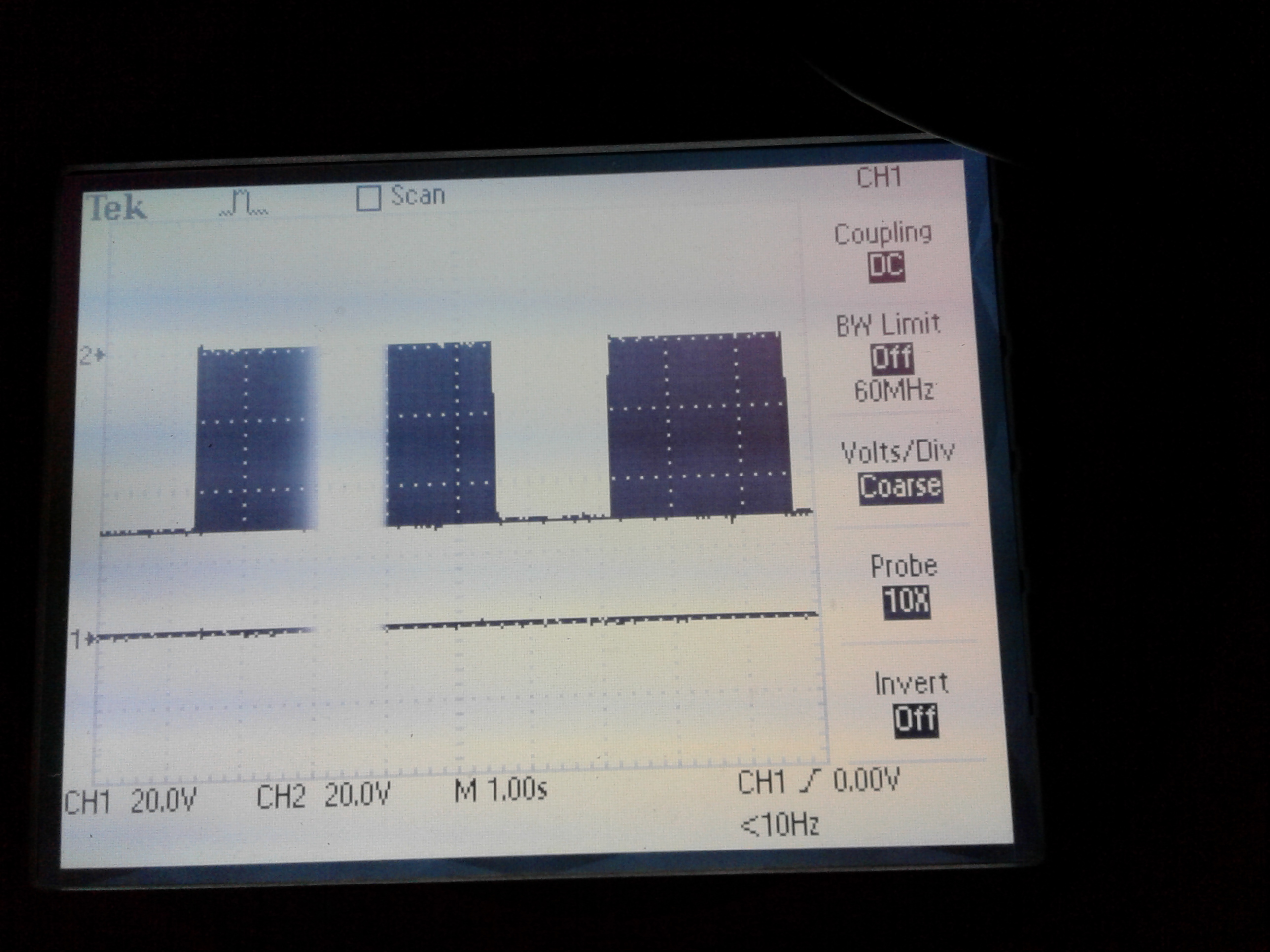

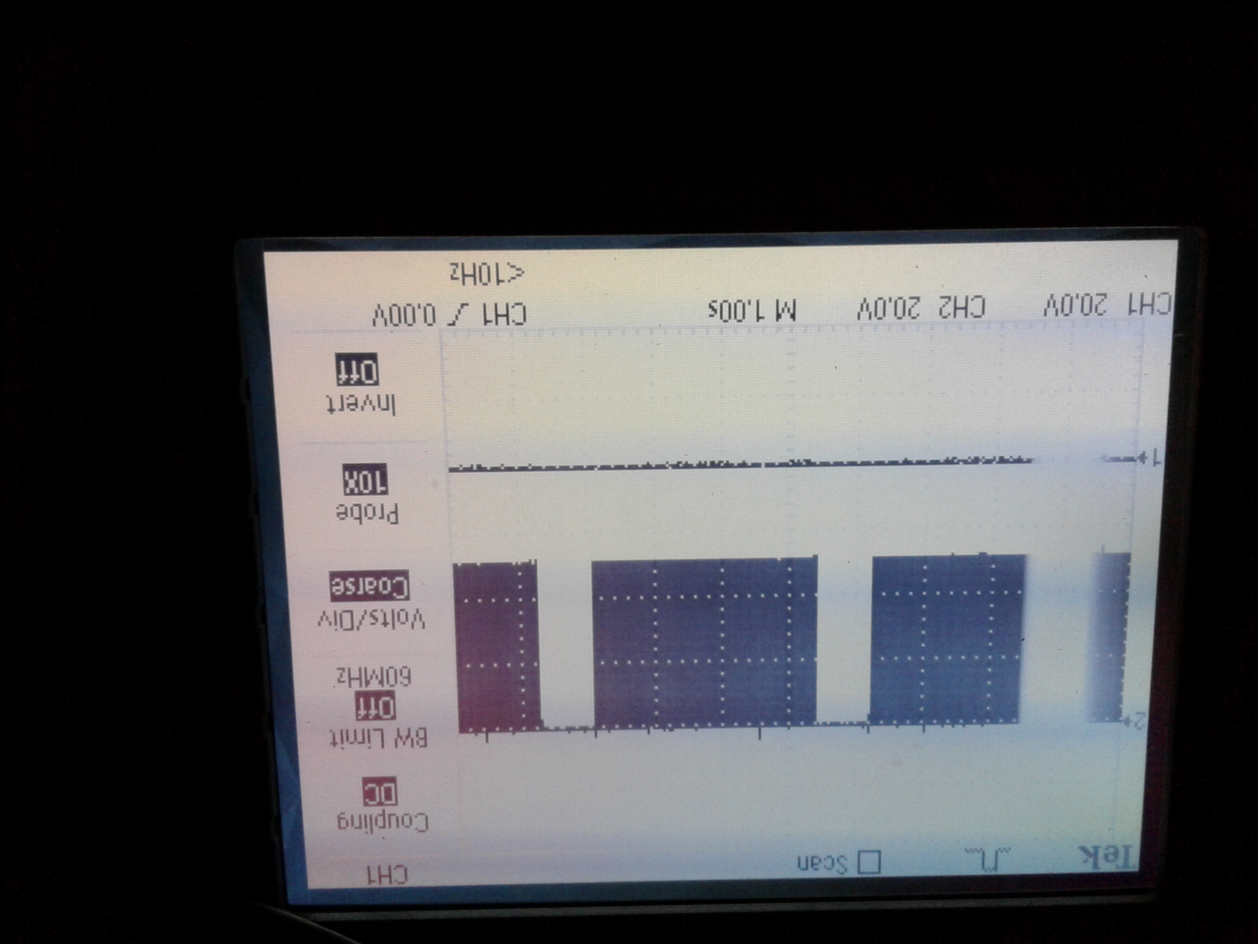

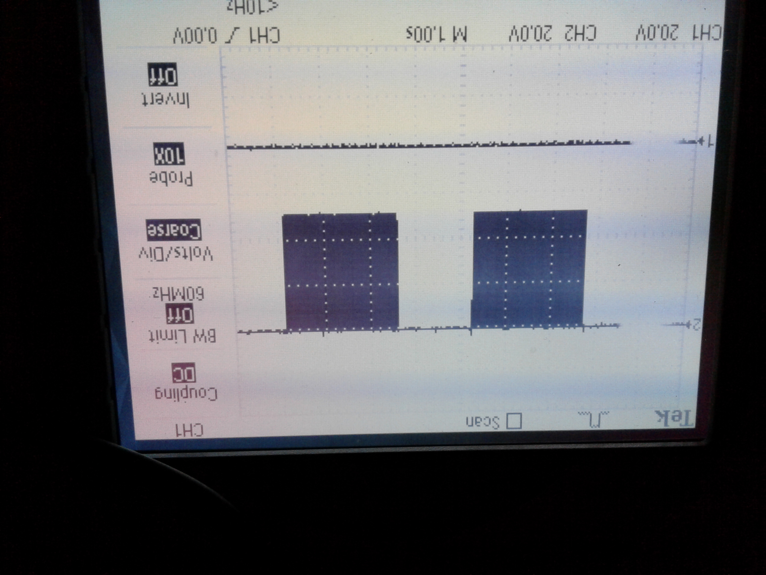

Attached are some pictures of what my scope is telling me. When I try to connect the other channel to the clock (for comparisons), this channel goes dead. Sadly, I don't know enough about scopes as to why that is happening.
This is a pretty good representation of what I'm seeing on address and data lines. Last night I even saw it "both", then "high", then "low", then back to "both".
Again, this is happening... sometimes. When it does work, everything hums right along and the data and address lines that alternate look like the clock.
My clock has what looks like an overshoot, like a mini-spike past 5V when going up, and below 0V when going down. When I test Phi2Out or something, the clock signal is cleaned up a lot. Not sure if that has any effects on it.
I'll be pondering on this. Thank you all for the advice. I'm listening.

PostPosted: Tue Nov 09, 2021 1:31 pm
I don't see any real 'scope probes. Are they included, just not in the picture? Just clips to the coax will not be suitable. There's a lot that goes into oscilloscope probes which is not obvious, including even special cable (not normal coax), which is why they're expensive. Even for a 20MHz 'scope, they start at about $40 a pair. What I see in the picture will give extreme capacitive loading to fast digital lines and probably make your creation crash, and the 'scope won't be any good past about 2MHz anyway with them, which means a digital signal of about 200kHz or less. The probes must have a x10 switch setting.
What Garth' s saying is, the stuff shown in the picture ( with your post here ) isn't appropriate.
sburrow wrote:
I did turn the thing on, and I found that x10 setting you were talking about.
I have alligator clips and the little "prong" things. I just did a look on the internet for "oscilloscope probes" and I don't know if this qualifies as that?
The x10 setting on the scope itself is supposed to be set to match the actual probes you're using. Altering the setting doesn't alter the actual probes, unfortunately.
For the reasons Garth mentioned, your observations using the scope will be badly handicapped until you get proper probes. If you can't get proper probes, maybe you should be placing less reliance on the scope anyway, given that your scope skills are underdeveloped at this point. There are other useful approaches you can be taking.
(One thing you probably can 'scope successfully, even without proper probes, is the 5 VDC power supply. As you attach the connection, the trace should move from a straight line at zero to a straight line at 5V.)

PostPosted: Tue Nov 09, 2021 4:11 pm
Posts: 8509
I've come to be AFRAID of W65C02. It is so fast that it needs to be tamed with good ground, good power supply (0.1uF bypass and 10uF filter), and operate at lower voltage (It'll work at 3V so don't be afraid of lower your global supply).
What Bill is saying is the outputs of the W65C02 switch extremely fast, which can generate very high frequency noise that will find its way back into the VCC and ground paths, creating possibly-undefined circuit conditions. Meticulous construction, along with proper bypassing, is essential to achieving reliability. Note that this sort of problem is not directly related to the Ø2 clock rate—ground bounce and VCC sag can occur at 1 MHz.
Lowering the system voltage may help, but that is a band-aid fix for a more fundamental problem. Lots of homebrew machines successfully run at 5 volts...and at high clock rates.

sburrow wrote:
Attached are some pictures of what my scope is telling me. d
Am I seeing that correctly? Do you have the sweep time set to 1 second and the trigger voltage set to 0V?
You might wan to set the sweep to something like 10x the clock period (say 10us for a 1MHz clock) to begin with then change as required to see what you need to see, and the trigger voltage to between 1V and 4V.
That's a great question. So when I hook my clock up to it, I get about 8 squarewave pulses on that screen. I'm currently running it at 250kHZ.
Now, is the scope changing it's setting automatically on me, and I just don't recognize it? Maybe! A "smart" version I guess.
