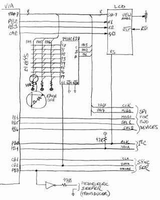

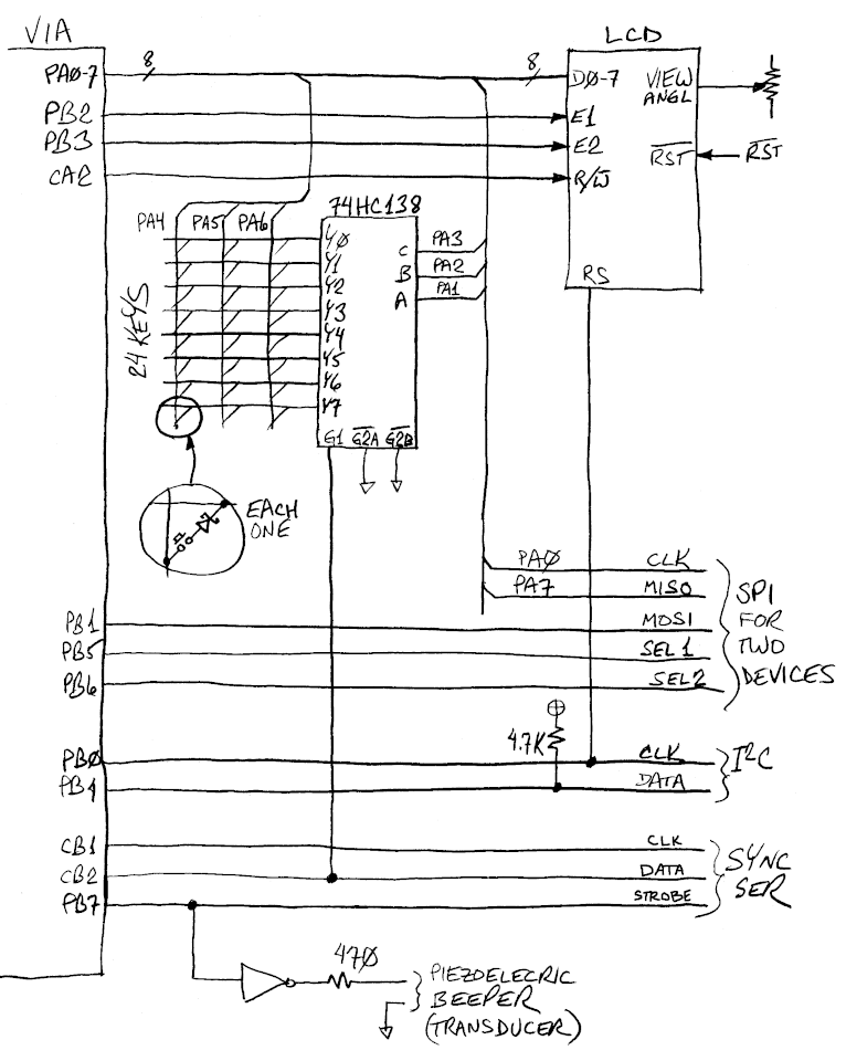

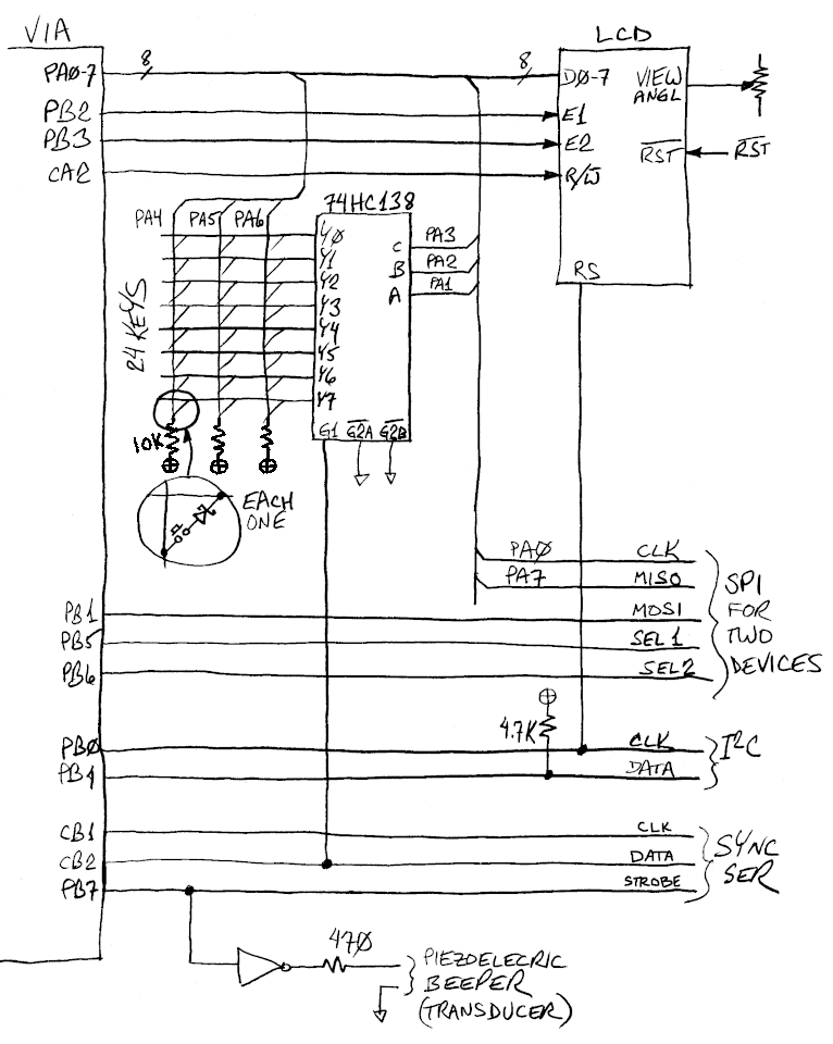

Here's one idea for connecting the things you want to a single VIA, with a little bit to spare:
There are 24 keys, electrically arranged as 8 rows by 3 columns. The 8 rows are fed by the '138. There's a Schottky diode in series with each keyswitch so there's never any contention. I forgot to draw in the pull-up resistors on the 3 columns. If you want more switches, one possibility is to make one of the keys a shift key, to double up on functions of the other ones. Keys will have to be debounced in software of course, and a shift key would never get auto-repeat, and maybe only cursor keys would get auto-repeat.
There are select lines for two SPI devices. If you want to put half a 74HC139 section in there, you could make it three (with the fourth combination meaning "deselect everything." You can't operate the SPI port at the same time you're scanning the keypad or feeding the LCD, but I doubt that will be any problem. There's probably a way to further multiplex things to get a printer port on the same VIA. What's another VIA though. I have three on my workbench computer; and if ever get around to building my next one, it'll have four.
The LCD's register-select input is on the same line with the I²C clock; but it should not be a problem as long as you don't try to feed the LCD while something is still selected on I²C. The I²C start condition is made when you take the data line down while the clock line is high. As long as you keep these things in mind, everything should play happily. The VIA's various registers let you do what you need.
The VIA's own hardware synchronous serial port, or "SR" for "shift register," is useful for interfacing to chains of I/O bits on ICs like 74HC595's, 74HC165's, 4094's, and 4021's. CB2, the data line, also enables the '138 when you want to scan the keypad. It should seldom if ever be a problem that you can't keep the SR port going while scanning the keypad. The beeper is one of those .015"-thick ones like you find in greeting cards. It's like a tiny brass speaker, using AC to drive it, not DC, so PB7, outputting a square wave, either under software control or toggling PB7 each time T1 in free-run mode times out, determines the beep frequency. I put the inverter and 470Ω resistor in there as a buffer, so the piezoelectric element's capacitive load doesn't cause problems.
I use T1 (timer/counter 1) in free-run mode on the same VIA to produce interrupts for my real-time clock for time of day, calendar, alarms, and timing various short intervals, and feed the beeper in software instead of from T1.
Hopefully I didn't overlook anything.

Thank you Garth, that is amazing. Simply amazing. And, just to be 100% sure, I'm attaching my addition of the pull-up resistors for the columns. Are they correct? It's attached at the bottom I believe.
So you are correct about that LCD. Apparently the one I grabbed is not like others! Some have two column/controller selects, some have none at all, but ALL of them have an enable. Can I ask why it's important to not simply ground R/~W? I have seen many configurations where folks ignore the reading of the LCD because it's mostly insignificant. Assuming I will have the 2 separate selects AND an enable, could I just replace the R/~W line with Enable in this layout? Attaching the ~RST to the 6502 was a great idea!
This is what I was using as my basis of understanding the 2 select lines:
https://www.engineersgarage.com/128x64-graphical-lcd/
Cool to have 2x SPI interfaces. Makes sense too! I'm definitely going to use something like this on one of them:
https://lastminuteengineers.com/arduino ... -tutorial/
I actually already bought some of these, and will be testing on my Rapsberry Pi soon. An excellent tutorial I found is here:
http://elm-chan.org/docs/mmc/mmc_e.html
I don't know exactly what I'd use an I2C interface for, but I have seen those around while I've been searching. If it fits, sounds like a good idea.
For the "Sync Serial" 6522 SR lines, I am lost as to what I'd use them for, as far as I am going. Again though, with the I2C, if it fits and doesn't use other chips, that's not a bad idea.
The beeper is a SUPER cool idea. And looks easy to implement. Thank you for that Garth.
