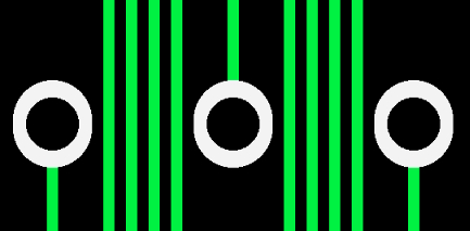

Definitely. I use .030" holes for DIP pins, with .050" pads, leaving .050" of space between them. With .007" traces and spaces, you can run three traces between pads.
Going down to .006"/.006", which all board manufacturers can go down to before they start to charge extra, and narrowing the pads to .046" on the sides (where traces don't come into the pad), you can actually fit four traces between, like this:
When they drill the holes, they have to start slightly bigger than you specify, and then the plating inside the hole brings the diameter down to what you specified. Further, although the machinery is impressively accurate, it's not perfect, and the hole may not be perfectly centered. Yet further, there's usually a ±.002" or ±.003" tolerance on the drill size, which I assume comes partly from the bit making a slightly larger, more-ragged hole as it wears. For these reasons, I like to have the width of the ring around the hole to be no less than .010" (per side), particularly where a trace meets it, as having the trace just fall down into the hole, without meeting a pad, makes for a less reliable connection.
Again, .006"/.006" is no problem for any of the board manufacturers. A few have been able to go down to .002"/.002" even three decades ago! How they can make a trace that's hardly any wider than it is thick, and have a rectangular cross section, is beyond me! But if you want to pay, they can do it.

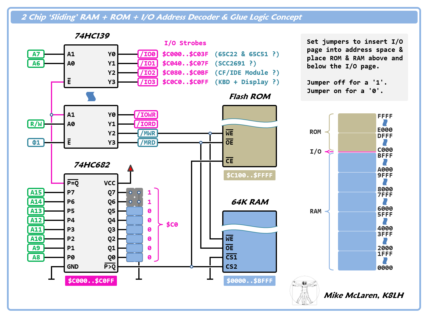

I also wanted to post an updated 74HC682 decoder concept drawing (below). I discovered that the '682 has internal pull-ups on the Q inputs so I had to revise my jumper scheme. Note that while the '682 is rather expensive compared to the '688, I received a handful from China for about $1.29 each (including shipping). If it works, I think the 2-chip 74HC682 decoder method might be a simple, clever, and elegant decoder solution for entry-level 65C02 SBC designs.
Michael, I gotta ask: How did/do you find out about these internal pull-ups? I have a datasheet for the 74HC688 and see nothing about that on there. I mean, nothing explicitly saying "these pins have internal pull-ups". Do I have a bad datasheet? Is this a common thing for 74' IC's that I have just passed over? Is there some other wording they use that I'm not familiar with? Would me adding some pull-up's *damage* something if it does or does not already have pull-ups internally?
Thank you. Just a surprise to me. Always learning!
Chad
PostPosted: Mon Oct 25, 2021 3:44 pm
Posts: 588
Chad, the '688 doesn't have pull-ups on the Q inputs. On the other hand, the '682 datasheet does describe the internal pull-ups on its Q inputs. There's also a '684 which is the same as the '682 but without the internal pull-ups.

Chad, the '688 doesn't have pull-ups on the Q inputs. The '682 datasheet describes the internal pull-ups on its Q inputs. There's also a '684 which is the same as the '682 but without the pull-ups.
Sure enough, when I pull up the '682 datasheet, it's right on the front page! Ok, so if they say they have pull-up's then they have pull-up's. If they don't say anything, they don't have anything.
Easy enough, thank you Michael. I will consider this. Right now I'm only using a 74HC688 and a 74HC00, and I have one spare NAND gate left over. So, 2 chips vs 2 chips. But I'll go back over it just to look it over more closely. Thank you again!
