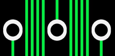

I often see some designs (even your own), that it is possible to run traces BETWEEN pins! That amazing to me, and of course super helpful if possible.
Definitely. I use .030" holes for DIP pins, with .050" pads, leaving .050" of space between them. With .007" traces and spaces, you can run three traces between pads.
Going down to .006"/.006", which all board manufacturers can go down to before they start to charge extra, and narrowing the pads to .046" on the sides (where traces don't come into the pad), you can actually fit four traces between, like this:
When they drill the holes, they have to start slightly bigger than you specify, and then the plating inside the hole brings the diameter down to what you specified. Further, although the machinery is impressively accurate, it's not perfect, and the hole may not be perfectly centered. Yet further, there's usually a ±.002" or ±.003" tolerance on the drill size, which I assume comes partly from the bit making a slightly larger, more-ragged hole as it wears. For these reasons, I like to have the width of the ring around the hole to be no less than .010" (per side), particularly where a trace meets it, as having the trace just fall down into the hole, without meeting a pad, makes for a less reliable connection.
Again, .006"/.006" is no problem for any of the board manufacturers. A few have been able to go down to .002"/.002" even three decades ago! How they can make a trace that's hardly any wider than it is thick, and have a rectangular cross section, is beyond me! But if you want to pay, they can do it.
Keep in mind that vias take room also. When I worked at TEAC in 1982-83, there were a lot of boards that were single-sided and had a ton of jumpers. Today I think it would be more economical (and reliable, due to the plate-thrus) to add at least one layer and save the jumpers, and even make the board a lot smaller.
