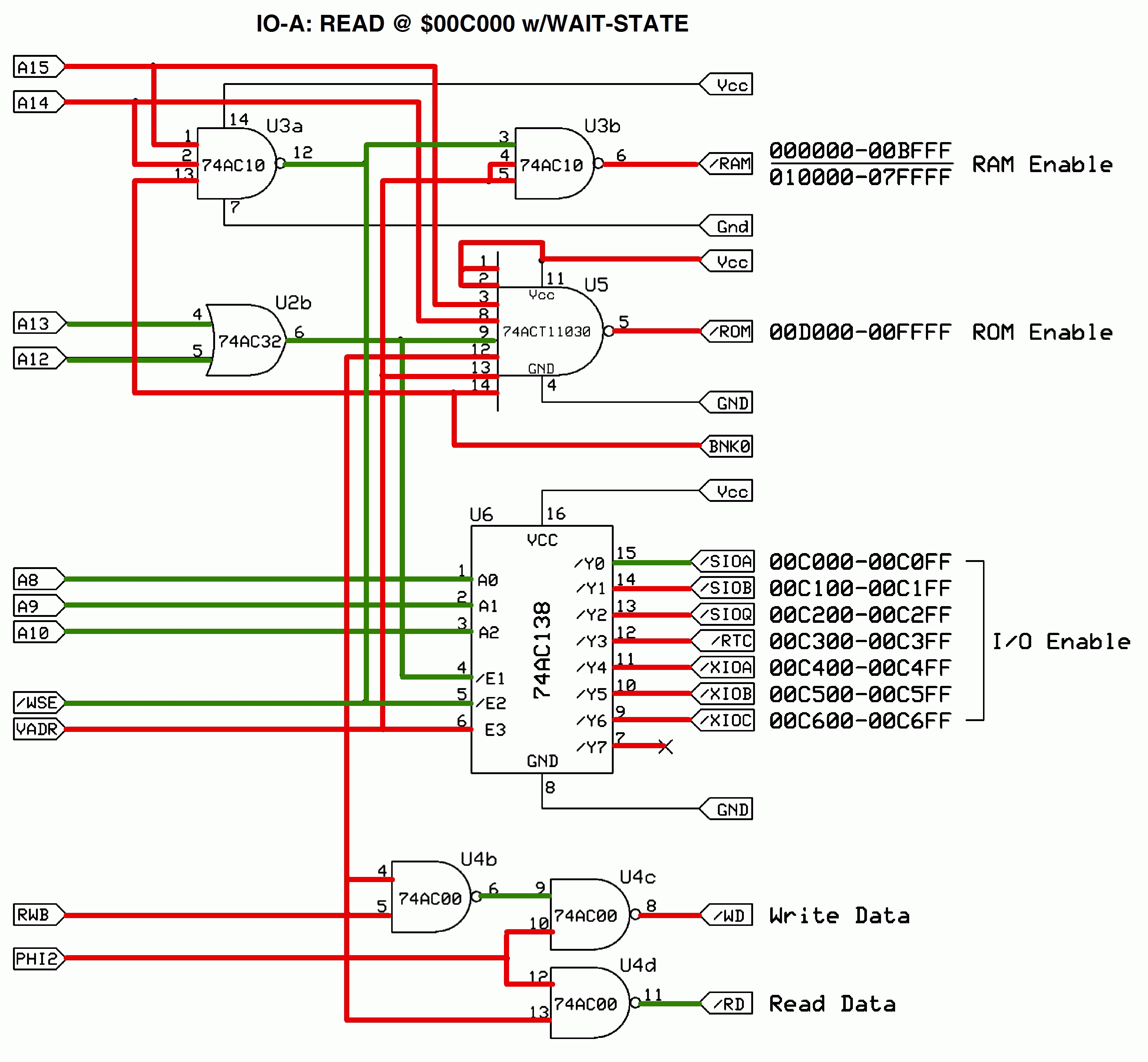

I see everyone is offering suggestions on what test gear you might need to debug your hardware when you get it built. I might as well add to the confusion.
I'll start by stating the obvious. Computer circuits are fundamentally very simple in operation. Things are either on or off, yes or no, 1 or 0, etc. This binary simplicity means there are two types of faults that usually pop up in new designs: logic errors and timing violations (very rarely, a defective part will cause trouble). The former are actually fairly easy to diagnose, even with basic test gear; the latter, not so much. Fortunately, at low clock speeds, logic errors are far more likely to give you grief than timing violations. As has often been noted around here, you can get away with murder at 1 MHz. :D
When I say "logic errors," I group into that category errors due to improper circuit design and errors caused by improper circuit construction. The best way to debug the former is to do logic proofs on your design. These are nothing more than color-coded markups of copies of your schematic, such as the following:
File comment: Example Logic Proof
The above is the glue logic for my POC V1.3 unit. Red lines are parts of the circuit that should be at logic 1 (~5 volts) for the address $00C000 and the green lines are signals that should be at logic 0. Incidentally, note that I drew AND, OR, etc., gates as traditional logic symbols, not black boxes with connections—the latter tell you nothing about the circuit's logic progression. I reserve the black box notation for devices with complex functions, such as the 74AC138 decoder.
Using a technique such as the above and assuming you understand how the components of your design function, you will be able to see exactly how your circuit should behave with any given address on the bus. Hence if there is a logic error in the design you should be able to uncover it. If you do that for all the key address situations you expect in your system, e.g., RAM selection, ROM selection, etc., you will likely find all logic errors. I recommend you give it a try before wiring up your system and being disappointed when nothing good happens.
The other source of logic errors is mistakes in construction. These are much more likely in a wired unit than one built on a PCB, assuming the PCB layout is correct (there are ways to positively verify the layout against the original schematic). You avoid construction errors by being meticulous as you work and by developing a procedure that helps you keep track of which connections have to be made and where. You also double- and triple-check that you've inserted parts into the unit the right way. It's no fun having to open the windows to ventilate the room after the unit has belched out some smoke due to a backward chip, mis-inserted electrolytic capacitor, etc.
Despite best efforts, things won't always work as planned and some troubleshooting will be necessary. Troubleshooting a new design is not easy as troubleshooting one that was working and subsequently went kaput. Nevertheless, just about all of us here that have scratch-built systems have managed to get DOA new designs running (my very first POC unit was DOA due to a missing trace on the PCB). It's a matter of understanding how it should work—the above logic proof technique can help—and using a systematic troubleshooting method that includes first checking the obvious things.
