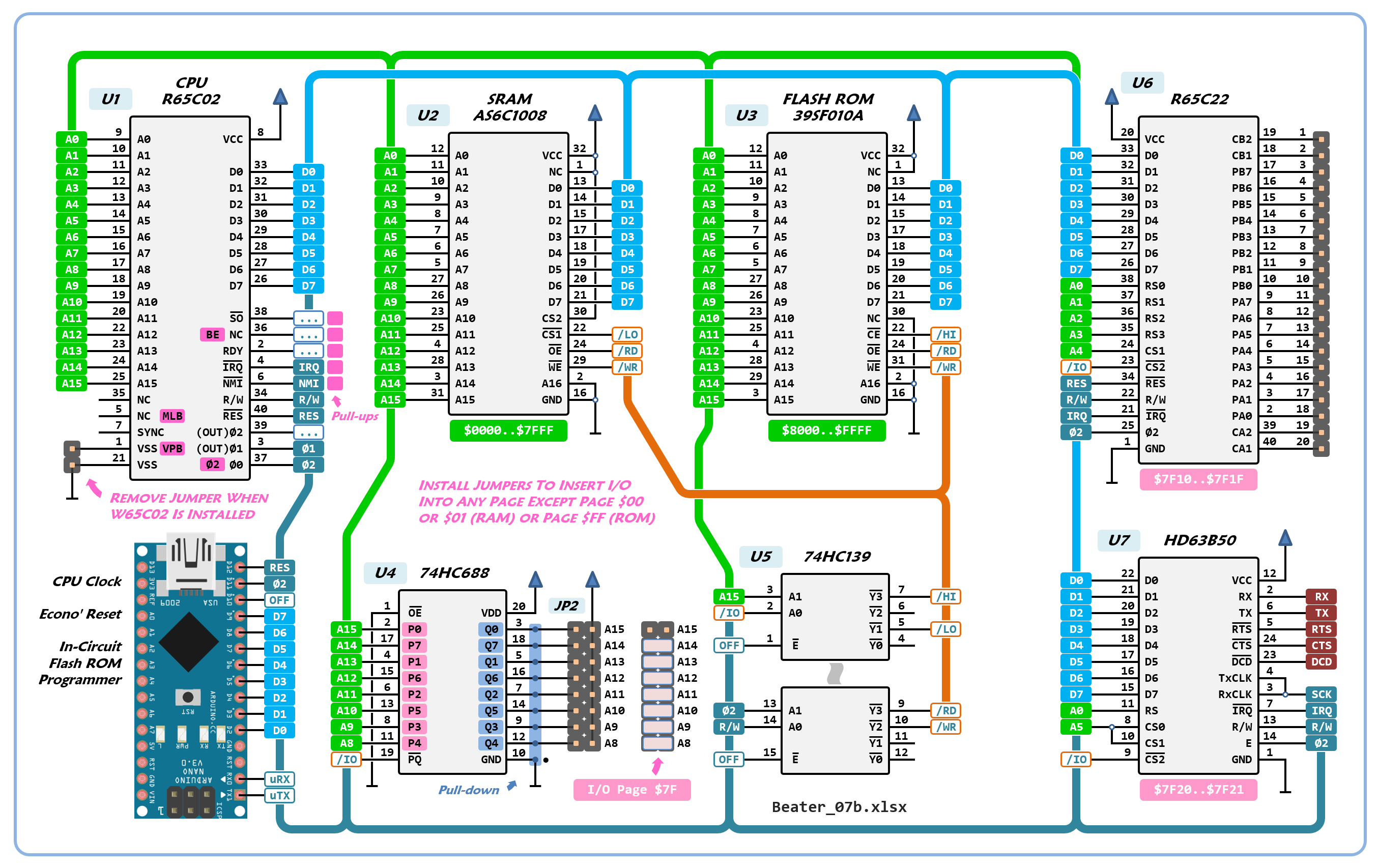

sburrow wrote:
Michael, I am *sure* that's my ROM select arrangement. Surely that's what I was thinking in my mind at least.
I believe you have an unnecessary gate in front of the ROM select gate which is inverting the P=Q signal to the ROM select gate. The way you have it the IO and ROM would be enabled at $8000..$80FF and nothing would be enabled in the $8100..$FFFF address space.
It's easier for me to study the logic if you depict the 74HC00 gates instead of the package. Updated drawing below...
Good luck. Have fun.

Michael, I think you are right. I'm thinking it through now, and I do believe you are correct.
Thank you for that, I appreciate your patience with me. And yes, logic not package next time.

If I may... I'm not sure if it would be an advantage or not but adding a jumper block and pull-downs to the 74HC688 'Q' inputs would allow you to set or change the I/O page in the address space. In the example below a 74HC139 is used for the 'glue' logic, half of it being used to provide clock qualified /RD and /WR signals, the other half used to insert the I/O page into RAM or ROM space. Basically just another two chip decoder + glue logic solution for 32K RAM and 32K ROM but with jumper configurable I/O page address.

Mike, that is a great layout. And you didn't even use a 74'00?! Amazing. I will study this in depth going forward. I really appreciate it.
