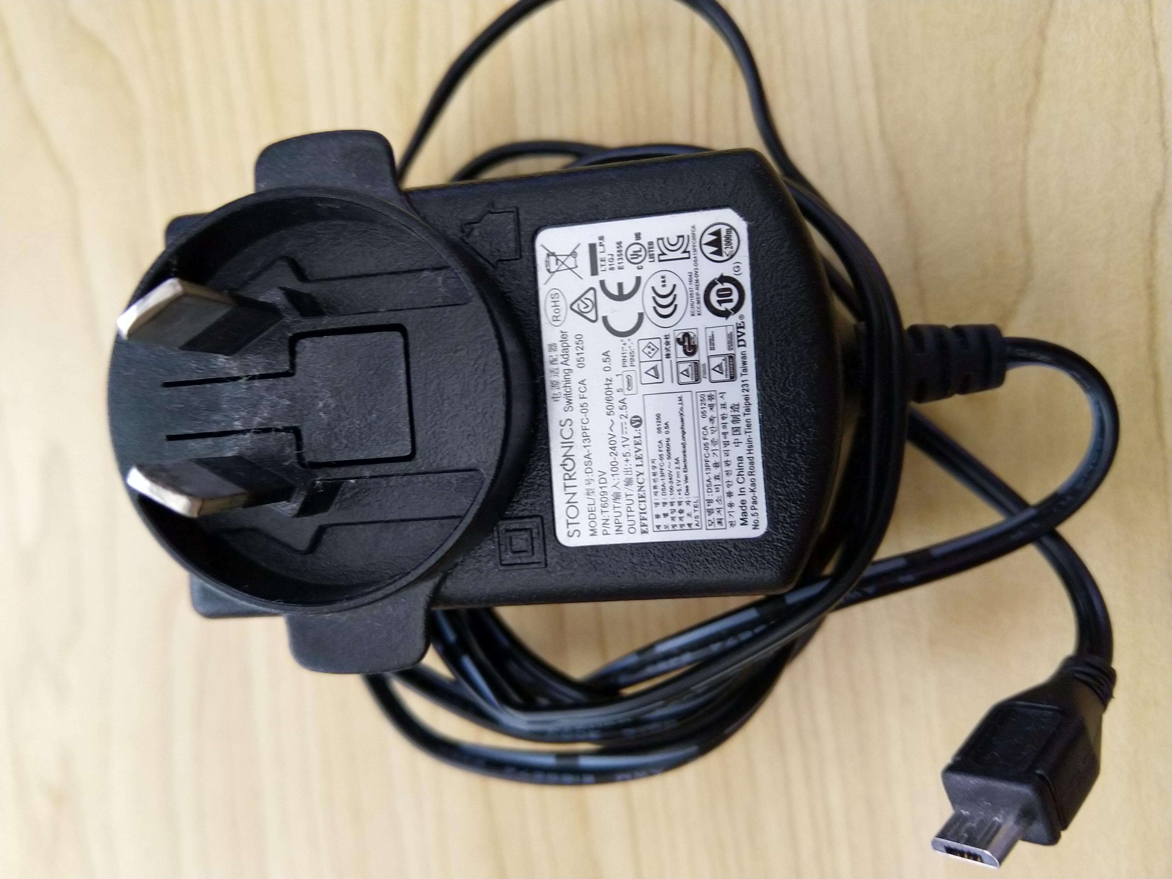

Just out of curiosity, what is a 'raspberry pi 5.1V power supply'? I noticed at the raspi website a mention that one is required, but every device I've seen is powered by a usual 5V USB wallwart. I have a box of ones that claimed 2+ amps but were not providing that (as USB spec requires 500mA and the connectors are wimpy), and l 've never seen a 5.1v supply .
I would imagine, since you are doing your own regulation, that you would want to start with a higher initial voltage, or a tiny ripple will bring you below 5v. Oh, I see it's for battery only...
l've seen many USB power supplies provide a lot less than 5v under load.

enso wrote:
Just out of curiosity, what is a 'raspberry pi 5.1V power supply'? I noticed at the raspi website a mention that one is required, but every device I've seen is powered by a usual 5V USB wallwart. I have a box of ones that claimed 2+ amps but were not providing that (as USB spec requires 500mA and the connectors are wimpy), and l 've never seen a 5.1v supply.
Attached is a pic of the power supply...
