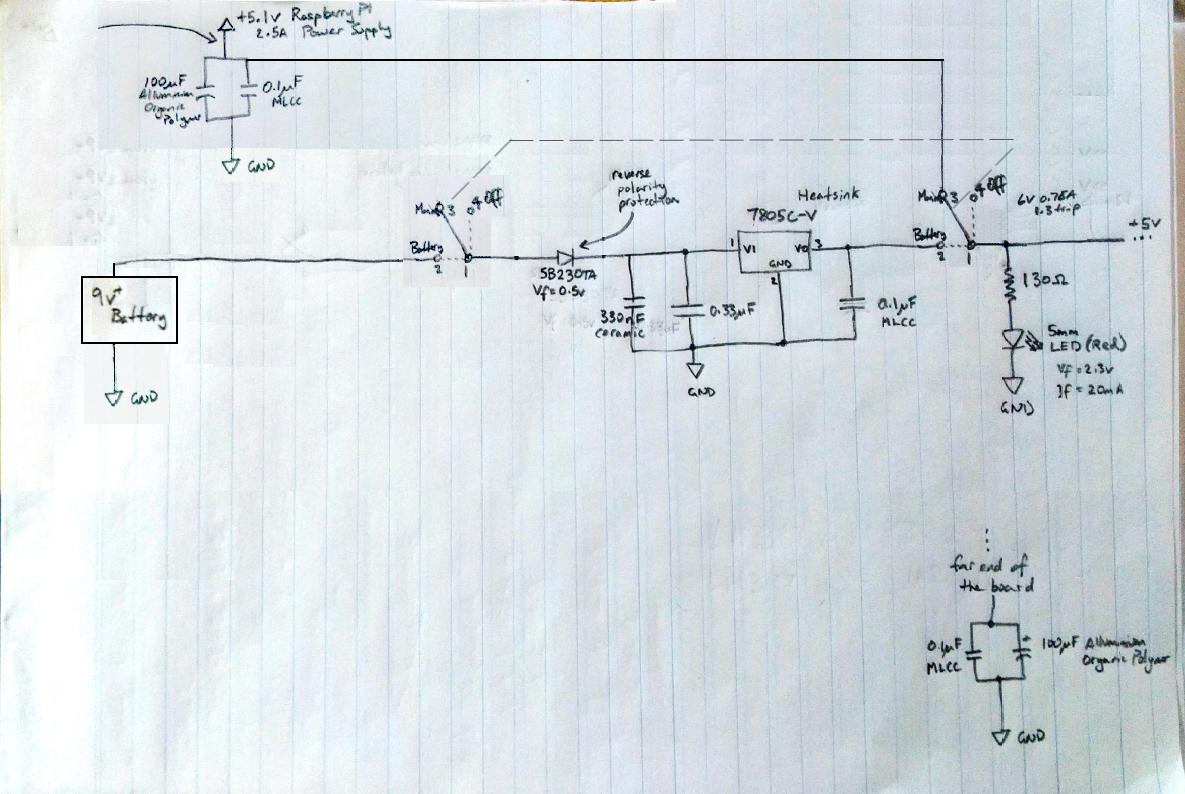

Firefox6502, the circuit Enso posted is interesting, but you indicated you already have a 7805 and a heatsink. Not that you'll need much of a heatsink, but anyway... :)
I've edited your circuit, partly to correct the issues floobydust noted. It's helpful to clearly show *both* connections to the battery and likewise both connections to the exteral supply.
I don't think the polyfuses are necessary. Also I added an extra pole on the switch. Otherwise the battery would remain connected to the 7805 even when in Mains mode, and that creates a small problem. The 7805 itself will draw a small current even with its output disconnected, and that would eventually flatten the battery.

Unless I'm missing something, you have the battery and the Pi +5V supply coming in and going thru a pair of caps in parallel. Caps won't pass DC, so neither position of the switch will result in having +5V to power your circuit.
You are totally correct! Dumb mistake by me. I should have these caps in parallel from power to ground (not in series in the cct).
Jeff, thank you so much for the new and improved cct!!! Design fixes and improvements such as this helps me to learn.
The switch you used must be a DPDT (where I was using a SPDT).
Also I may replace the SB230TA with a 1N4001 if it's cheaper as the diode is only for the battery, i.e. low current.
Enso's circuit does look very cool (thanks Enso)... given I have most of the parts already I'll go with my circuit.
But I will read up on the LM1117-5.0 and understand it's pros and cons. Potentially use it in a future circuit.
It was DP3T, the third position being OFF.
