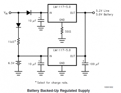

Hi guys,
Attached is my power circuit (pdf) designed from the information gathered within this thread.
I'd like to have a mobile 65C02 computer that I can take around with me. Size doesn't matter here (within reason).
What I'm trying to do is to have a circuit with two power sources, a Raspberry PI power supply (5.1V, 2.5A), and a 9V battery.
E.g.
On the go: flick the switch to the "Battery" mode
At home: flick the switch to the "Mains" mode
1. How is my circuit? Are there any critical design flaws? Excuse the crudeness, I am quite the newbie.
2. I have duplicates like the polyfuse and the pairs of capacitors (100uF, 0.1uF) one for each power source where it enters the board. I think there's no way around this, which is fine.
3. I'm not sure if I'm using the most appropriate polyfuse (Mfr. No: 06R075BPR) for my cct:
- Hold Current: 750 mA
- Maximum Voltage: 6 V
- Trip Current: 1.3 A
- Current Rating - Max: 40 A
I'd like to use a 78S05 as recommended in one of the posts above, but I already have a 7805 and a heatsink. Plus running in Battery mode wouldn't use much current (I'd imagine).

Unless I'm missing something, you have the battery and the Pi +5V supply coming in and going thru a pair of caps in parallel. Caps won't pass DC, so neither position of the switch will result in having +5V to power your circuit.

The National Semiconductor datasheet for LM1117 has this reference circuit with a battery:
