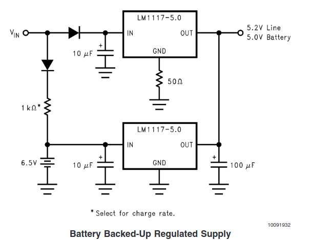

Unless I'm missing something, you have the battery and the Pi +5V supply coming in and going thru a pair of caps in parallel. Caps won't pass DC, so neither position of the switch will result in having +5V to power your circuit.

The National Semiconductor datasheet for LM1117 has this reference circuit with a battery:
