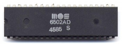

I think that my 6502 it's fake because the letters of the top were make with laser.

sprx128 wrote:
Recently, I bought a 6502, and I want make a pc with it, but I think that mine is dead, so how can I test it, without another integrated or something too hard? Because I'm waiting for more stuff and in this moment, I just have the 6502, but I have too an Arduino and rpi3 and a lot of resistances and wires, and i don't know if I can use them
From where did you purchase this 6502? Can you post a closeup photo of it so we can see the markings on it?
Sure

Production of NMOS 6502s ceased many years ago, before the widespread use of laser marking. Most likely, you have a fake, and it may not even be a microprocessor at all.
