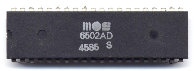

From where did you purchase this 6502? Can you post a closeup photo of it so we can see the markings on it?

I think that my 6502 it's fake because the letters of the top were make with laser.

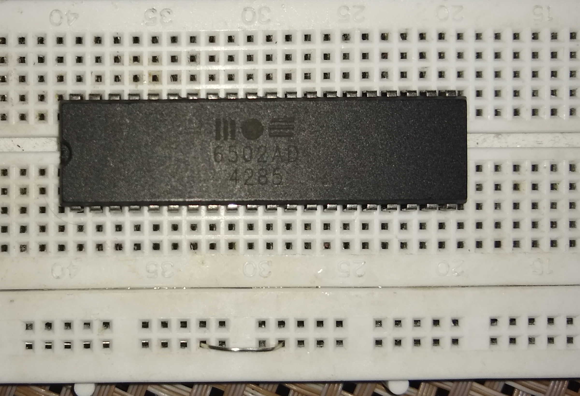

Sure

Production of NMOS 6502s ceased many years ago, before the widespread use of laser marking. Most likely, you have a fake, and it may not even be a microprocessor at all.
