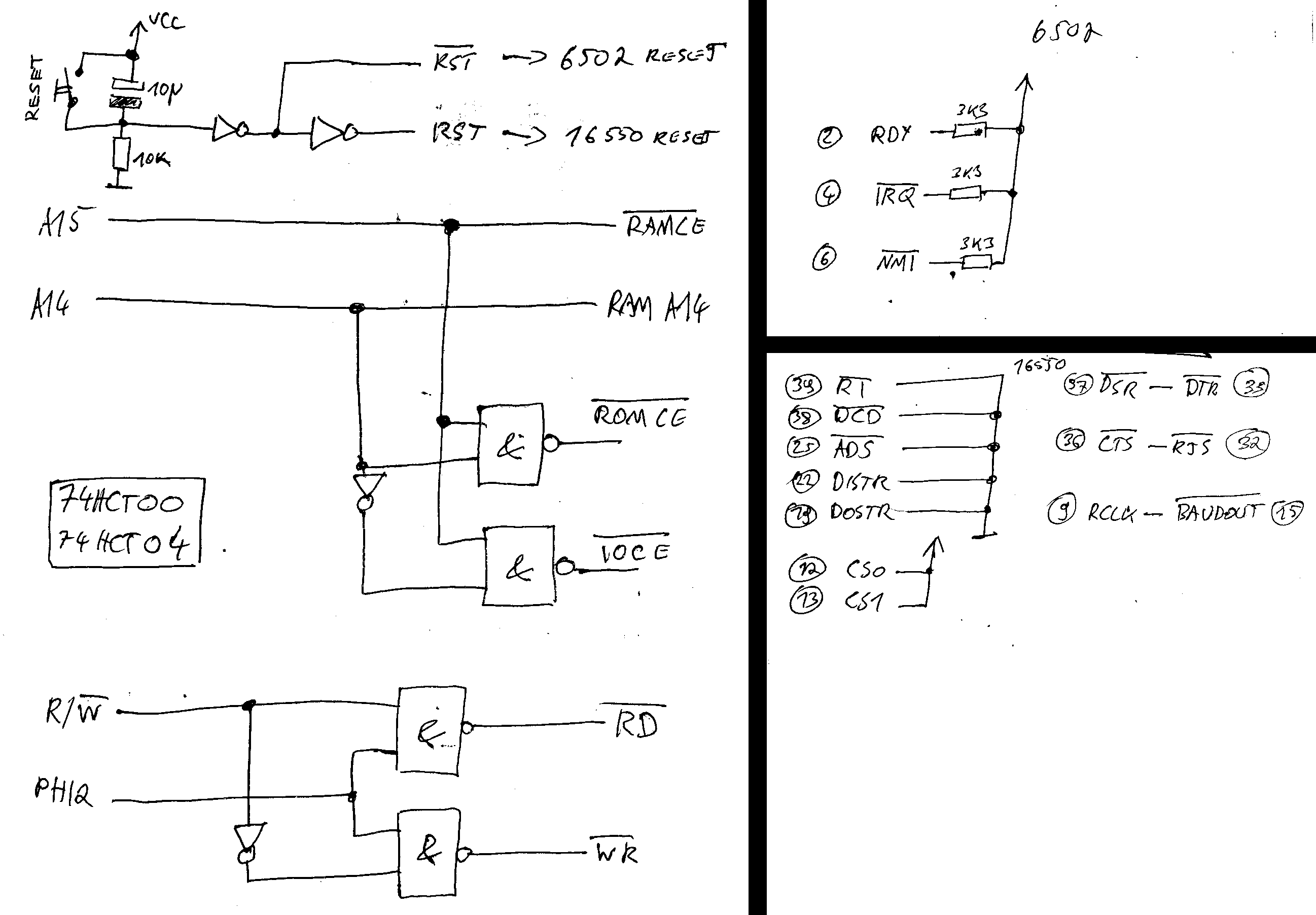

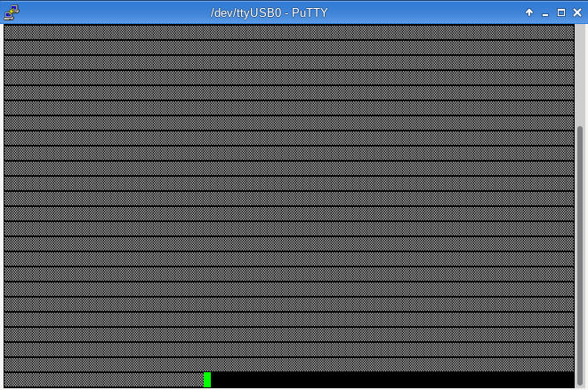

This is the first 6502 project I've ever built and also the first time I'm using the 16550 UART.
I'm trying to initialize a 16550 and send characters 0 to 255 in an endless loop via a max232 to my PC.
I was expecting some unprintable characters and somewhere in between the whole ASCII char set.
However all I get in putty is gibberish.
I've tried different baud rates 1200, 9600, 38400
I've tried another USB to serial adapter,
I've tried another Crysal osc with the same frequency (1.8432Mhz),
I've tried another 16550 chip (the other is a 16C552 actually),
But still all i get is gibberish so i figured that the problem is likely in my assembly code.
Anyways just in case I've done something wrong with the hardware I attach a rough schematic too.
Data and Address lines that are not shown in the drawing are straight connected to every chip that needs them. All IC's have 100n decoupling capacitors near them.
Does anyone have an idea how to get the UART running correctly? Thanks.

PostPosted: Thu Jan 28, 2021 6:11 pm
Posts: 1949
The pattern appears to be repetitive and stable, so the first thing I would check is the compatibility of the parity and stop bit formats between transmitter and receiver.
I would also try to avoid sending non-printable characters, due to the possibility of triggering an unexpected mode change in the receiver.
   LDY   #$20
LOOP:
   LDA   $8005      ; Fetch the control register.
   AND   #$20       ; Bit5 will be set to 1 if UART is ready to send.
   BEQ   LOOP
   STY   $8000      ; Transmit character in register Y to UART.
   INY
   BPL   LOOP
   BMI   LOOP-2

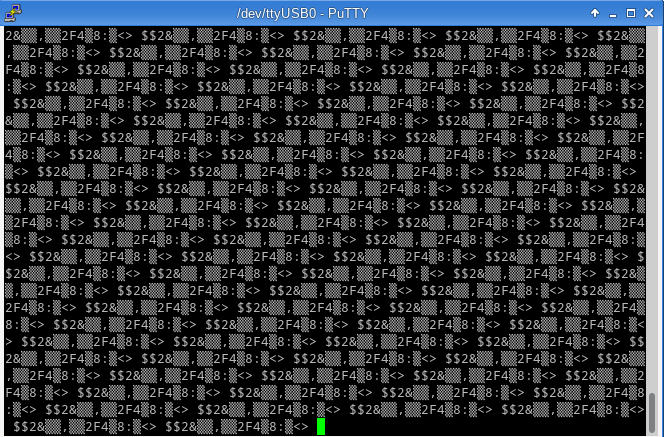

Sadly I don't have a Scope,
however #BAUDOUT reads 153600 Hz on the frequency counter which divided by 16 equals 9600 and therefore should be corerct.
I have a MAX232 connected to the 16550.
Im using a USB to TTL serial adapter (CP210x based) with another MAX232 hooked up to it. (So in this case it's basically two MAX232 facing each other. Works fine with other projects I've built)
I also have tried another USB to serial adapter (PL2303 based if I remember right), this one is a real RS232 adapter with a DB9 connector.
It's the same pattern I'm seeing with both of them. I've even hooked up the TTL one directly to the 16550 just to have it tried.
From my understanding I've set the 16550 to 8N1 with no parity and 1 stop bit. I have set up putty accordingly.
However I have played around with all kinds of data bit, stop bit and parity options in putty just to rule out the possibility. (didn't fix the problem)
   LDA   #$03
   STA   $8003   ; Set 8N1 byte framing: 8-bit data, no parity, 1 stop bit, reset DLAB Flag.
Also I've followed Mike B's advice to not send unprintable characters and start with char 0x20, which did change the pattern I'm seeing a little bit but still nothing close to resembling the ASCII char set.
Then i have tried to implement a delay between every character by having a loop of NOP's in between every char. If I've got the assembly right this should loop 255 times and then go on with whatever comes after BPL DELAY.
   LDX #$00
DELAY:
   NOP
   NOP
   NOP
   NOP
   NOP
   NOP
   NOP
   NOP
   NOP
   NOP
   INX
   BPL DELAY
However having this delay implemented I receive something completely different in putty. Something that confuses me even more than I have been before.
PostPosted: Fri Jan 29, 2021 4:25 am
Posts: 760
Location: Huntsville, AL
Recommend using capital U as your test character. When your format is 8N1, the U is a 50% duty cycle square wave. If you're feeding the UART the character with no delays, then the frequency counter should read 4800 Hz. Once you have this, then you can try the other printable characters.
Michael A.

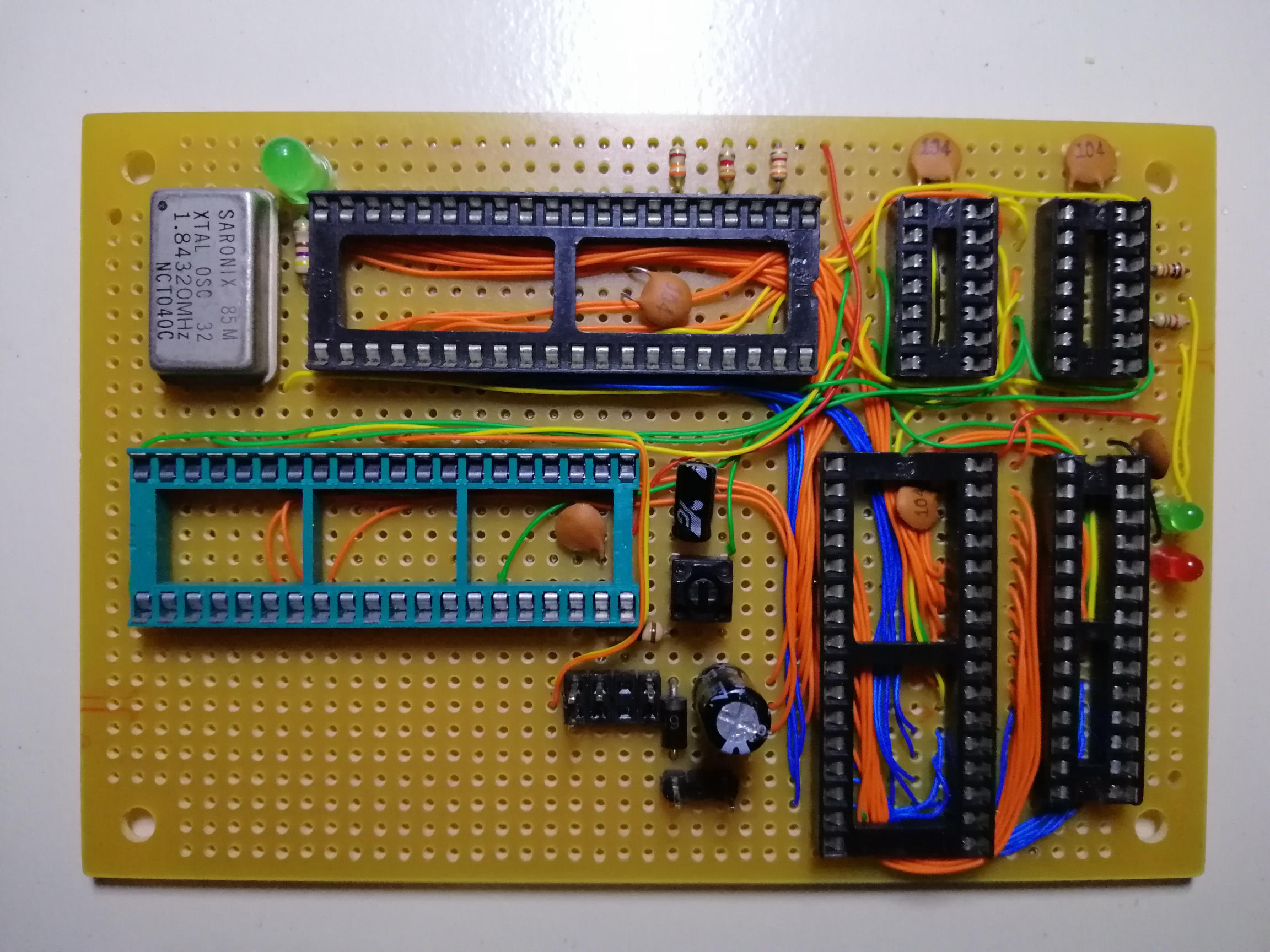

PostPosted: Fri Jan 29, 2021 9:12 am
Joined: Thu Jan 28, 2021 10:24 am
Posts: 14
Location: Thailand
ttlworks wrote:
Capital U is hexadecimal $55, binary 01010101.
It's been 20 years that I had tinkered with the 16550, and it wasn't 6502 related,
but to me it looks like your schematic and your code are supposed to work.
Would be nice if you could post photos of your hardware, maybe we are missing something obvious.
BTW: you better avoid transmitting ESC, that's hexadecimal $1B, decimal 27.

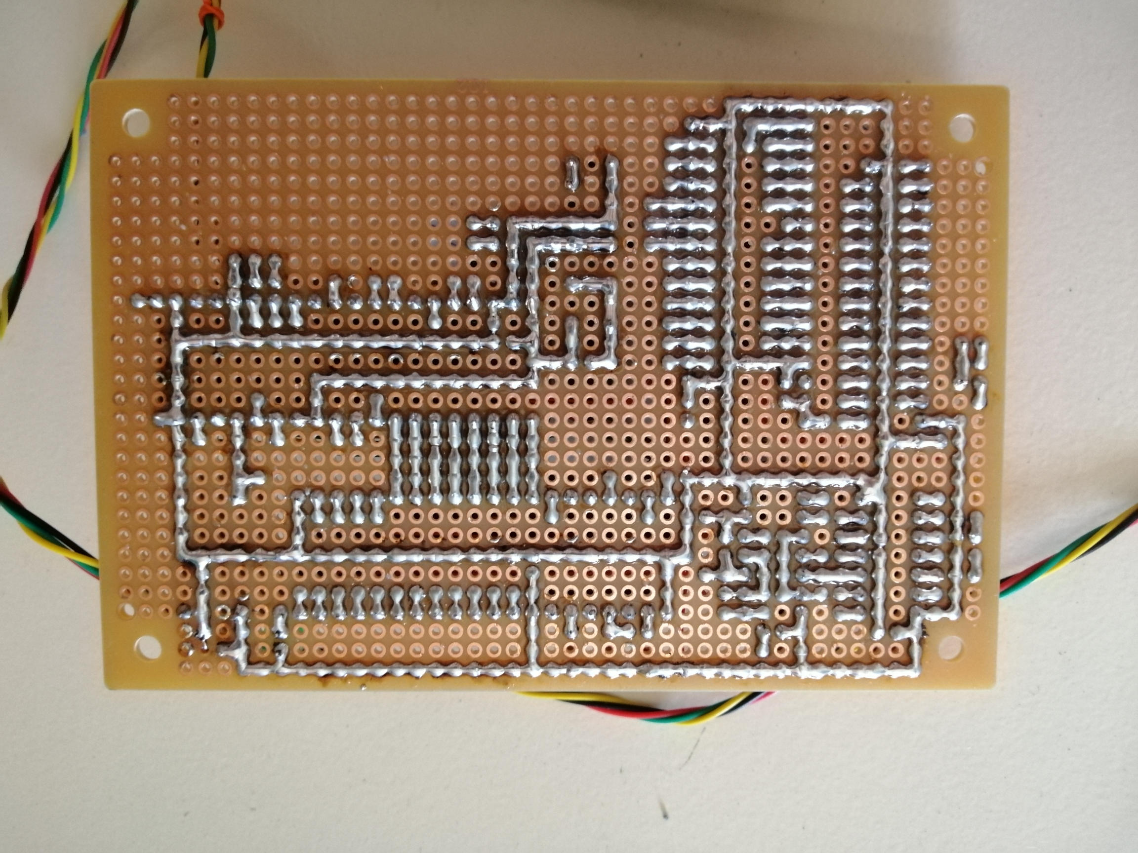

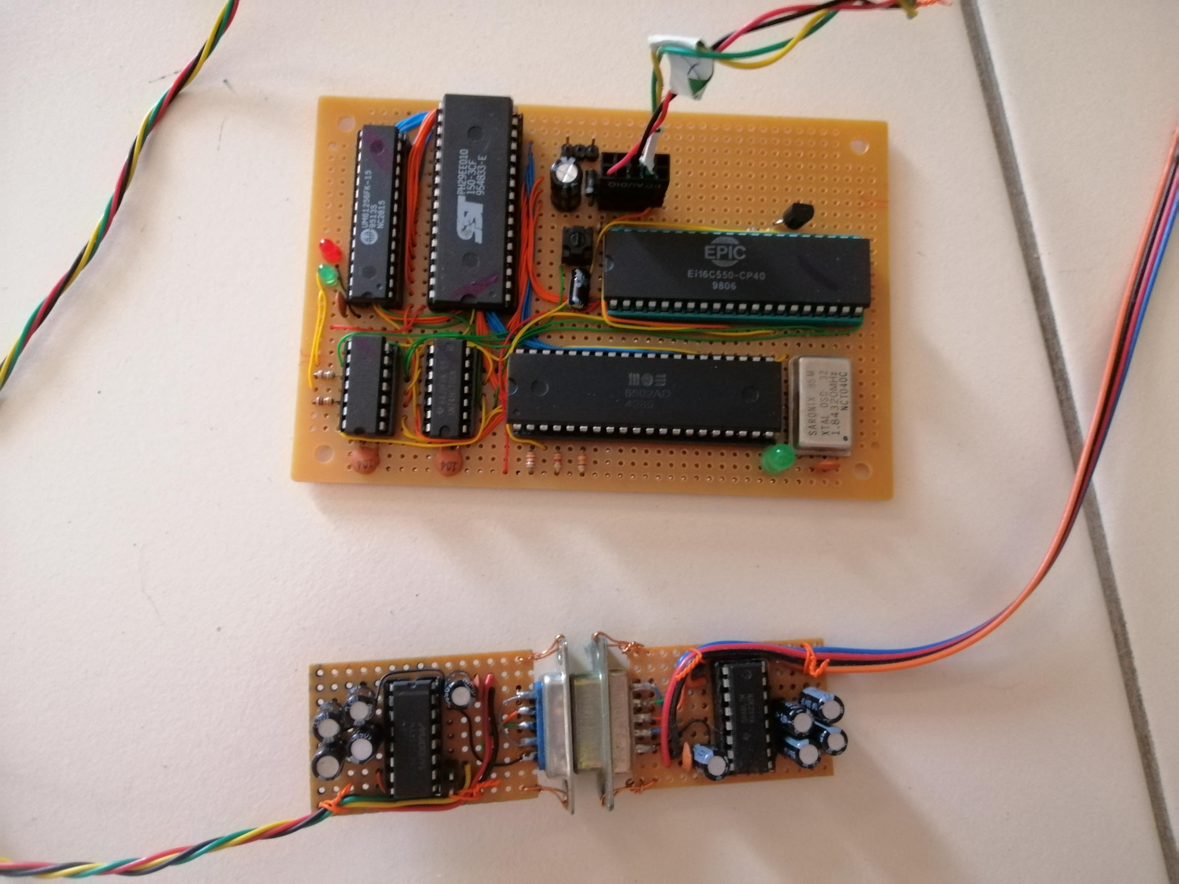

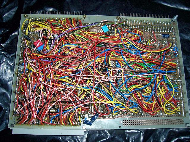

I have not tried sending U's yet, but I will as soon as I get home. However I have some pictures of the hardware at hand.
The MAX232 is on a separate board since I don't have enough of them to stick one on every board that I build (the MAX232 boards work fine with other projects, however could the wire length to these boards be a problem? Maybe the Output of the 16550 is not as strong as the ATmega chips I usually use it with?!).
File comment: a view on the wiring that is mostly under the IC's however I have taken this picture while i was building it, so there are still some wires missing in this picture and I am not keen on pulling out all the IC's just to make another photo.
File comment: bottom side of the board
File comment: The whole thing including the two mentioned MAX232 boards.
PostPosted: Fri Jan 29, 2021 10:19 am
Posts: 1431
IMHO the problem can't be related to the MAX232, because then the pattern on the screen wouldn't be that repetive.
To me, it feels more like something goes wrong with the initialisation of the UART and/or with writing characters into the UART TX register on hardware level.
Would suggest to check the wiring of the bus interface of the UART.
From your photos, it looks like D7..D0 are connected correctly.
Please check, if AS is tied to GND indeed, and if A2..0 are connected correctly.
Also, please check the 74HCT00 and 74HCT04 wiring, to be sure that there is nothing wrong with /IOCE, /WE, /RD.
For your next build, I would suggest not to have wires below the IC sockets (for simplifying debugging/modifying the hardware),
also it would be better to use the more expensive IC sockets with precision pins (because > 10 times of plugging/unplugging a chip won't do good to the sockets you are using).
Another trick for simplifying debugging is to stick with the resistor color code for the wires of the bus lines,
like D0=black, D1=brown, D2=red, D3=yellow (if you can't buy orange), D4=black again etc.
Another trick is to have labels covering the top of the ICs, with printed info which signal is on which IC pin (so you won't have to look into the schematics too often).

I've checked A0..A2 are connected correctly and AS is wired to ground as well.
So I guess the problem really must be somewhere with the 74HCT logic or the wiring around there. I'll go thru the whole board checking for shorts between bus lines and correct wiring and post an update once I've done that.
Thanks for the hint with the wire colors using resistor color code. I haven't thought of that yet. That'll make it a a lot easier to debug than just one color for each bus.
This actually is one of the very few builds where I've crammed so many wires under the sockets since I thought looping this amount of wires around the sockets might take up too much space and the local parts shop here has got only one size of perfboard. (wasn't fun to do that anyways since I soldered the sockets in first)
Regarding the IC sockets I'm well aware that they are not very durable but they usually do the job well enough as it wasn't planned to run into a mysterious problem that forces me to swap the memory a few dozen times. I do by the way prefer this kind of socket over precision sockets since precision sockets make bending or breaking off IC legs too easy and its also difficult to stick salvaged parts with a little solder residue on the pins in those.

I've got it working!!!
After checking the wiring and not finding anything wrong I went thru my IC boxes looking for some 74HCT replacements to just eliminate the possibility that one of them is faulty. I found some and replacing them didn't solve the problem either. However while going thru the boxes I did find a third 16550 and this one just works. So it seems both IC's I tried before are faulty (how small is the chance of having two faulty IC's from different manufacturers producing similar gibberish?!)
Thank you everyone for your help and suggestions. I did even learn a few assembly things in the process, especially how to make efficient loops.
File comment: it works and I am seriously so happy about it that I might actually enjoy watching the ASCII char set printing over and over for half an hour.
What was your source for the UARTs? If eBay, there is no telling what you were sold. Also, it could be the UART was damaged by ESD, which is always lurking during the cold months.
The 16550 are all salvaged from old Mainboards and ISA I/O cards, as is the SRAM.
The 6502 is from China tho, from the looks I'd say the original marking has been sanded off. I've got two of them, both DIP packages look exactly the same with the small circle in the top corner and the marking "SB59" and Taiwan on the bottom. From the current draw (~150mA for the whole board) I'd say they are probably real, just NMOS versions remarked. I don't really mind about them being NMOS or the current draw, I just wanted to play around with some 6502 for the first time ever. At least I got 6502's and not some useless random IC with a fresh marking. (I did buy them fully aware of that I might get remarked or even worse complete fake chips since I could not find another source for these.)
