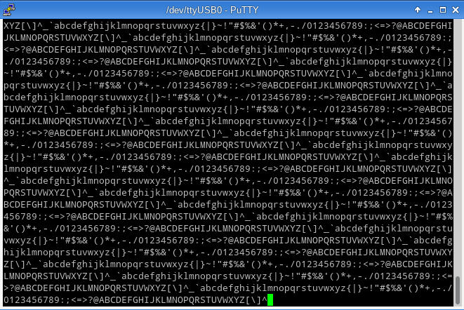

This is the first 6502 project I've ever built and also the first time I'm using the 16550 UART.
I'm trying to initialize a 16550 and send characters 0 to 255 in an endless loop via a max232 to my PC.
I was expecting some unprintable characters and somewhere in between the whole ASCII char set.
However all I get in putty is gibberish.
I've tried different baud rates 1200, 9600, 38400
I've tried another USB to serial adapter,
I've tried another Crysal osc with the same frequency (1.8432Mhz),
I've tried another 16550 chip (the other is a 16C552 actually),
But still all i get is gibberish so i figured that the problem is likely in my assembly code.

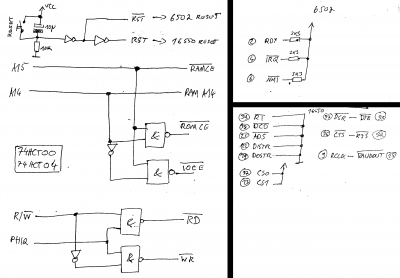

Anyways just in case I've done something wrong with the hardware I attach a rough schematic too.
Data and Address lines that are not shown in the drawing are straight connected to every chip that needs them. All IC's have 100n decoupling capacitors near them.
Does anyone have an idea how to get the UART running correctly? Thanks.

PostPosted: Thu Jan 28, 2021 6:11 pm
Posts: 1948
The pattern appears to be repetitive and stable, so the first thing I would check is the compatibility of the parity and stop bit formats between transmitter and receiver.
I would also try to avoid sending non-printable characters, due to the possibility of triggering an unexpected mode change in the receiver.

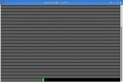

Sadly I don't have a Scope,
however #BAUDOUT reads 153600 Hz on the frequency counter which divided by 16 equals 9600 and therefore should be corerct.
I have a MAX232 connected to the 16550.
Im using a USB to TTL serial adapter (CP210x based) with another MAX232 hooked up to it. (So in this case it's basically two MAX232 facing each other. Works fine with other projects I've built)
I also have tried another USB to serial adapter (PL2303 based if I remember right), this one is a real RS232 adapter with a DB9 connector.
It's the same pattern I'm seeing with both of them. I've even hooked up the TTL one directly to the 16550 just to have it tried.
From my understanding I've set the 16550 to 8N1 with no parity and 1 stop bit. I have set up putty accordingly.
However I have played around with all kinds of data bit, stop bit and parity options in putty just to rule out the possibility. (didn't fix the problem)
   LDA   #$03
   STA   $8003   ; Set 8N1 byte framing: 8-bit data, no parity, 1 stop bit, reset DLAB Flag.
Also I've followed Mike B's advice to not send unprintable characters and start with char 0x20, which did change the pattern I'm seeing a little bit but still nothing close to resembling the ASCII char set.
Then i have tried to implement a delay between every character by having a loop of NOP's in between every char. If I've got the assembly right this should loop 255 times and then go on with whatever comes after BPL DELAY.
   LDX #$00
DELAY:
   NOP
   NOP
   NOP
   NOP
   NOP
   NOP
   NOP
   NOP
   NOP
   NOP
   INX
   BPL DELAY
However having this delay implemented I receive something completely different in putty. Something that confuses me even more than I have been before.

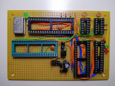

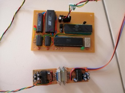

I have not tried sending U's yet, but I will as soon as I get home. However I have some pictures of the hardware at hand.
The MAX232 is on a separate board since I don't have enough of them to stick one on every board that I build (the MAX232 boards work fine with other projects, however could the wire length to these boards be a problem? Maybe the Output of the 16550 is not as strong as the ATmega chips I usually use it with?!).

IMHO the problem can't be related to the MAX232, because then the pattern on the screen wouldn't be that repetive.
To me, it feels more like something goes wrong with the initialisation of the UART and/or with writing characters into the UART TX register on hardware level.
Would suggest to check the wiring of the bus interface of the UART.
From your photos, it looks like D7..D0 are connected correctly.
Please check, if AS is tied to GND indeed, and if A2..0 are connected correctly.
Also, please check the 74HCT00 and 74HCT04 wiring, to be sure that there is nothing wrong with /IOCE, /WE, /RD.
For your next build, I would suggest not to have wires below the IC sockets (for simplifying debugging/modifying the hardware),
also it would be better to use the more expensive IC sockets with precision pins (because > 10 times of plugging/unplugging a chip won't do good to the sockets you are using).

I've got it working!!!
After checking the wiring and not finding anything wrong I went thru my IC boxes looking for some 74HCT replacements to just eliminate the possibility that one of them is faulty. I found some and replacing them didn't solve the problem either. However while going thru the boxes I did find a third 16550 and this one just works. So it seems both IC's I tried before are faulty (how small is the chance of having two faulty IC's from different manufacturers producing similar gibberish?!)
Thank you everyone for your help and suggestions. I did even learn a few assembly things in the process, especially how to make efficient loops.
File comment: it works and I am seriously so happy about it that I might actually enjoy watching the ASCII char set printing over and over for half an hour.
