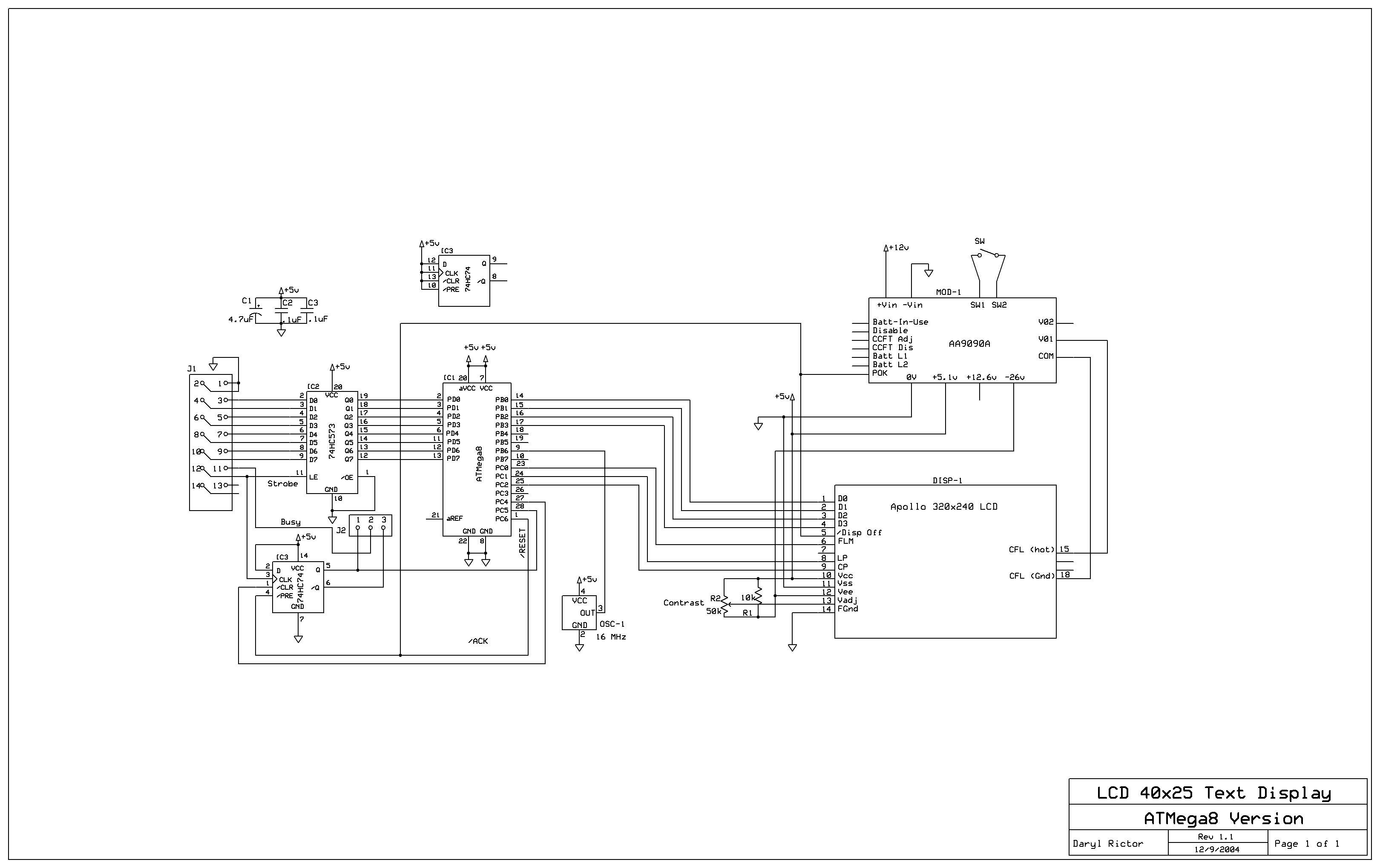

PostPosted: Fri Jan 29, 2021 5:44 am
Posts: 1748
Location: Sacramento, CA
Attached Zip has datasheet for Optrex display and the AVR code. it's been a long time and I cannot vouch for the readability of the code. Ask any questions you have and I'll try to refresh on the info and get you an answer.
Also added image of the working schematic.
Daryl

PostPosted: Fri Jan 29, 2021 8:50 am

PostPosted: Fri Jan 29, 2021 1:08 pm
Posts: 1120
Daryl
Daryl,
Thank you, this is exactly what I'm looking for. The Apollo module is very close to UG-32F01, the negative bias voltage of -26V is quite a bit more than -16V of UG-32F01; the alternate DC bias required by UG-32F01 is generated internally in Apollo. Your ATmega code should help me find out why I can't get my display to work.
This is my attempt at LCD controller using Z80. Z80 works and I throw a big CPLD at the problem, but still can't get the LCD screen to respond beyond gibberish.
https://www.retrobrewcomputers.org/doku ... smo:z80lcd
