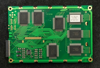

This is picture of the ICs at the back of UG-32F01. They are 4 MSM5299 80-dot segment drivers for 320 dots and 3 MSM6598 80-dot common drivers for 240 rows of 320 dots per row. My limited understanding is collectively they shift data to locations on the screen kinda like raster scan of CRT. It is unclear to me how long the LCD screen retains the data. The datasheet mentions a minimum frame frequency of 70Hz, implying the screen need to be refreshed 70 times a second, minimum? I did find a paper describing UG-32F01 in conjunction with SED1351 graphic controller. That is my best hope of reverse engineering the LCD display, a rather arduous process...
Is that to say you haven't found a datasheet for the panel, only the ICs? (I found datasheets for the ICs, but they didn't have the information you'd need for writing your software, and I have not found a datasheet on the completed LCD module.) I'm pretty sure however that the ICs take care of all the scanning, and I expect that after you've fed it a screen of data, it will maintain it until you write new data to it, and even then, it probably has scrolling functions so for example if you have a screen of text and want to scroll it all up a line and feed it a new line of text at the bottom, you only need to tell it to scroll that far and then give it the new line, not give it all the data again in different positions. That's the way my little 128x64 graphic LCD is. It does not have a controller in the sense of generating characters and so on, so you have to feed it data about which dots to turn on and off; but then it keeps those data indefinitely, until you feed it new data. Your LCD module's ICs might scan the whole LCD 70 times per second, but that does not mean you have to feed it the information 70 times per second. It has its own memory that it scans from.
That's the job of a controller, and this display doesn't have one. It only has the drivers. There's no memory, except for the shift registers that can only hold a single row or column. If you want the display to keep displaying, you have to feed it an entire frame of data every frame. If you don't, it will stop displaying and you risk damaging the LCD.
A bare LCD needs funky waveforms at funky voltages. The drivers provide these, giving the rest of the system a nice digital interface. But that's all they do.
I have not found much electrical spec about UG-32F01 other than the one posted at the beginning of the thread. I do have experience interfacing to modern 128x64 OLED display over I2C bus; like you've said, it takes in pixel data and continuously update them by itself so no need for constant refresh. The UG-32F01 does not appear to have the self-refresh capability
