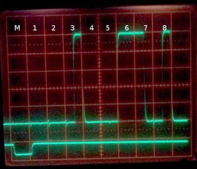

Here we go again, this time with new chinese scope probes and a marker on the other channel to incontrovertible identify the machine cycles. The marker is an unused output of the IO address decoder. The signal shown is bank/data 0.

1 PBR,PC          OpCode
2 PBR,PC+1        AAL
3 0,S             PCH
4 0,S-1           PCL
5 PBR,PC+2        AAH
6 PBR,PC+2        IO
7 PBR,AA+X        New PCL
8 PBR,AA+X+1      New PCH
As can be clearly seen, the op, stack and jump table location accesses bank0. Then the internal op cycle and the following read of the low indirect address goes to bank1, the high indirect is read from bank0. The internal should be PBR and the two indirect parts just MUST be from the same bank.
This MCU does something completely wrong. Almost unbeliveable, but that is what happens. Any explanation?
The supply is perfectly smooth and within tolerances. The only questionable signal is dv/dt at PHI2, but it works for anybody else with just an ordinary driver. I have also tested with a separate 245 output just driving the MCU input with no result.
It feels uneasy not to know what is going on and I'm too curious to just PEA @+5, JMP (ABS,X) and be happy with that.
PostPosted: Fri Dec 11, 2020 9:57 am
Posts: 10977
Great traces! Still very unexpected, to me. Have you got another '816 to swap in? Usually "faulty cpu" is one of the last hypotheses, especially when it's 99% working, but this is odd enough to consider it. Unless someone else has an epiphany.
PostPosted: Fri Dec 11, 2020 3:35 pm
There was good reason to be cautious about the conclusion it's 99% working. For example, newly build hardware can have errors; also, there's an issue with tests such as the one that relied on a software post mortem to try to determine where the faulty JSR landed (because of the possibility the post mortem itself isn't behaving properly).
But this hardware-based test is quite simple and specific -- a real eye opener! :shock: As Ed says, Have you got another '816 to swap in?

If I had another MPU on hand, it would of cource already had been tried. I have two on order since a week or so from Mouser. Hopefully I get them before the big holidays that are coming up now. They will almost for sure also be made at the Sanyo plant. If those too fails in the same way, I will order a couple of QFP made at TSMC and adaper boards for them. But that will take some time and some cost...
There are of cource no guarantees all other instructions are working, but so far so good. No strange lockups at all. Validating everything in all modes and from different banks is too big for me and things may still be marginal.
Maybe a silly question, but has You or any other of You tried the JSR (ABS,X)? I can think it's used quite seldom and if magic effects shows up then a workaround is very easy. The PEA/JMP f.ex. imposes very little penalty and the problem will be gone. Hopefully...

As can be seen on my first test to find out where the JSR "landed", that was done in native mode with wide A and short indexes. The problem was still present.
The actual bank settings may have an effect. My program is running from bank0 with all new registers left in reset conditions. As my hardware happens to be built, testing from bank $F8 is impossible. BA 4 to 7 are don't care, but BA 3 is I/O select. The address decoder is wired with VDA and VPA to only accept data R/W, so running code in PGRAM is not possible. This was needed to minimize glitches from disturbing the video display.
