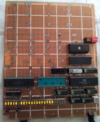

Here is a photo of the project. I think it's quite disappointing, still far from what the AIM was. It will never get a themal printer, but it will get the screen AIM never had. The unpopulated socket is meant for a 6345 CRTC and then there will be a few
other sockets added for the rest of it. I like this solution better than a terminal over TTY.
The VIA has one of its ports connected to a 16F1459 that gives it keyboard input and file storage from my PC via USB. Linux of cource and the software in GCC. It's thought to work with the original casette commands, but instead save and read from a direcory on the PC. There are still a bit of work to do on that, but the winter is long...
The displays are HP matrix LED with integrated drivers, but no chargen. It uses the chartables intended for the printer and output through the VIA's shift register.

Nice display!

Those are very nice! They're also very expensive, but may be well worth it when you're only making one unit for yourself. For anyone else interested, you can find them and their data sheets at https://www.broadcom.com/products/leds- ... -interface . (The line was initially made by HP, then Avago, and now Broadcom.)

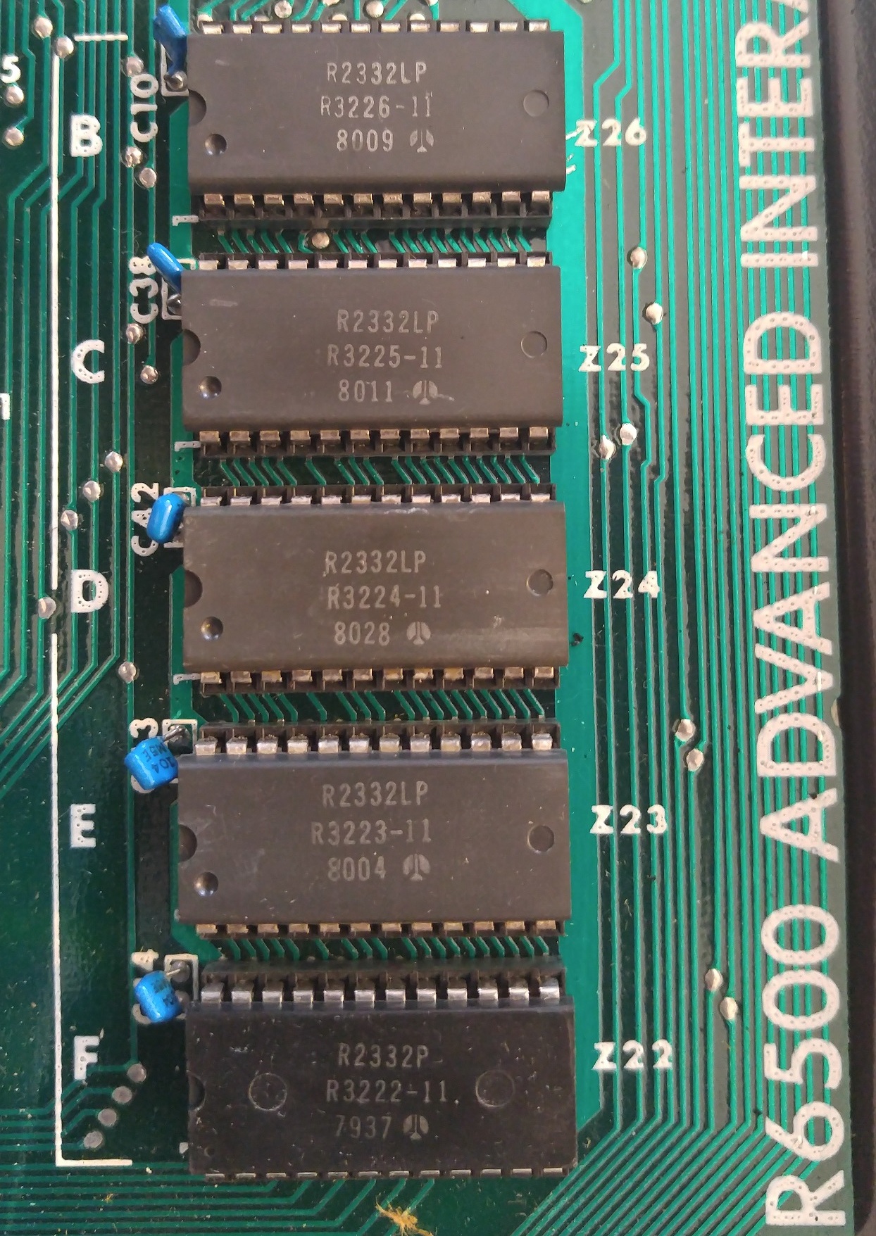

All solved now. The ROM files have names that identify the slot on the AIM 65 board, like xxxxZ23 to xxxZ26.
Added an image of the actual board layout also.
