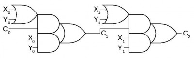

Thanks for the link BigEd. I was interested to see the carry lookahead circuit in the 8008 described as follows:
“You might wonder why this carry lookahead circuit is any faster than a plain ripple-carry adder, since the carry signal has to go through up to seven large gates to generate the last carry bit. The trick is that the entire circuit is electrically a single large gate due to the dynamic design. All the transistors are activated in parallel, and then the 5-volt signal can pass through them all rapidly.5 Although there is still a delay as this signal travels through the circuit, the circuit is faster than the standard ripple carry adder which activates transistors in sequence.”
It seems that Dieter’s FET Adder is doing much the same thing and activating the FET switches in parallel.
