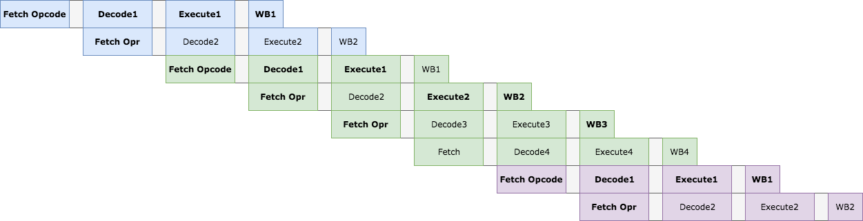

The first microinstruction loads the inputs of the ALU and the second performs the ALU operation itself. To be clear, the RISC form of the instruction would execute the same sequence of steps with respect to the ALU as it works down the pipeline. But it remains an atomic unit that describes only a single operation.
I initially found the order you mentioned the Fetches a bit confusing, but then I understood that by FetchOperand you mean the cycle were the current instruction is being decoded, and by FetchOpcode you mean the next opcode being fetched while the current instruction is executing.

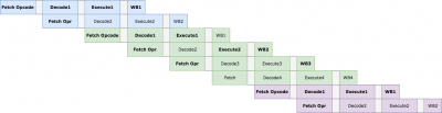

So without the aim to be accurate or exhaustive, I made a quick drawing as an attempt for me to understand and visualise what's going on in your pipeline:
The drawing represents a 2 cycle instruction, followed by a 4 cycle instruction, followed by a 2 cycle instruction. Operations related to every instruction are represented in different colours. Bold texts represent actual operations in the pipeline, while plain texts represent pipeline steps that either do nothing or are discarded for the next cycle. I have also displayed the write back cycle with half the length to represent that results are available before the decoding cycle of the next instruction finished.
I believe this shows why there are no hazards, and why it is safe to recirculate data through the alu. For example the two consecutive executing steps of the green instruction can be a "recirculation" of the ALU.
In this case, keeping the minimum 2 cycles per instruction of the 6502, is key for this to be possible, because execution cycles of any two consecutive instructions are always separated by at least one cycle between them. Is this right?

Yes, I think this is right. On the 6502, a FetchOperand always follows a FetchOpcode. The ALU operation can be performed concurrently with a FetchOpcode but never with a FetchOperand. Hence, FetchOperand always provides the minimum space needed in the pipeline to avoid data hazards.
In addition, the following two modifications were required to avoid FetchOpcode control hazards:
1) Use the opcode itself in place of the microinstruction in the FETCH stage at the time FetchOpcode is executed, and
2) Use “split” microinstructions to eliminate the need for a separate microinstruction in the DECODE stage.
Hope that helps.
