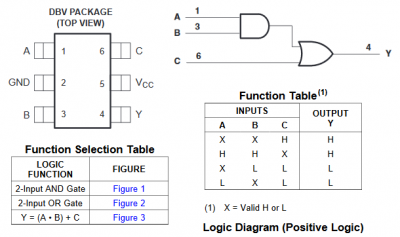

While flipping through the pages of the TI Digital Logic Pocket Data Book 2007, I noticed an interesting chip:
TI 74LVC1G0832
3.3V, 15pF load: 1.7 / 3.35? / 5
5V, 15pF load: 1.2 / 2.3? / 3.4
Nexperia 74AUP1G0832
3.3V, 15pF load: 1.9 / 3.2 / 4.5
These chips are too slow to be used in our 100MHz CPU.
There is no 74AUC version of that chip in production... yet.
But an AND gate feeding an OR gate, that's the ALU carry chain for one Bit.
74LVC1G3208 and 74AUP1G3208 also are available, an OR gate feeding an AND gate.
Cute, now back to 74AUC2G53...
