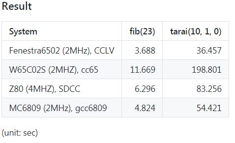

It's easy to rationalize the results for all except the stock 65C02. This doesn't reflect well on the comparative abilities of cc65 to emit performant code (or is SDCC just unusually good?).
Re: Fenestra6502
It might be saying that it's easier to make a performant C compiler for a Z80, but I think that's a different topic for this thread - a good idea for a new one perhaps?

The benchmark result of MC6809 is corrected. (I miscopied.)
tarai: 54.421 sec -> 51.421 sec

I seem the tarai function is suitable for this kind of benchmarks, especially for measuring the performance of procedure/function calls.
Dr. Ikuo Takeuchi, the inventor of the tarai function, is famous as a Lisp hacker (one of the developper of TAO and NUE). It is said that tak version is McCarthy's mistake.
By the way, I made a MC6800 SBC (MC68B00, 2MHz) to compare the performance with Fenestra 6502 and others. Does anybody know if there is a C compiler for MC6800? If not, I will write a code generator of CCLV for MC6800.
