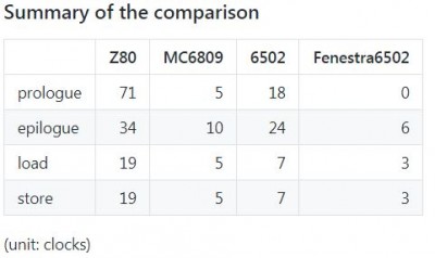

 Post subject: Re: Fenestra6502
PostPosted: Sat Oct 10, 2020 5:30 pm
Posts: 1949
It's easy to rationalize the results for all except the stock 65C02. This doesn't reflect well on the comparative abilities of cc65 to emit performant code (or is SDCC just unusually good?).
PostPosted: Sat Oct 10, 2020 5:49 pm
It might be saying that it's easier to make a performant C compiler for a Z80, but I think that's a different topic for this thread - a good idea for a new one perhaps?
