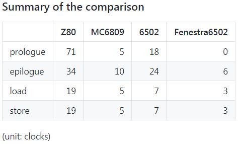

Hi,
I made a 6502-based computer for high-level programming languages.
I also wrote a tiny compiler for the computer.
https://github.com/hatsugai/Fenestra6502

The circuit realizes "zero-page windows", which is similar to "register windows" adopted in several RISC processors. The circuit detects the instruction fetch of JSR/RTS and changes the mapping of zero-page on physical memory.
Very nice diagrams and explanation too - thanks for that and well done! (And thanks for choosing an open source license)

It's an interesting idea. You're basically creating a hardware data stack, which given the 6502's page zero addressing modes also acts like a register file.

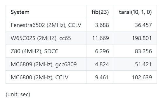

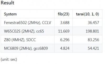

It's easy to rationalize the results for all except the stock 65C02. This doesn't reflect well on the comparative abilities of cc65 to emit performant code (or is SDCC just unusually good?).

It might be saying that it's easier to make a performant C compiler for a Z80, but I think that's a different topic for this thread - a good idea for a new one perhaps?

The benchmark result of MC6809 is corrected. (I miscopied.)
tarai: 54.421 sec -> 51.421 sec

By the way, I made a MC6800 SBC (MC68B00, 2MHz) to compare the performance with Fenestra 6502 and others. Does anybody know if there is a C compiler for MC6800? If not, I will write a code generator of CCLV for MC6800.

I think there might not be one. (HP had one which ran on their Unix workstations and on VAX/VMS, but getting that working would be difficult.)
A new code generator could be of interest to many...

I wrote a code generator of CCLV for MC6800 and measured the execution time of fib and tarai.
