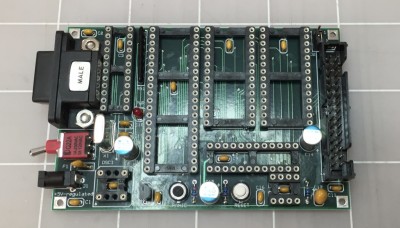

I've been away from the forum for a while, but in that time I have been working on my computer and have made some progress.
I think I previously mentioned that the Ben Eater 6502 breadboard computer re-ignited my interest in building a computer. I started with one of his kits, and then started adding to it. I first added a 6551, and then tried to add a SC28L92. However, since the additions were pretty simple, I never updated Ben's schematic or created one of my own. So, I took some time, started learning KiCad, and created my own schematic.
After I created a schematic I went back and rebuilt my breadboard version following the schematic. While rebuilding the breadboard version I think I figured out that the problem I was having with the SC28L92 was due to noise on the RESET line. I updated the schematic to address the noise, updated the breadboard and everything seems to be working correctly, including the SC28L92.
After that, I completely rebuilt my wire-wrap version. It is currently running at 10 MHz and appears to be stable.
I'm attaching the schematic and some photos if anyone is interested.
I really appreciate all of the help I have received to get me to this point.
Shawn

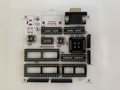

While I was at it, since I had created a schematic in KiCad, I also created a PCB layout.
Originally I had the ICs oriented vertically with the DB-9 connectors on the right edge of the board, but I thought having them on the back edge of the board would be more conventional, so I moved them to the back edge and re-oriented the ICs horizontally.
I am attaching a photo of the mock-up I used to ensure everything fits.
When I received the DB-9 connectors I found that I had used the incorrect footprint and the physical connectors were several millimeters deeper. I was worried at first, but I was able to move things enough to free up enough room for the connectors. I'm glad I ordered and received the parts before I ordered the PCBs!
The PCB dimensions are 100mm x 100mm to take advantage of the low price from the PCB manufacturer.
By the way, the routing is 100% auto-routed using freerouting v1.4.4. I'm not an expert, so I don't know what could be improved, but I am happy with the results. If anyone sees any glaring problems, please let me know. I'm attaching print outs of the front and back copper layers. I included just the front and back copper layers to keep the clutter down, but if anyone wants to see the ground or power planes, or if the footprints or silkscreen would help let me know and I'll include those.
I plan to double check the layout and routing a few more times before ordering PCBs early this coming week.
Thanks,
Shawn

It strikes me that the signals from the 22V10 all go a long way across the board. It might be a better idea to move it nearer to the devices it connects to. Displacing the 7400 and the UART crystal would be a relatively minor and inconsequential sacrifice.
Conversely, keeping the two memory devices side by side, as they are now, is a good idea since they essentially connect pin to pin. The signals from there to the CPU and other devices are the ones that get tangled up, because the JEDEC memory pinout is a complete shambles. Consider rotating the pair of them together, in 90° increments, to see which way routes the address and data lines least messily.
Also, there are some places where traces are needlessly being "wound around" pins. Some massaging should produce shorter and more direct paths. Pay attention to the board house's design rules with regard to spacing of different board features. It looks as though you're pretty tight in a couple of locations—it's hard to estimate anything with the layouts in PDFs.
Pay heed to what Chromatix said about the positioning of the chips.

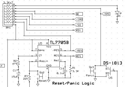

First, congrats on getting your system up and running, that always feels good... having success!
A few comments on your design and some possible changes. Again, everyone has their own view on this stuff, but...
- Look at the TI7705B as a reset chip. It will give you positive and negative reset lines. You can use the DS1813 for a NMI trigger (panic button).
- WDC also make a W65C22 with an open collector IRQ output. Using this version, you could eliminate the 74HC00 entirely. You can also use a shottky diode for the IRQ line with the existing W65C22.
- I'm guessing you're using one of the serial lines for a console. In most cases, a Serial-to-USB adapter is used, as most current systems don't have serial ports anymore. If this is the case, you could swap out one of the DB-9 connectors with a FTDI adapter... mounts in the DB-9 format and can connect directly to the SC28L92 without any level changes.
- I also tend to hide the bypass caps for socketed DIP devices underneath the chip itself. You can usually get the leads even shorter/closer to the VCC pins that way.
