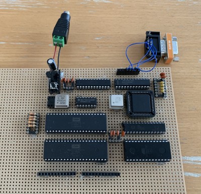

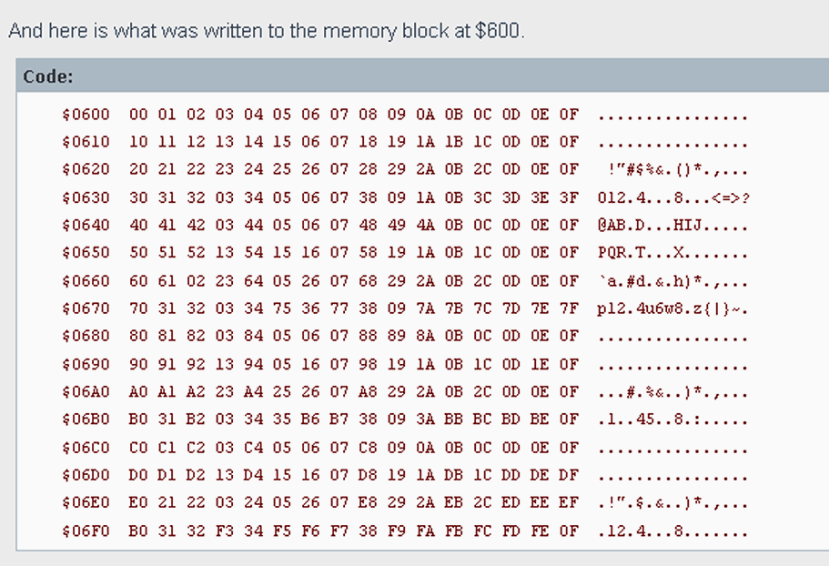

Recently I've been struggling to add an SC28L92 DUART to my computer. I've read and re-read the datasheet and BigDumbDinosaur's guides, but I can't seem to get it to work consistently. I keep getting occasional corrupted data. I think it may be a timing issue.
To troubleshoot, I decided to try repeatedly writing to and reading from the general purpose register (1100 / $C) to see if I always read the same value I wrote. Here is the program I wrote to do that.

And here is what was written to the memory block at $600.

It looks like D0-D3 are consistently correct, but D4-D7 are not. I'm not sure what that means and if it is significant.
I have double checked my wiring and it looks correct, and I didn't find any shorts when I checked with an ohm meter.
I am currently clocking my computer using an 8 MHz crystal, but I get similar results when I use a 1 MHz crystal.
I have tied I/M to VCC to ensure the SC28L92 is in 80xxx mode.
Currently, both WRN and RDN are qualified with PHI2, but I had the same results when only WRN was qualified.
CEN is not qualified with PHI2.
I'm not sure what to try next. Does anyone have any suggestions?
This makes me suspect you are inadvertently accessing some other register, not the general purpose register (1100 / $C). Is there some other register in the chip for which you'd expect D0-D3 to read back the same, but the other bits not? If so, what is the address of that register? Similar to 1100 except for one bit, perhaps?
In case it helps anyone to ponder, here (below) is an animation to compare the good data (green) with the bad (red).
Despite all your checking, I suspect there's a wiring error or perhaps an error in the doc that guided the wiring. Just a hunch. It's the best I can offer so close to bedtime. :) Good luck!
ps- any surprises if you change your test program to write then read RAM instead of I/O at $801C?
click on this preview to view the ANIMATION
Surprises? That depends on our expectations.
Writing to and reading from RAM doesn't exhibit this problem.
I believe only the Mode and General Purpose registers are R/W. I think the other registers would return something completely different when read than what was written. I had the same problem writing to and reading from the Mode register before I tried the General Purpose register.
You are probably right. I'll probably rewire it and see if that helps.
I would have already ordered another chip to rule out a bad chip, but it's hard to justify paying as much for shipping as the part itself.
Thanks for your comments.

Oops! I lied. I don't get similar results when I use a 1 MHz oscillator. Here are the results I get for each of the oscillators I have.
1 MHz

    $0610  10 01 12 13 14 05 16 17 08 19 1A 1B 1C 1D 1E 1F  ................
    $0620  20 21 22 23 24 05 26 27 08 29 0A 2B 2C 2D 2E 0F   !"#$.&'.).+,-..
    $0630  30 31 32 33 34 35 36 37 38 09 3A 3B 0C 3D 3E 3F  012345678.:;.=>?
    $0640  40 41 42 43 44 05 46 07 48 49 4A 4B 4C 4D 0E 4F  @ABCD.F.HIJKLM.O
    $0650  50 51 52 53 54 55 56 57 58 09 5A 5B 5C 0D 5E 5F  PQRSTUVWX.Z[\.^_
    $0660  00 61 62 63 64 05 66 67 68 69 6A 0B 6C 6D 6E 6F  .abcd.fghij.lmno
    $0670  00 71 72 73 74 75 76 07 78 79 7A 7B 2C 0D 7E 7F  .qrstuv.xyz{,.~.
    $0680  80 01 82 83 04 85 06 87 88 09 8A 8B 8C 8D 8E 8F  ................
    $0690  90 91 92 03 94 95 96 97 98 99 9A 9B 9C 9D 9E 9F  ................
    $06A0  A0 A1 A2 A3 A4 A5 A6 A7 08 A9 0A AB AC 0D AE AF  ................
    $06B0  B0 B1 02 B3 B4 B5 B6 07 08 B9 BA BB BC BD BE 0F  ................
    $06C0  C0 C1 C2 C3 C4 C5 C6 C7 C8 C9 CA CB 0C CD 0E CF  ................
    $06D0  D0 01 D2 D3 D4 05 06 D7 D8 D9 DA DB 0C DD DE DF  ................
    $06E0  E0 E1 E2 03 E4 E5 E6 E7 E8 E9 EA EB EC ED EE EF  ................
    $06F0  00 F1 F2 03 F4 05 F6 F7 F8 09 0A FB FC FD FE FF  ................
There are fewer errors the faster it goes.
Time to study the timing diagrams some more!
Shawn

I've been away from the forum for a while, but in that time I have been working on my computer and have made some progress.
I think I previously mentioned that the Ben Eater 6502 breadboard computer re-ignited my interest in building a computer. I started with one of his kits, and then started adding to it. I first added a 6551, and then tried to add a SC28L92. However, since the additions were pretty simple, I never updated Ben's schematic or created one of my own. So, I took some time, started learning KiCad, and created my own schematic.
After I created a schematic I went back and rebuilt my breadboard version following the schematic. While rebuilding the breadboard version I think I figured out that the problem I was having with the SC28L92 was due to noise on the RESET line. I updated the schematic to address the noise, updated the breadboard and everything seems to be working correctly, including the SC28L92.
After that, I completely rebuilt my wire-wrap version. It is currently running at 10 MHz and appears to be stable.
I'm attaching the schematic and some photos if anyone is interested.
I really appreciate all of the help I have received to get me to this point.
Shawn
Oh, that's a victory! Well done!
