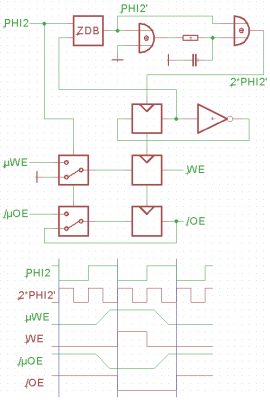

Another idea for generating the register write clock signals:
Running the microcode latch at twice the speed of PHI2:
Doubling PHI2 frequency with a ZBD (zero delay buffer) might be possible, but CY2302 only can generate 133MHz max. when driving a <15pF load, we would have to find a faster ZDB...
..or to creatively use XOR gates for doubling the output frequency of the ZDB like in the picture above.
74AUCH16374 clock is specified 250MHz min., implementing the microcode latches with that chip would limit PHI2 to 125MHz, not sure if that's a good thing.
Since one microcode latch output only drives the clock input of one register chip (not much capacitance), using PotatoSemi PO74G374 here might be an option.
Placing an AND gate in front of the microcode latch input to make sure that WE0 only can be high in the first half of the PHI2 machine cycle:
Of course, one could use a fast 2:1 FET switch instead of the AND, but plenty of 74AUC2G53 chips with the select pin tied to PHI2 won't be a good thing (PHI2 capacitive load).
There are bigger chips designed for switching bus systems, containing 16 2:1 switches or such.
Renesas\IDT IDTQS3VH16233 probably would be too slow, maybe TI has a similar chip, PotatoSemi PO3B40A looks interesting.

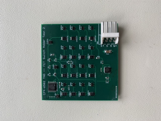

I’m beginning to get more comfortable with these diminutive package sizes. Here is the task for today:
Top left is a TSSOP16, with rows of SC70-5 and VSSOP8 packages below that. Bottom center is the footprint for the VQFN with the thermal vias (this is the new experiment for today). The tiny spec above the LED on the left is an 0402 cap which will be soldered to the underside of the board. I ordered lots of those as they immediately disappear on the carpeted floor if I drop one. :)

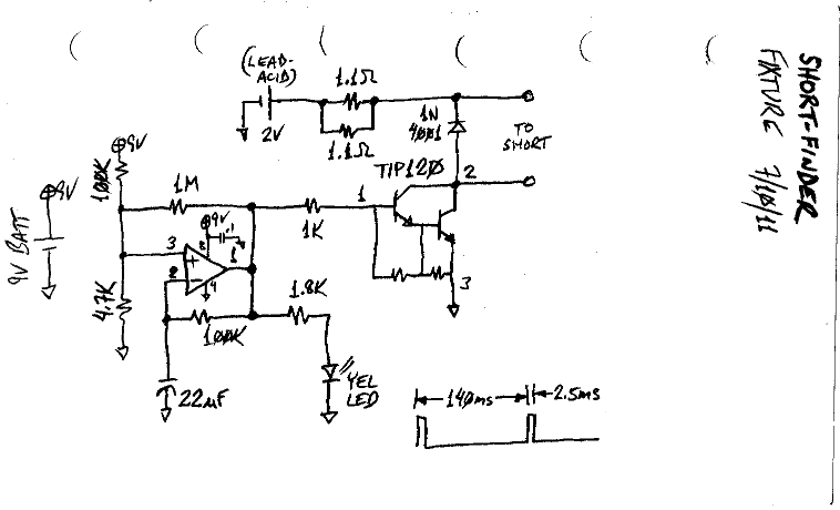

It’s populated, but there is a VCC to GND short somewhere ... and I can’t find it! :evil:
A dozen years ago I had this idea to find that kind of shorts. Below is the schematic. You use the oscilloscope on a a scale of just a few mV per division; and the high current peaks (which are too brief and low-duty-cycle to hurt anything) will develop a voltage across any length of traces or even across planes. You probe around and when you get to where the voltage drop is the lowest (hopefully zero), that's where the short is. I used a 2V lead-acid cell to be able to give plenty of current in the peaks. (The two 1.1Ω ohm resistors in parallel, ie, .55Ω for the pair, limit the current to a little under 4A. I used 1.1Ω because that's the lowest I had in my own stock. The exact value is not critical at all. The current will actually be a little lower than the 4A because of resistance in the transistors and other parts of the circuit.) A 1.5V battery with a big capacitor across it should be able to do the job as well. The unlabeled resistors shown around the transistors in the Darlington pair are just what's inside the TIP120 which is is a TO-220 case.

Thanks for the tip Garth. This looks like a real time-saver. I’m going to have to study it a bit for next time. (I normally stop to test for shorts after soldering a few components — got lazy this time and it bit me. Having a way to narrow down shorts like this would sure help).

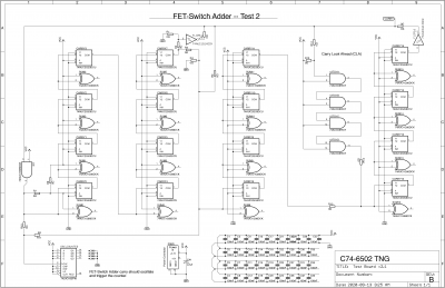

For today’s problem, I still couldn’t find the short after much sleuthing. I finally just resorted to replacing components somewhat randomly until the thing worked. I’m still not sure what the problem was, but it’s working now, so I’m just going to chalk it up to Murphy.
Ok, now for the test!
I had just enough time to test out the 8-bit carry chain. To configure the board for the test, jumpers R2, R4, R5, R7, R10, R13 and R15 were fitted. Here is the schematic once again for reference:
In this setup, the oscillation of the carry chain includes the switch-time of the first FET Switch, so it accurately reflects the transit time as it would be used in the Adder.
I ran the test at various operating voltages to see what would happen. The normal operating voltage for AUC logic is 2.5V, the Recommended Maximum is 2.7V and Absolute Maximum is 3.6V. Once again we measure pin 11 of the 74LVC163 counter which is a divide by 16 function. We are looking for a 6.5ns tpd to the output carry in order to meet the target. Here are the results:
  • @2.5V, 4.25MHz * 16 = 68MHz. 1000/68 = 14.7 / 2 = 7.35ns tpd
  • @2.7V, 4.65MHz * 16 = 74.4MHz. 1000/74.4 = 13.4 / 2 = 6.72 ns tpd
  • @2.8V, 4.87MHz * 16 = 76.9MHz. 1000/76.9 = 13 / 2 = 6.5ns tpd
  • @3.3V, 5.45MHz * 16 = 87.2MHz. 1000/87.2 = 11.47 /2 = 5.73ns tpd
So, a mixed result once again. The good news is we now have an 8-bit adder with a 6.5ns tpd. The bad news is that it only achieves that speed beyond the recommended maximum voltage for the ICs it uses (2.8V vs. 2.7V Recommended Maximum).
In truth, I’m not altogether certain what impact pushing the voltage actually has on the ICs. The test ran just fine at 3.3V, albeit with perceptible warming. But perhaps the ICs would be damaged over time? Is 2.8V likely to hurt the ICs? What about 3.3V?
Alright, I have a number of other tests to run on this board, including trying to figure out whether a 16-bit incrementer will be fast enough. That test will include the VQFN AND gates for the carry lookahead, so I’m excited to see what happens. But, I’m out of time for today. We’ll have to wait and see ... :)
Cheers for now,
Drass

Alright, I had a chance to do some surgery ...
This is to double up the driver at the input of the carry-chain, as Jeff suggested. To do so I stacked another SOT23 gate on top of the existing driver on the board. (I didn’t have another AND gate, so I used an XOR gate and tied one of the inputs to GND with a little patch cable. It’s a mess but it did the job). :D
The rationale here is that AUC logic has relatively weak drive: 9mA as compared to 24mA for LVC. Doubling up the drivers will add a tiny bit of capacitance on the input, but the reduced tpd though the FET switches should more than compensate for that and tpd overall should drop. At least that’s the theory.
Now, recall that we are looking 6.5ns or less here. We measure the frequency of oscillation divided by 16 and calculate the tpd through the 8-bit adder at various voltage levels. Here are the results:
  • @2.5V, 5MHz x 16 = 80MHz —> 6.25ns
  • @2.7V, 5.54MHz x 16 = 88.64MHz —> 5.64ns
  • @2.8V, 5.65MHz x 16 = 90.4MHz —> 5.5ns
  • @3.3V, 6.14MHz x 16 = 98.24MHz —> 5.08ns
Hurray! :!: The additional drive has done it, and we even have a reasonable safety margin. Dieter’s FET Switch Adder as enhanced by Jeff is a winner! :D
I will run further tests on the 16-bit incrementer when I get a chance, and it may yet make sense to make further improvements to the adder. For now I’m delighted with this result.
Drass.

PostPosted: Tue Sep 29, 2020 9:12 pm
Urk! This description and the photo you posted are creating, how shall I say, an unsettled reaction in my tummy (!). But I won't argue with success -- nice work, Drass! :P
In case anyone has forgotten how darn small these gates are, have a look at the photo upthread. :shock:
