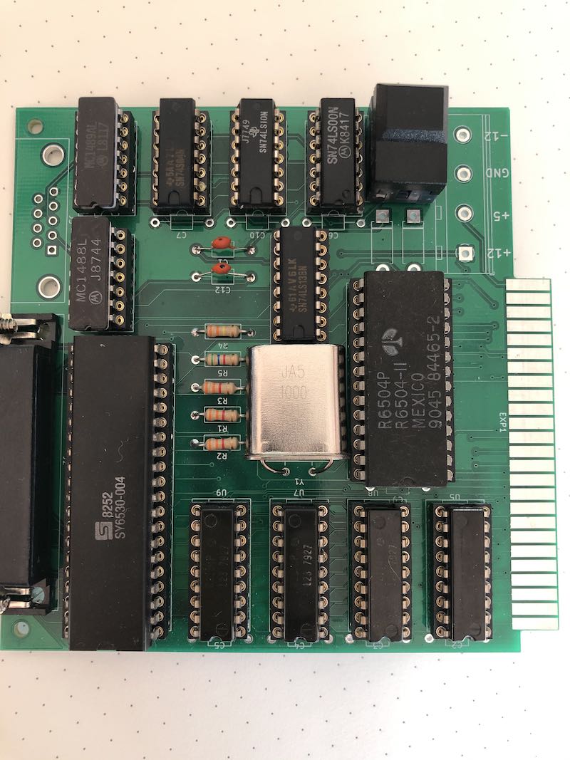

So I've been waiting for things to arrive. In the current circumstances this has been very frustrating with things taking much longer that I thought. I've got most of the parts apart from the bypass caps, two diodes, DB-9 connector and the power connector. The one that I was most worried about was the crystal. It appears to be really hard to get a 1 MHz crystal now. Of course anyone today would be better off with an oscillator, and probably a faster one that 1 MHz, but this is what the TIM-1 suggested schematic had, so I went with it. I also wanted a large one like was used at the time, and designed the PCB with a HC49/U footprint. In the end all I could find was a HC51 crystal (which was also quite expensive). It's just arrived and it is huge, luckily it just fits in the space, but only just.
File comment: Huge Crystal
So back to waiting for parts now. Then see if it goes or blows.

However, the old 2114 RAMs present a timing complication, because it's quite possible to have a glitch on the /CE line while the address lines are changing and /WE is asserted. You therefore want to have a Phi2-qualified /WE signal to the RAM (but not to the 6530), to prevent writes to other locations potentially corrupting RAM. This requires another pair of 2-NAND gates (or one 2-NAND and an inverter). It's up to you whether you want to use one '00 and one '04 (using only half the available gates on each), or two '00s (leaving two gates spare).
I may have gotten this wrong too.
Looking at the timing diagrams to confirm, I want WE to only be low when PHI2 is high, which means I want !(R/W) NAND PHI2.
What I have built is !(PHI2 NAND R/W), which in english means WE is low when either PHI2 or R/W is low, so basically in the wrong clock phase.
More blue wire I guess...

I am a little stuck now. The good news is that everything I have investigated appears to be working, but still no serial output. I only have 8 channels on my logic probe so I can't look at the entire address bus and data bus at the same time, so there is a bit of guesswork involved. Also I don't have a single step circuit which would be helpful. But the CPU appears to respond to serial input, which is a good sign. The advantage of the 6530 TIM chip is that it does almost everything, but the problem with that is it's harder to look inside.
It looks like the CPU is running, and reading the ROM as I can match up the reads and writes to the listing, right up until BRK is executed which should use the interrupt vector to jump to the start of the monitor. I can see 8 writes where it's copying the vectors into RAM in a small loop, and then three quick writes where it is zeroing some variables using 3 STX's in a row. Then it should output a CR, after saving all the registers. But it doesn't get that far.
I had convinced myself that I had the serial lines inverted from what the ROM was expecting, but when I changed them over it seems to be worse rather than better, so maybe that was a mistake.
I feel like I'm very close to having it working, but not there yet, and the hours are mounting up. And the blue wires too actually.

At one stage I was thinking this is a very humbling experience. I'd discovered about three simple mistakes in a row then. But now I can report...
It works!
As I almost could have guaranteed it was a simple error. At one stage I removed 2 of the 4 RAM chips on the assumption that the simpler it was the better, and I wanted to swap RAM around just in case I had a faulty chip. So I removed the two rightmost chips, possibly assuming that they were in the same order as on the schematic. It turns out I needed sockets 1 and 3 to be filled, and as soon as I did that, away it went. this is of course after fixing the other errors.
It's not too bad for errors really, this is what I found:
1. The 74LS138 inputs were connected in reverse order.
2. One connection was missed because it touched on the schematic but wasn't actually connected, so the DRC check didn't pick that up.
3. Got the write qualification logic wrong for the RAMs.
4. I have a break in the 5v connections somehow, I don't know what this is, and feel like it developed after initial connection, but it probably was there all the time and is another hazard of KiCAD, you can have islands of connections that are not all connected together and it doesn't raise an error.
I have enjoyed using KiCAD in general though, and it has been helpful in the debugging phase to trace PCB signal paths.
The board appears to be very slow, but then I remembered it is running at 300 baud.
I have a USB to parallel cable that I intend to try and get working as a fast download system. My DB25 connector still hasn't arrived so that will probably wait for a bit. And one other plan was to build an (E)EPROM programmer expansion board to actually make this useful. But just today I receive two brand new R65F11 chips in the post, so that could be the start of a new project.
I'm off to have a play with it now.

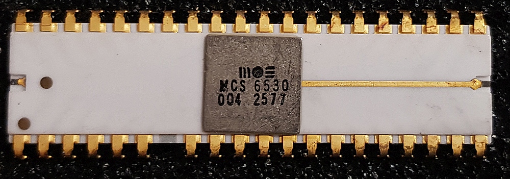

FWIW:
I started reconstructing the 6530-0x and used a "TIM" as victim to be slaughtered and cooked in acid:
See also here:
https://www.patreon.com/posts/tim-had-bath-in-50259557
PostPosted: Wed Apr 21, 2021 8:45 am
That's come out nice and clear. Looks to me like it will be necessary also to remove the metal - would you agree?
PostPosted: Wed Apr 21, 2021 12:08 pm
Posts: 91
Yes... the metal will be etched next week.
PostPosted: Fri Apr 30, 2021 1:17 pm
Posts: 91
Like this:
