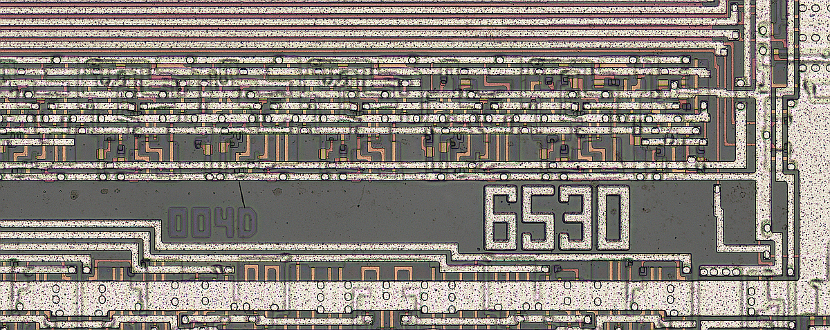

I started reconstructing the 6530-0x and used a "TIM" as victim to be slaughtered and cooked in acid:
See also here:
https://www.patreon.com/posts/tim-had-bath-in-50259557
Re: [Contest] TIM history
That's come out nice and clear. Looks to me like it will be necessary also to remove the metal - would you agree?
fhw72
Posts: 98
Joined: 20 Jul 2017
Post by fhw72 »
Yes... the metal will be etched next week.
fhw72
Posts: 98
Joined: 20 Jul 2017
Post by fhw72 »
Like this:
