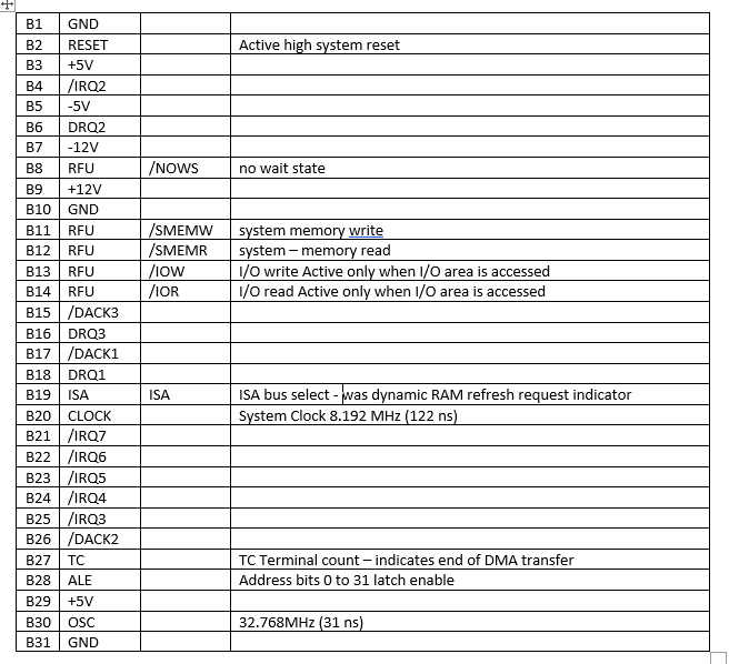

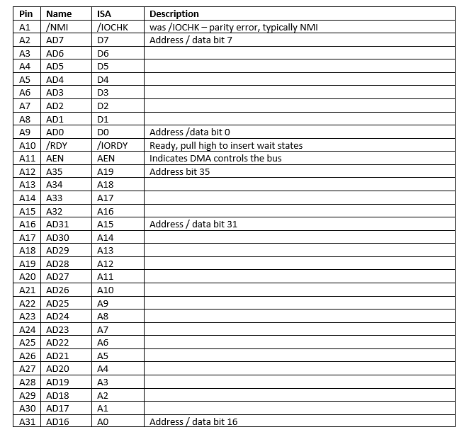

I’ve been planning on using an PC ISA bus backplane for a 65816/65832-style computer. The ‘832 would be located as an ip core in an FPGA carrier board. The ISA bus will be repurposed with 40 address lines and 32 data lines in a multiplexed address / data fashion. However, when the /REFRESH signal is high it will be used to indicate an 8-bit ISA compatible access. This allows 8-bit ISA cards to be used by the computer. For a new style bus access /SMEMR, /SMEMW, /IORD, /IOWR will be inactive, but /MEMR, /MEMW in the extended bus will be active.
Unfortunately, there are not enough I/O’s on the FPGA board to support the full ISA bus as desired. So, I’m left with trying to come up with a means of multiplexing I/Os to support everything. There are about 50 I/Os available.
24 address + 16 data takes up 40 I/Os. Also needed are reset, read/write, and ready. One idea is to have IRQ’s and DMA lines multiplexed onto the data bus periodically so they can be sampled when safe to do so. This would require inserting an extra clock cycle every few bus cycles. Rather than having IRQ’s respond at the beginning/end of an instruction it would end up every fourth instruction for instance.
A second possibility is to use fast shift registers to read the IRQ / DMA signal lines. This is appealing because multiplexors on the data bus are then not required. It may also offer lower latency than the previous idea.
I think I’m just going to have the processor read a specific address to get at the interrupt / DMA request lines. So, periodically the core outputs $FF…FFFC as the address. This address is internally decoded to form a select signal /IDS. So for one osc period (31 ns) /IDS will be active and the interrupt / DMA signals placed on the data bus. There will be a control register in the processor to specify the frequency of IDS in terms of bus cycles. Since a bus cycle is 122ns IDS would consume 20% of the bus bandwidth if active on every cycle.

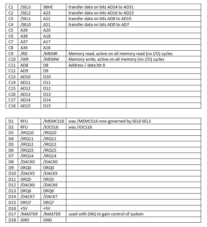

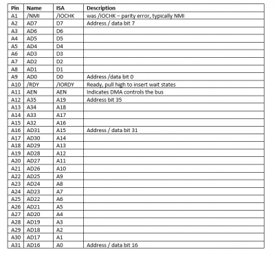

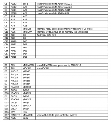

PostPosted: Sun Aug 02, 2020 12:59 pm
Posts: 460
Bus Signals
File comment: Bus Signals 'A'
File comment: Bus Signals 'B'
File comment: Bus Signals 'CD'

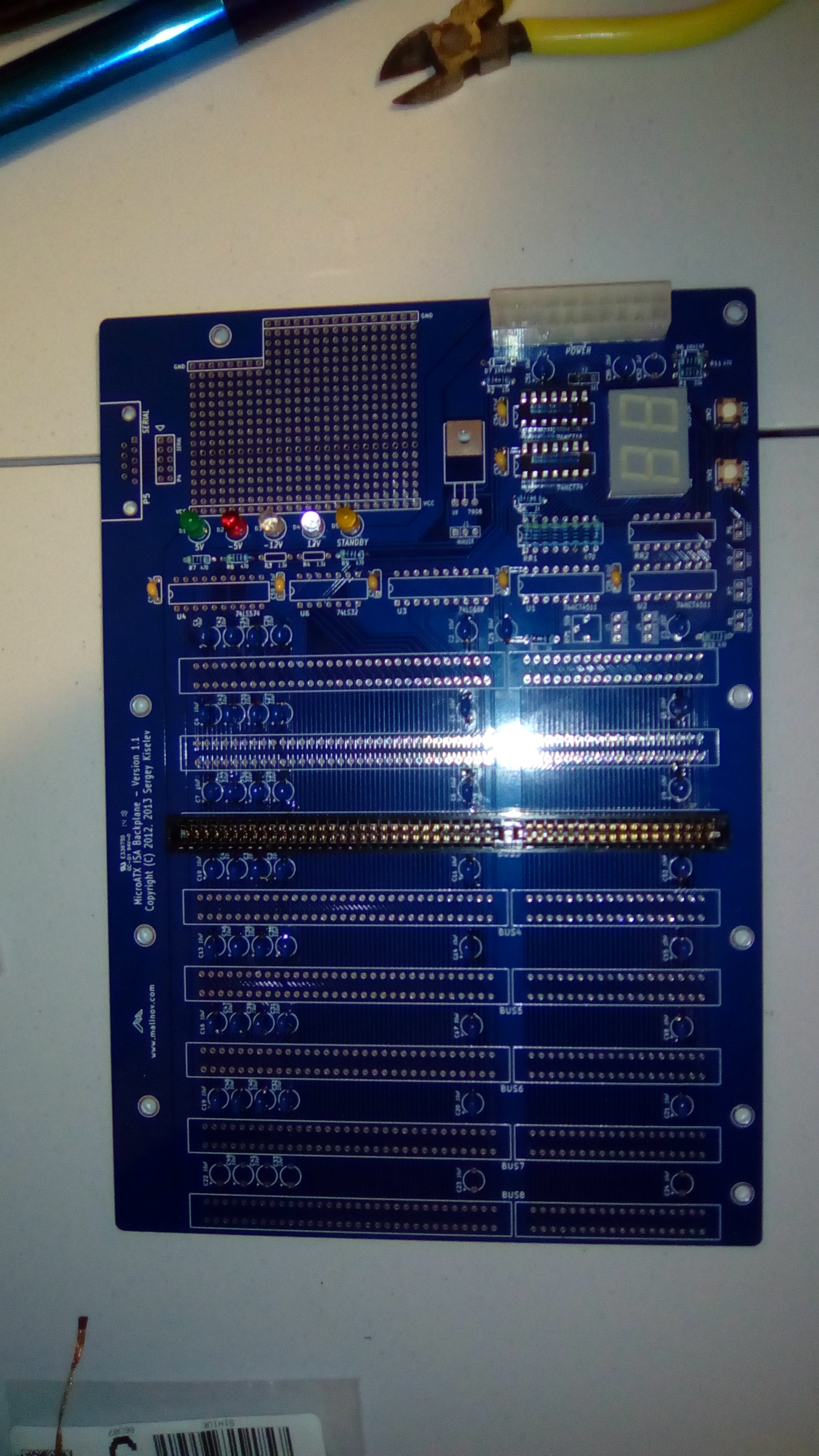

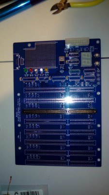

After last night’s diversion, I started working on the bus interface unit for a 64-bit core. Everything for this project seems to be revolving around the bus at the moment. With a good bus interface unit, a number of different processing cores could be interfaced. It’s somewhat tricky as the interface has to provide access to both an external system bus and internal bus, so there’s some code replication. The external bus is a multiplexed address / data bus, Data bus is 32-bits. The internal bus is non-multiplexed, 64-bit data. It’s made trickier again by the need to support both data and instruction access. And again by the need to support dram access as well as ordinary access.
The bus interface unit also takes care of unaligned access by running multiple bus cycles, and takes care of sign extending read data.
There may be issues with unaligned access read / writes spanning a 4GB boundary depending on how slaves are implemented. The upper 8-bits of the address (32 to 39) outputs the previous value when data is placed on the databus. This may not be the current value if this part of the address bus incremented due to a 4GB boundary crossing. If the slave is using ALE to latch these address bits it doesn’t matter it’ll get the correct address, however if the slave assumes these address bits remain the same and doesn’t latch them then it will have an effect.
The module is about 560 LOC.
File comment: Pic: ISA Motherboard partially built

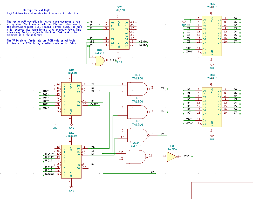

Spent some time studying and coming up with a circuit interfacing interrupts for an '816 processor.
In emulation mode interrupts are handled via ROM vectors as normal. The interesting part occurs for interrupts handled in native mode.
The encoded interrupt level (one of sixteen) is used to form part of the vector address. Vector targets are spaced four bytes apart. This
then gives a target area of 64 bytes. The upper 8 bits of the vector address are stored in a latch. This allows any page in the lowest 64k
bank of memory to be used as a target address.
Bits 6,7 of the vector are fed from an external eight-bit addressable latch which serves multiple purposes.
I think the following circuit should work. (Sorry about the color, I haven't figured out how to get the CAD program to output mono.)
File comment: ISA65816 Interrupt control logic
http://www.finitron.ca
PostPosted: Mon Aug 24, 2020 7:34 am
Posts: 362
It looks to me like you took a screenshot of the Kicad schematic window?
If you instead go to File -> Plot, you can create a PDF of the schematic, and one of the options is "Output mode" (Color | Black and white).
Then you can either attach the black & white PDF directly, or you can take a screenshot of the open PDF if you only want to show a subset.
