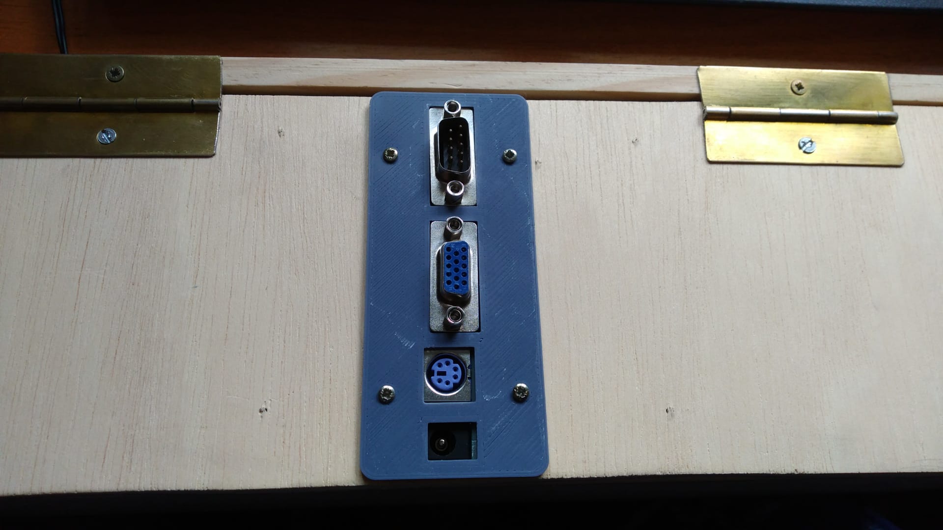

Here is some misc progress, I thought I separated things a bit:
Not much luck with EhBASIC, so I finished up the case to feel that I've got something done. I've made a board for all the external connectors, throwing in a DB9 in case I add a serial port later. This board also houses a 7805 voltage regulator that powers the whole thing. It was getting a bit hot, so I added a couple diodes on its input to drop the voltage from 9V comming from a wall-wart to about 7.5 V which is more manageable. The whole thing takes about 500 mA. It seems to be doing the business. Certainly better than wires hanging here and there.
I've also added a "dust cover" of sorts that flips open with a pair of hinges. See photos below:

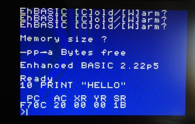

So, regarding BASIC:
I've spent quite a lot of time reading EhBASIC's source and chasing things around. I just can't find the things I want... I like to comment my code delimiting the major parts, I can figure out the details if I need to. But I just find details and not the general flow of things on the BASIC source...
So here is what I've done so far:
On the BASIC source I've changed the following line:
Ram_top           = $6F00     ;= $C000     ; end of user RAM+1 (set as needed, should be page aligned)
And assembled it on the Kowalski simulator.
I wrote a couple routines to match what the mim_mon.asm example does. (Or I think it does). I only "initialized" INPUT and OUTPUT vectors, as I'm not doing anything with LOAD, SAVE or interrupts just yet.
;*                EH BASIC ROUTINES                   *
;###############START######################
basicStart:   lda #lo basicIn    ;INPUT VECTOR
         sta $205
         lda #hi basicIn
         sta $206
         lda #lo basicOut ;OUTPUT VECTOR
         sta $207
         lda #hi basicOut
         sta $208
         ldx #$ff ;RESET STACK
         txs
         printMacro "\nEhBASIC [C]old/[W]arm?"
bSKb:      lda kbBuffer
         beq bSKb
         ldy #$0
         sty kbBuffer
         cmp #'W'
         beq doWarm
         cmp #'C'
         bne   basicStart
         jmp coldStart
doWarm:      jmp warmStart
;###############INPUT#####################
basicIn:   lda kbBuffer
         beq bIEnd ;No key
         pha   ;Clear buffer
         lda #0
         sta kbBuffer
         pla
         sec
         rts
bIEnd:      clc
         rts
;############OUTPUT#######################
basicOut:   jsr vgaTerm ;Pla affects N and Z
         rts
basicStart is called by the monitor with the 'B' command.
I moved the monitor and I/O code to $F000, reduced the zero page use to a minimum, so the monitor only uses $e2 to $ee, which are said to be unused in the BASIC source, and moved the monitor's input buffer to the top of RAM, out of the BASIC area (That is $6F00...$6FFFF).
I also modified the monitor so upon a BRK it shows the program counter and registers, and also has ability to continue after the BRK, to aid in debugging. At this rate, my monitor is going to be pretty powerful by the time I get BASIC is running...
So, after joining basic and my monitor on the EEPROM programmer software, and programming the ROM, here is what happens:
I do get the Memory size ? prompt. Writing a number sometimes results in it giving a sensible output, others it gives random letters in place of the number of bytes free.
If I press CR, it goes on to detect how much memory is available. Sometimes it gives a number (not always the same one), others more random letters. (Which, in case it makes a difference, have bit 7 set).
Ignoring all this, if one types LIST or RUN, it responds with the usual "ready" as no program was entered.
Entering something like PRINT "HELLO" does in fact print HELLO, but actually trying to store a program in memory with line numbers does not. For example, after 10 PRINT "HELLO" and CR, it either executes a BRK and goes back to the monitor, or gets in an infinite loop. See "screenshots" attached.
I'm using the version of EhBASIC with the decimal mode patch, as my CPU does not have decimal mode.
So character input/output is working, but not much else. I don't really know what to to with this. One might suspect monitor and BASIC zero page overlapping or something, but I made sure I'm only using the bytes marked as unused on the source.
I read on this thread: viewtopic.php?f=5&t=5036 that $14 - $5A was allegedly free as well.
Any insight is certainly welcome.
Again, I'm not sure if I should post this here or create a separate thread on the EhBASIC sub-forum. I may try something like tiny Basic that I can perhaps understand more easily.
Juan

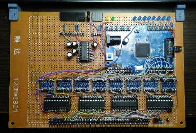

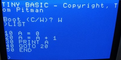

Everything is working fine now!
I tried Tiny BASIC from here https://github.com/jefftranter/6502/tre ... /tinybasic, and it was sometimes running fine, but then it would stop with an error. When listing the program, some characters had changed. So RAM was playing up again.
I just received 100 1n5817 Schottky diodes, so I added those to the address bus right on the RAM pins, where quite some overshoot and undershoot was observed. Now signals look cleaner and everything seems to work fine. I had the simple program shown below running under Tiny BASIC for about three hours without issue. (The four byte integer overflows, but everything works)
Now EhBASIC seems to work fine too. Now I have to learn a bit of BASIC to do something useful with it, and allow the keyboard subroutine to accept symbols like []{}+* and such, which is quite something. I also have to work on Ctrl+C, now it takes me back to the monitor, but it should go back to BASIC.
Juan
