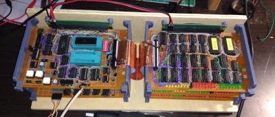

I've added the copper foil as can be seen below. Its just a test, I can peel it off anytime. Adding it does make "scrolling errors" disappear.
The IDE cable follows the pinout of a 6502. I've just realized that I have some unused pins: of the 3 NC, I'm using one for the "Valid address", and SO is free too as I'm not implementing it. These are reasonably close to the clock pins, and the R/W line. So I will be wiring those to ground. They won't be side to side, but one conductor apart. R/W line is already right next to VCC.
There was other error that became more frequent, the Interrupt disable flag would just remain 1 after exiting the ISR. Probing with the logic analyzer, I found that it changed when it shouldn't. Probing the flag prevented this from happening (My logic analyzer has an input impedance of 100K), but probing it with the scope didn't make a difference. I added thicker power and ground wires to the backplane and problem solved. I also had a couple unused pins on the CPU bus, and I connected one of them to ground too. This way cards have ground connections on both sides.[These two unused pins were reserved should I need to implement the b flag, which is not there, I don't know if I will need it any time soon. Should be able to do it with the remaining one.].
Later, I added a thick ground wire on the perimeter of each of the CPU cards. Not sure if id actually does something, but it doesn't hurt.
Next (and hopefully last) issue is that it randomly resets itself, but only when typing on the keyboard. I thought it was a software issue, but after some measurements I now think it's a hardware thing. Needs further investigation.

PostPosted: Mon Jun 01, 2020 6:05 pm
Posts: 8464
About terminations: refer to my recent post at viewtopic.php?p=76261#p76261 .  There are no transmission lines in your pictures though, so resistor terminations will probably not do any good.  Diode terminations could help, but fast-enough ones are rare.  The tiny static-protection diodes at the inputs of CMOS logic will provide some protection from overshoot though.
Something that's much, much better than a thick ground wire around the outside (which is what I think I'm seeing in your pictures) is to have a grid of power and ground wires.  Remember that even a plain wire has inductance, and even doubling or tripling the wire size has very little effect on that inductance; so you want to keep the power and ground connections from one IC to another as short as you can.  That includes not requiring a signal's return current to go out to the edge of the board and way around to cut in somewhere else, if a 1" piece of wire between the ICs could have made the same connection.  See the links at the bottom of the AC-performance page of the 6502 primer, at http://wilsonminesco.com/6502primer/construction.html .
That link redirects me to this thread. I think you meant this one viewtopic.php?f=4&t=5865&p=76205#p76205.
I'll do some reading on the subject. There are no "intentional" transmission lines in my design. I'll take some scope screenshots of the signals I'm observing.
Something that's much, much better than a thick ground wire around the outside (which is what I think I'm seeing in your pictures) is to have a grid of power and ground wires. Remember that even a plain wire has inductance, and even doubling or tripling the wire size has very little effect on that inductance; so you want to keep the power and ground connections from one IC to another as short as you can. That includes not requiring a signal's return current to go out to the edge of the board and way around to cut in somewhere else, if a 1" piece of wire between the ICs could have made the same connection. See the links at the bottom of the AC-performance page of the 6502 primer, at http://wilsonminesco.com/6502primer/construction.html .[/color]
There is a grid of power and ground wires on each card as well. It's wired with regular wire-wrapping wire, and can be seen on the photo above. I just added that thicker wire on top to see if it helped, maybe the LEDs were causing some voltage drop on GND. It did make a difference on the power rails on the backplane. Voltage drop may be more of an issue there.

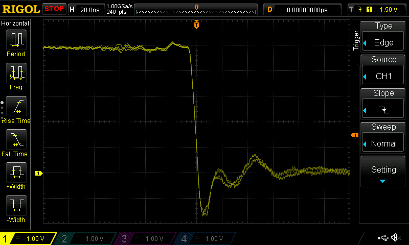

Some updates:
A couple measurements with the logic analyzer confirm that reset happens either after an RTS or an RTI, so its due to errors getting the return address back from the stack. Here are some scope screenshots of the signals that I'm observing. Using the probe's ground lead or the low-inductance-ground-springy-thing (scope probe accessory) makes little difference.
As it can be seen, address lines do have a shorter rise time and that causes ringing and what not. Data lines are better behaved, which is curious, as data lines are driven by a 74HC245, which is supposed to have greater driving capability than the 74HC377 that drives address lines. I don't know if this directly influences errors on reads/writes, but it may very well be.
Using Schottky diode termination seems to work. I don't have enough diodes for all lines, some more are on the way. But maybe I could just add some series resistors on the address lines (CPU side) so together with the bus capacitance they slow down those edges. I've solved crosstalk on slow signals with fast edges that way before.

File comment: Slower rise time. Signals look nice and clean. Driven by 74HC245
File comment: Faster rise time. Overshoot and undershoot. Driven by 74HC377
File comment: Using the ground springy thing.
File comment: Adding a schottky diode to ground reduces undershoot. Using the ground springy thing.
File comment: Not sure if the blue trace causes the yellow one, but nasty stuff.
On the '245 (unlike the '377) the rise/fall time of the outputs will to some extent depend on the rise/fall time of the inputs -- perhaps they, too, are fairly slow. And is the capacitive loading on the 377 comparable to that on the 245?
I'm not sure what you're referring to when you mention the "ground springy thing." Is that the copper foil you applied to the ribbon cable?
