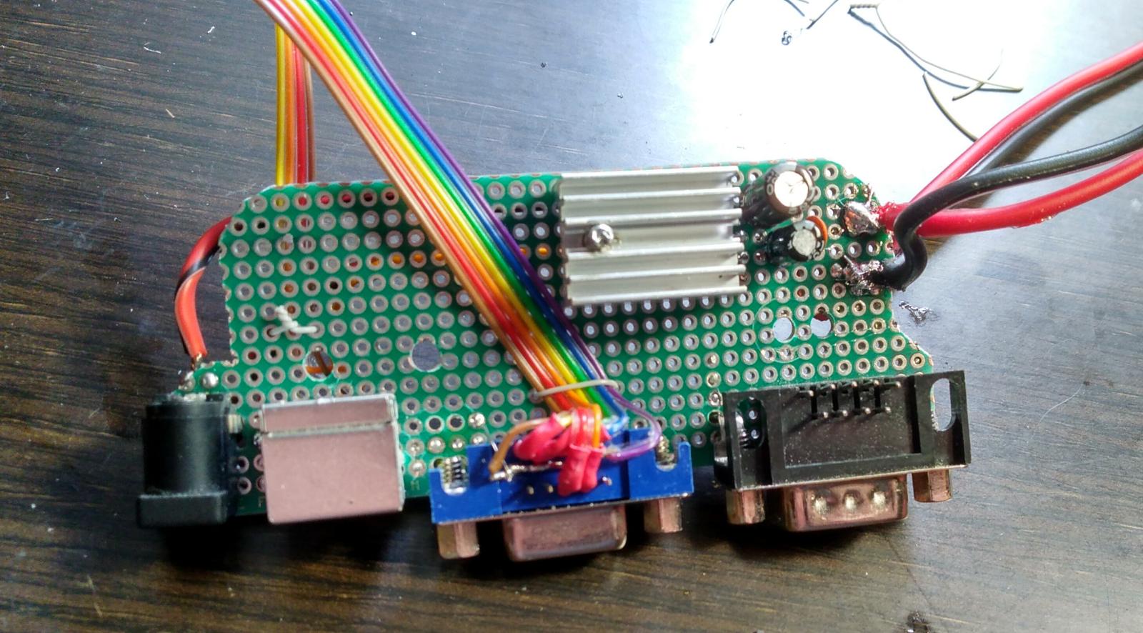

Here is some misc progress, I thought I separated things a bit:
Not much luck with EhBASIC, so I finished up the case to feel that I've got something done. I've made a board for all the external connectors, throwing in a DB9 in case I add a serial port later. This board also houses a 7805 voltage regulator that powers the whole thing. It was getting a bit hot, so I added a couple diodes on its input to drop the voltage from 9V comming from a wall-wart to about 7.5 V which is more manageable. The whole thing takes about 500 mA. It seems to be doing the business. Certainly better than wires hanging here and there.
I've also added a "dust cover" of sorts that flips open with a pair of hinges. See photos below:

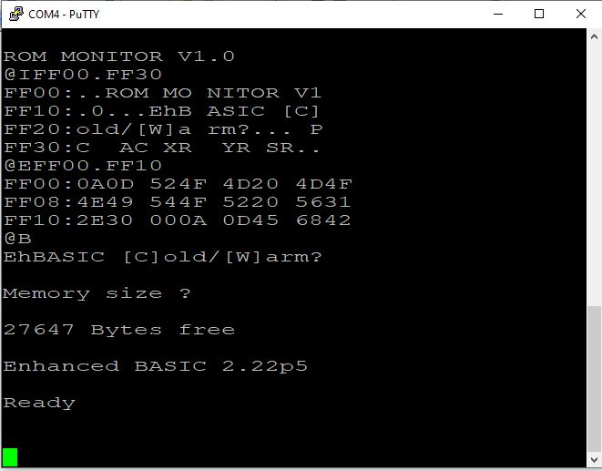

So, after joining basic and my monitor on the EEPROM programmer software, and programming the ROM, here is what happens:

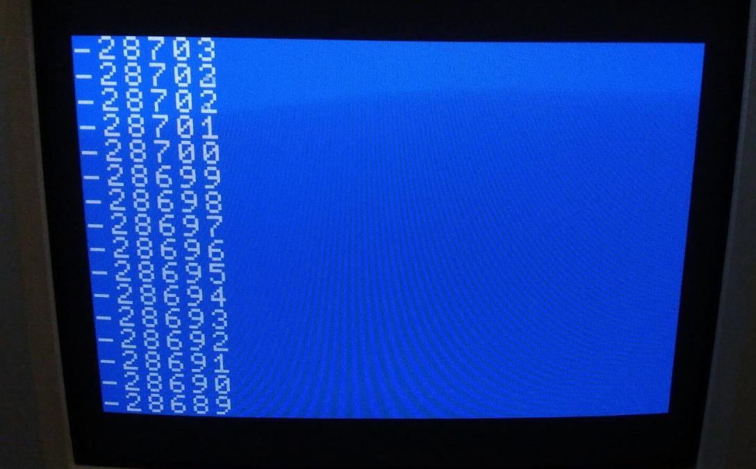

I do get the Memory size ? prompt. Writing a number sometimes results in it giving a sensible output, others it gives random letters in place of the number of bytes free.
If I press CR, it goes on to detect how much memory is available. Sometimes it gives a number (not always the same one), others more random letters. (Which, in case it makes a difference, have bit 7 set).
Ignoring all this, if one types LIST or RUN, it responds with the usual "ready" as no program was entered.
Entering something like PRINT "HELLO" does in fact print HELLO, but actually trying to store a program in memory with line numbers does not. For example, after 10 PRINT "HELLO" and CR, it either executes a BRK and goes back to the monitor, or gets in an infinite loop. See "screenshots" attached.
I'm using the version of EhBASIC with the decimal mode patch, as my CPU does not have decimal mode.
So character input/output is working, but not much else. I don't really know what to to with this. One might suspect monitor and BASIC zero page overlapping or something, but I made sure I'm only using the bytes marked as unused on the source.

Everything is working fine now!
I tried Tiny BASIC from here https://github.com/jefftranter/6502/tre ... /tinybasic, and it was sometimes running fine, but then it would stop with an error. When listing the program, some characters had changed. So RAM was playing up again.
I just received 100 1n5817 Schottky diodes, so I added those to the address bus right on the RAM pins, where quite some overshoot and undershoot was observed. Now signals look cleaner and everything seems to work fine. I had the simple program shown below running under Tiny BASIC for about three hours without issue. (The four byte integer overflows, but everything works)
Now EhBASIC seems to work fine too. Now I have to learn a bit of BASIC to do something useful with it, and allow the keyboard subroutine to accept symbols like []{}+* and such, which is quite something. I also have to work on Ctrl+C, now it takes me back to the monitor, but it should go back to BASIC.

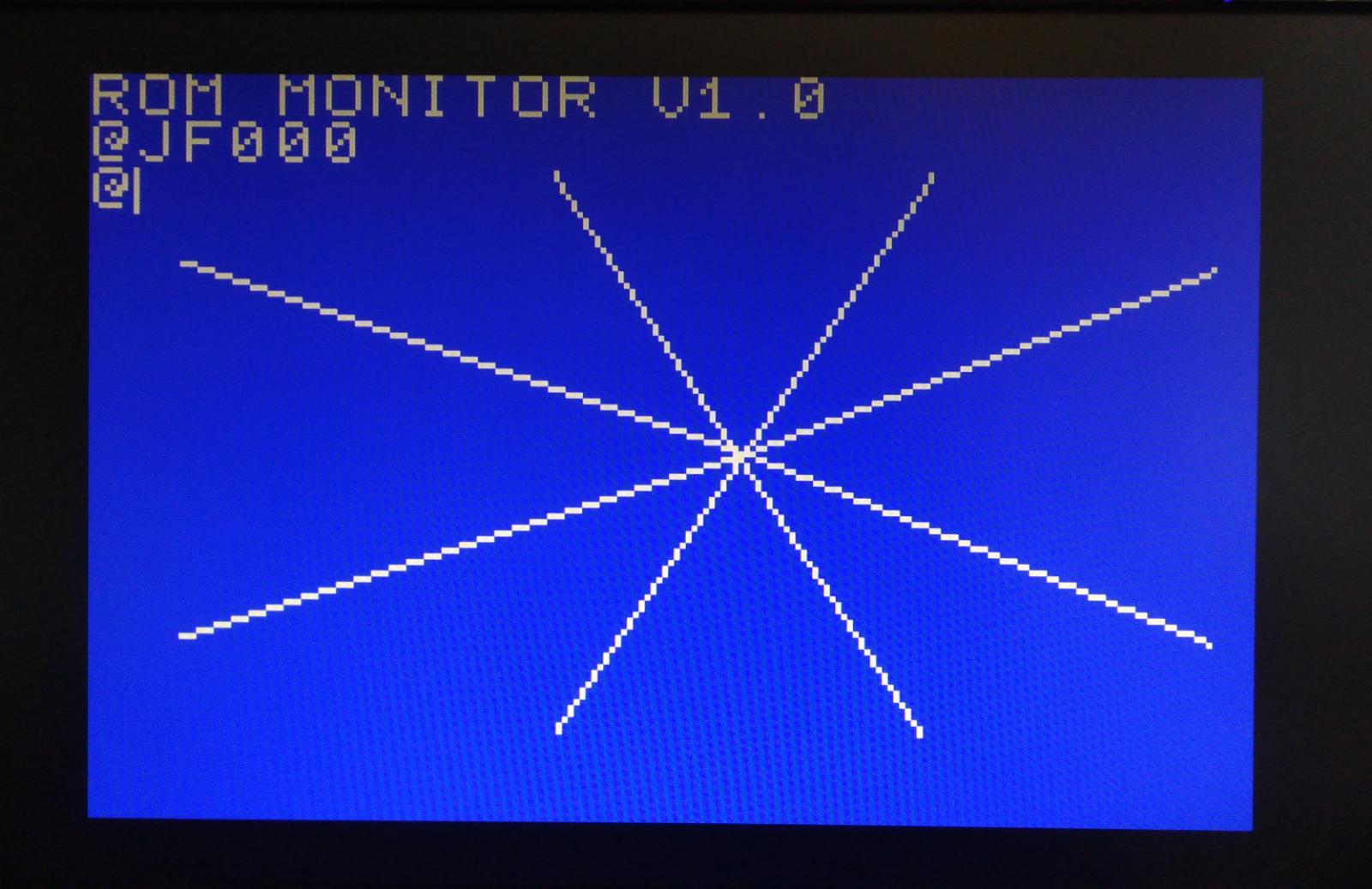

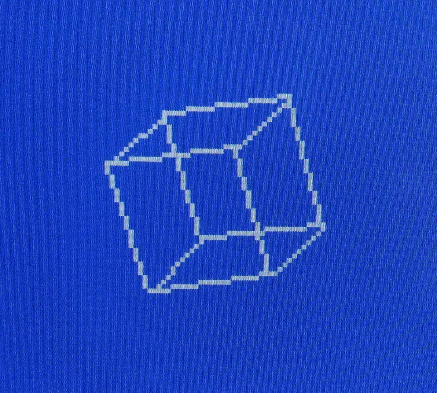

I've written a couple of routines to draw lines between two points on the screen, based on the "Bresenham's line algorithm" https://en.wikipedia.org/wiki/Bresenham%27s_line_algorithm
Wikipedia has a decent explanation and pseudo code for an implementation using only integer arithmetic. I've kind of translated that to assembly (not elegantly by any stretch). But it does work after a ton of debugging. Being able to add breakpoints and use my monitor to inspect registers has helped quite a bit. It does work now. Now I have to figure out how to call them with USR() in EhBASIC and such.

Some updates:
I've added a new heatsink for the voltage regulator as it was getting too hot. Now I can keep my finger on it for as long as I want, so it should be fine.
I've been working on the last card, the UART.
As I intended, I implemented it in a CPLD, an Altera Max II, which can be purchased soldered on a minimal development board quite cheaply, and its ideal for wire-wrapping. The downside is that it is 3.3V, so I had to use some level shifters. I had some of those bidirectional single MOSFET ones, so I used those. I added 74HC245 bus transceivers for good measure. I could have gotten away only using those on the data bus I suppose. I wired all address lines in case I want to experiment further.
I've been playing with Verilog (Learning the Art of Electronics has a brief intro to Verilog, I may later look at VDHL...) for a week, and I kind of know what does what, but a long way to go. Figured that getting an existing design up and running was enough of a challenge for a first project.
So the actual UART code I've gotten it from here: https//www.nandland.com/vhdl/modules/module-uart-serial-port-rs232.html.
I thought it would be more complex, but at the end of the day it's just a state machine.
I've written the address decoding side of things, some intermediate registers where data is stored before sending and after being received, flags and such. It can be configured by writing to a register to generate interrupts when a byte is received or when is ready to transmit again. I've used Dieter's TTL UART as a reference for this.
I had a couple problems with signals between two clock domains, phi2 and the CPLD's 50 MHz clock. Nothing a couple flip flops could't solve.
Baud rate is fixed to 1200, and I'm using the Data Terminal Ready (DTR) line to signal my laptop that the computer is ready for more data. This way I can just paste a BASIC program in PuTTY and it gets sent at the computer's pace. Seems to work fine.
Character drawing and scrolling for the graphics card can be disabled, and this speeds things up quite a bit.
I may write some routines for transferring data, but as of now, I can even use the monitor Write command to store bytes into memory directly.
I've written a simple program in BASIC that projects a 3d object made up of vertices and edges onto the screen. Line drawing is in assembly, but it's still pretty slow. When rotating a cube for example, by the time it draws it, one forgets where it was before. Still its fun.
I'm just rotating (https://en.wikipedia.org/wiki/Rotation_matrix) all the points and discarding the z coordinate.
