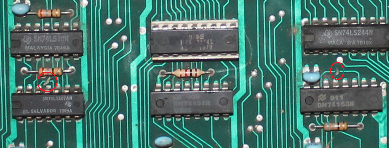

Hi again, man this board worries me. I tried again to find out why i dont have continuity to 74LS10 and i cant figure it out. I dont know how to work my way towards the issue, and i dont really know how to work my way backwards because i cannot find the trace that leaves pin 1 from 74LS10. The longer i look at the board, the more changes and fixes i find. I will attach more pictures.
For example, an chip 74LS00 i have the continuity i should. So i trace it back to 7417, just to see if i actually get the principal idea behind this exercise. On pin 1 top view of 74LS00 i see this:
I flip the board to see the back side and you see this:
The red circle are the soldered connections,
The yellow circle is a point in the line that was first cut and then a fixed again.
So this line connects to pin 25 of one of the 6522 in UC5. And i already know that pin 25 of 6522 is B-Phi2 so that sort of makes sense. I dont know if thats correct, or "valid", but this coupled with the fact that i cannot do what sounds like a pretty basic task makes me very insecure about what im trying to achieve. I know it must be extremely frustrating to try to help someone who doesnt know what hes doing.

more pictures of modifications in the attachment

PostPosted: Tue May 26, 2020 9:33 pm
In 0002.PNG, pin 1 of all the visible chips is at bottom left. Several have a big notch showing the end of the chip featuring both pin 1 and the highest-numbered pin. Two have a much less noticeable dimple next to pin 1 itself.
It's also possible that you have a revision of the PET motherboard that doesn't quite match the schematics. I'll let people more familiar with Commodore history comment further on that.

PostPosted: Wed May 27, 2020 2:49 pm
Posts: 155
Location: UK
DIL Chip pin numbering
Wikipedia page (including pin numbering).
With tracks that you can’t see, especially on a board that you don’t have a (full, any or accurate) schematic for, use your multimeter on the continuity range (that makes a sound), with one probe on the wanted pin/circuit, probe each and every track/via/component (where you have a bare conductor) that has a track that leads away from (or to) the area where you loose visual on the track you are trying to trace. Do this on both sides of the board. And include other pins of the same chip.
It’s very rare (or should be) that a track / circuit just ends without connecting to something else! So by testing everything in the area, you should have a good chance of finding the wanted track/circuit.

Yes, ordinarily that's true. But something for you to keep in mind, Commodore_PET, is this:
It's possible the previous owner of this board cut some of the traces as part of a troubleshooting effort. If they thought one of the circuit paths had a short to Gnd or Vcc perhaps then it might make sense to divide the path into shorter segments and then see which segments become clear and which remains shorted.
Having attempted such a procedure it's possible they subsequently gave up, leaving the board partially hacked.
I don't wish to distract you, as this scenario is somewhat unlikely. But it is worth keeping in mind as you attempt to reconcile the schematic with what you're actually seeing in the board itself.
