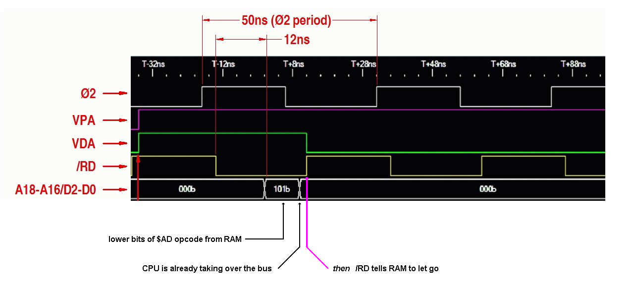

After butchering up the hardware, I hooked up the logic analyzer and capture some traces.
File comment: Executing LDA $8000 at 20 MHz
In the above, the 65C816 is executing LDA $8000 out of RAM. Prior to that instruction being executed the data bank (DB) was set to $06 so I could see when the bank bits are emitted immediately before the actual data fetch occurred. Operating conditions were Vcc=5.08 volts and the room temperature was 74° F. Prior to capturing this data, I set the logic analyzer to a 500 MHz sample rate, which produces a ±1 nanosecond resolution, the finest resolution available. The timing marks at the top of the graphic are at 4ns intervals. An artifact of the 2ns limit is the logic analyzer thinks the Ø2 clock is asymmetric. :D So take the above numbers with a small grain of salt.
What is clear from the above is there appears to be a small period of dead time after the '816 turns around the data bus following the emission of the bank address. That is one of the areas where the potential for data bus contention may arise. Also note that 12ns elapse after the fall of Ø2 before the '816 emits the bank address. That is the time a device that was driving the data bus before the fall of the clock has to get off the bus before contention will arise. Measuring some of the intervals displayed by the logic analyzer indicates that /RD is deasserted 6ns after the fall of Ø2, which reflects the prop time of the NAND gate that uses this signal along with RWB to drive /RD. When added to the RAM's response time to the rise of /OE, which has a worst-case value of 6ns, it appears the RAM gets off the bus just in the nick of time. This is a 12ns RAM, so some gain could be had with a faster part. However, the contention issue in this circuit would only arise if all parts concerned were running at the weak end of their specs.
Something else worth noting is the '816 is performing substantially better than what the data sheet indicates it should do. Firstly, I've got it overclocked by 6 MHz and it's running fine. Secondly, the above logic capture shows that even at 20 MHz, there is still a bit of timing headroom left. And don't forget I'm doing this with discrete logic, not a PLD, which means cascaded prop times are involved.
It would be nice if WDC would do a thorough job of sampling production parts with an eye to promulgating more accurate performance data. I suspect the 65C02 with its less complicated architecture and simpler bus protocol, would be even faster.

Interesting to see the contrast between the 0.6µ part and the 0.8µ part, BDD. For the sake of any of us who'd like to identify 816's in their possession, perhaps you could mention how the markings on the 0.6µ and 0.8µ chips differ -- thanks.
As for the Logic Analyzer traces, they're intriguing and also somewhat confounding, given that their interpretation has some potential pitfalls which I'll mention briefly for anyone who's interested. The LA display shows waves with crisp, instantaneous transitions, but we know that's not the reality. In fact, the voltages take some time to ramp up and down.

[regarding the contention issue] it appears the RAM gets off the bus just in the nick of time.
Again I'm not sure when is the event you mention, but I do see an event that shows cause for concern.
Unless I'm missing something, at T+8ns the RAM plainly doesn't get off the bus in time.
In my previous post, I did say to take the measurements with a grain of salt. :D Limitations in resolution coupled with some uncertainty as to when the LA thinks something is a logic 1 or a logic 0 can give the appearance of timing anomalies that aren't really there. The only thing I can offer is 1) the machine works at 20 MHz; 2) the SRAM is not as warm as the physically much-larger MPU when running the "torture" code.
We see the bus lines change from 101 to 000, which must surely be the CPU's doing. But /RD is still low, which means RAM hasn't yet been told let go. RAM and the CPU are in contention, and it appears the CPU's stronger drivers won at least a partial victory... enough to cross the LA threshold, that is. (An oscilloscope would likely reveal indeterminate voltages, neither solidly high nor low.)

I've been working on updating my string manipulation library, with testing being carried out on POC V1.2. As V1.2 has four serial I/O (SIO) channels, it's convenient for testing because I can issue commands and do debugging on the console, all the while having the program being tested use one of the other SIO channels on which to print test data. That way, the results of testing are not messed up by debugging activity. It's almost like working with a real computer. :D
File comment: Debugging with POC V1.2 Driving Two Displays
Anyhow, everything seemed to be fine until I started debugging the strins function, which inserts string S2 into string S1 at a point in S1 determined by index I (invoked with a macro, the function call is strins *S1,*S2,*I, using C notation for pointers). In order to do this, strins has to "split" S1 at the point of insertion, which is done by shifting up all of S1 beyond the insertion point by the number of bytes in S2. Once that is done, S2 is copied to the point of insertion in S1. The effect is S1 is expanded by the size of S2.
Testing with short strings seemed to indicate everything was copacetic. In order to make strins work harder, I started using longer strings and wrote a test loop that would keep feeding the expanded string (S1) back to the function for further expansion. Problems arose with this more demanding test, as periodically, S1 would be corrupted. Random bytes would appear—almost always these bytes were $00, but periodically some other values were showing up. I determined the corruption was occurring as S1 was being split. When the error occurred, it immediately became apparent there was a problem once S1 was printed after processing.
I pored over the source code looking for the error that just had to be there. I also stared at stack dumps looking for corrupted pointers or other erroneous data. I couldn't see anything wrong. Finally, I added a trap in the split code so execution would stop on a BRK if $00 was loaded into the accumulator.
I started the test loop, which ran for a couple of seconds and then stopped at the trap I had set. A check of the RAM location from which the $00 was loaded showed that $00 wasn't there; that location contained the expected test data. I repeated the test several times and each time the error eventually occurred.
Given the test results, some sort of hardware glitch was occurring, but in a random fashion. In an effort to determine what it was, I reduced the clock speed from 20 MHz to 8 MHz and repeated the test. Once again the error occurred, which eliminated 20 MHz operation as the likely culprit.
Just to prove to myself that this wasn't a software issue, I disconnected POC V1.2 and connected V1.1 (Ø2 is 14.1 MHz on that unit), loaded the test code and ran it. It ran until the test string size had maxxed out at 32,767 bytes—no errors occurred. I ran the test several times in succession and in every case, V1.1 completed it without error.
So it would seem V1.2 has some sort of hardware gremlin. The likely suspects are:
  1. Flaky RAM. Rare with SRAM—if I were using DRAM I would be replacing it before doing anything else. Furthermore, at POST, a test of RAM is performed using two different bit patterns. Surely if there was a RAM location that has a problem with retaining content an error would occur during testing—the test would abort and report the error on the console. However, the test only consists of writing %01011010 and %10100101 once per cell and reading it back. So it could be some location is okay with those bit patterns but not with other data. I would need to write a much more elaborate test to fully exercise RAM and prove that it is okay—or not.
  2. Flaky MPU. Again, pretty rare—I've never encountered a bad MPU in some 50-odd years of monkeying with computer hardware. However, there's always a first time for everything. I should be able to eliminate this possibility by swapping MPUs with POC V1.1, which completes the test code without error, thus implying it has a good MPU.
  3. Glue logic timing. I'm not sure what it could be. All logic is 74AC, with no more than two gates between any one chip select and the address bus, giving the machine ample timing headroom, even at 20 MHz. It could be I have an occasional bout of data bus contention occurring when Ø2 goes high on a fetch cycle. If that were to happen, the 816 and RAM would clash during a fetch cycle, which could explain the occasionally-corrupted byte. However, if contention were occurring, you'd think it would also occur during the fetch of instructions and operands, which should trigger some sort of gross error. That hasn't happened at any point in the testing.
Figuring this out and coming up with a solution will be no trivial matter.
