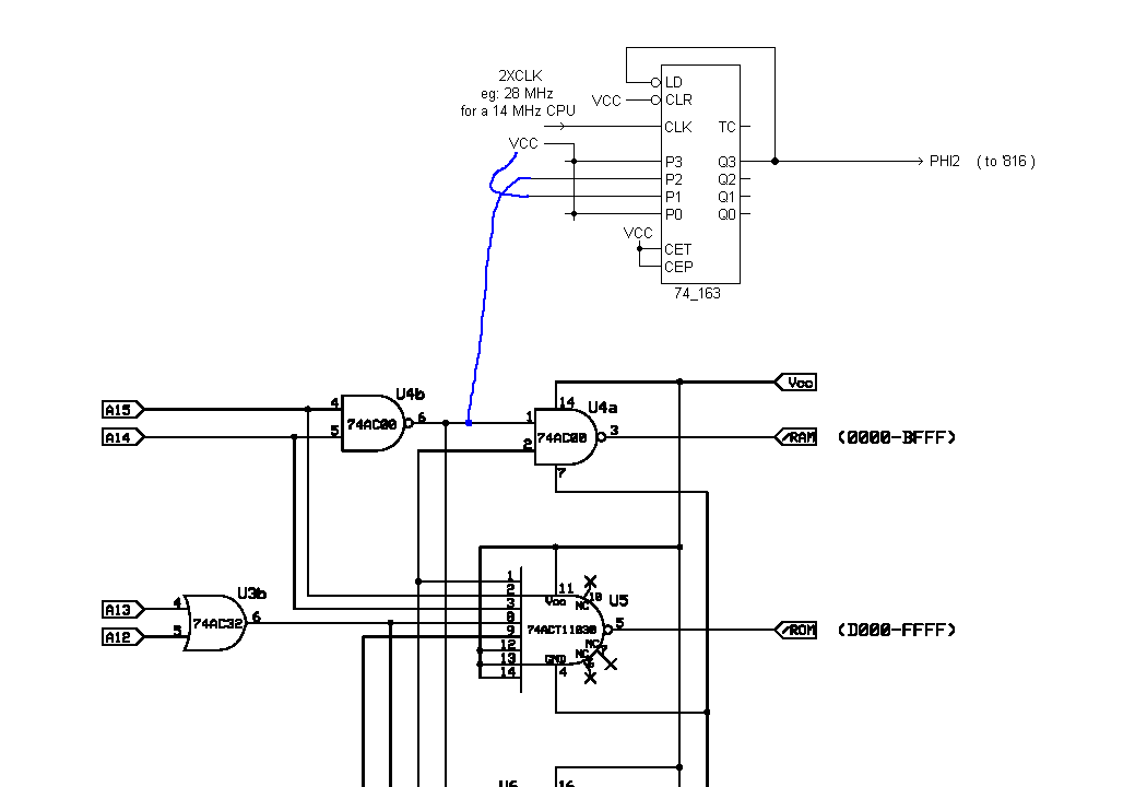

As for suggestions, the first thing, as already noted, is to ensure the ROM and RTC chip-selects go low early enough to provide some setup time for the stretcher circuit.
Next, is it possible that accesses to the DUARTs ought to have stretching? I kind of forgot about them, focusing on the ROM and RTC instead! :oops: If you change your bodge wires as shown below then everything -- all devices except RAM -- will get stretched by four extra 2XCLK periods. That's overkill, of course, but it may answer the question about the DUARTs.
Later if we're still stumped, or have gained some ground but then hit another ceiling, it might be good to consider taking Phi2 from Q2 or Q1 of the '163 rather than Q3. As you know, I talk about this in my original post in the addendum.
Right now a stretched cycle get extended quite a bit (2 or 4 extra periods of the 2XCLK), but all the stretch is applied to the Phi2-high portion at the end of the cycle. The Phi2-low portion at the start of the cycle isn't being stretched at all; it's still only 2 periods of the 2XCLK. That may be insufficient for some devices now that you're running faster oscillators. If so, the remedy is to extend the Phi2-low portion of the cycle, which in turn means the device gets a longer period of stable address (register select) before /RD or /WR goes low.
That they do. All chip selects are generated as soon as VDA and/or VPA become true. All devices are selected within two gate delays after the address bus becomes valid.
I think I mentioned a few posts back that I had monkey-rigged DUART #1 (console channel DUART) to be wait-stated. That enabled the unit to boot at 15 MHz and achieve stable operation. 20 MHz was a no-go, however, which is something I plan to investigate with the NOP ROM.
File comment: Yet Another Bodge
I made the above change per Jeff's suggestion, but bodge-wired it to generate one wait-state instead of two when accessing any I/O or ROM. I went that route because I already knew the system was stable at 12.5 MHz. With this change, POC V1.2 is able to POST and run normally at 20 MHz.

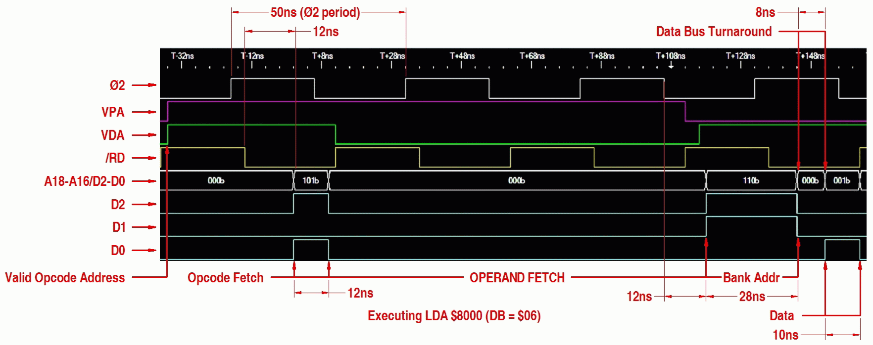

After butchering up the hardware, I hooked up the logic analyzer and capture some traces.
File comment: Executing LDA $8000 at 20 MHz
In the above, the 65C816 is executing LDA $8000 out of RAM. Prior to that instruction being executed the data bank (DB) was set to $06 so I could see when the bank bits are emitted immediately before the actual data fetch occurred. Operating conditions were Vcc=5.08 volts and the room temperature was 74° F. Prior to capturing this data, I set the logic analyzer to a 500 MHz sample rate, which produces a ±1 nanosecond resolution, the finest resolution available. The timing marks at the top of the graphic are at 4ns intervals. An artifact of the 2ns limit is the logic analyzer thinks the Ø2 clock is asymmetric. :D So take the above numbers with a small grain of salt.
What is clear from the above is there appears to be a small period of dead time after the '816 turns around the data bus following the emission of the bank address. That is one of the areas where the potential for data bus contention may arise. Also note that 12ns elapse after the fall of Ø2 before the '816 emits the bank address. That is the time a device that was driving the data bus before the fall of the clock has to get off the bus before contention will arise. Measuring some of the intervals displayed by the logic analyzer indicates that /RD is deasserted 6ns after the fall of Ø2, which reflects the prop time of the NAND gate that uses this signal along with RWB to drive /RD. When added to the RAM's response time to the rise of /OE, which has a worst-case value of 6ns, it appears the RAM gets off the bus just in the nick of time. This is a 12ns RAM, so some gain could be had with a faster part. However, the contention issue in this circuit would only arise if all parts concerned were running at the weak end of their specs.
Something else worth noting is the '816 is performing substantially better than what the data sheet indicates it should do. Firstly, I've got it overclocked by 6 MHz and it's running fine. Secondly, the above logic capture shows that even at 20 MHz, there is still a bit of timing headroom left. And don't forget I'm doing this with discrete logic, not a PLD, which means cascaded prop times are involved.
It would be nice if WDC would do a thorough job of sampling production parts with an eye to promulgating more accurate performance data. I suspect the 65C02 with its less complicated architecture and simpler bus protocol, would be even faster.

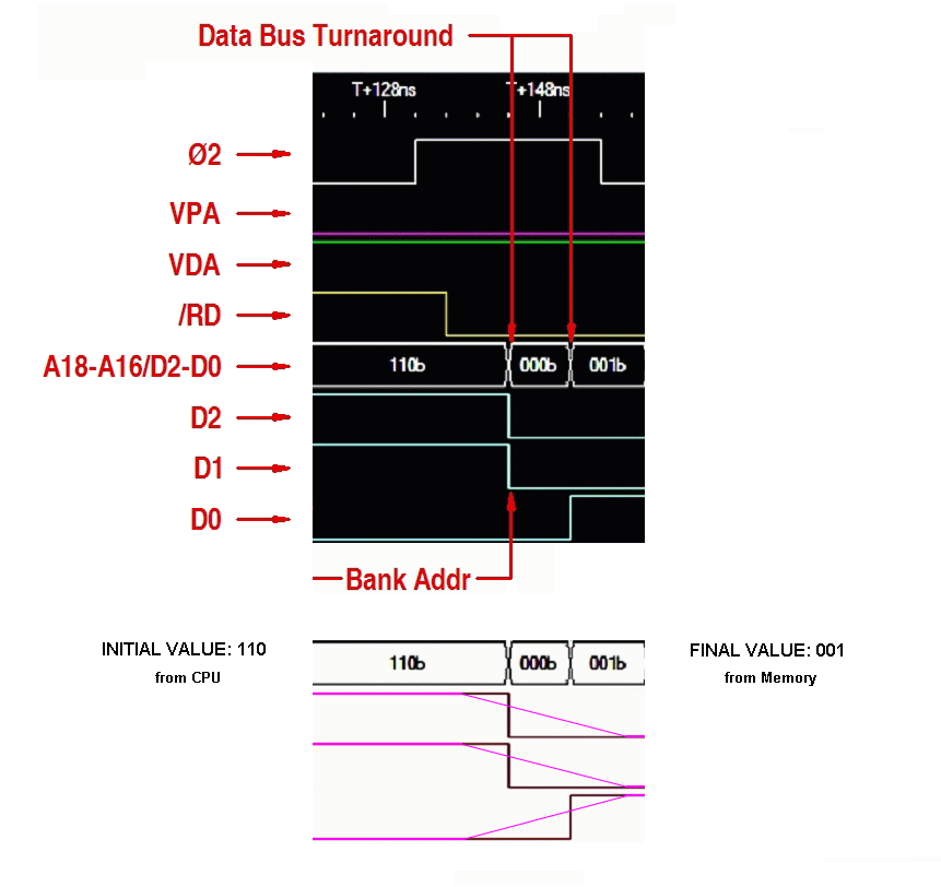

As for the Logic Analyzer traces, they're intriguing and also somewhat confounding, given that their interpretation has some potential pitfalls which I'll mention briefly for anyone who's interested. The LA display shows waves with crisp, instantaneous transitions, but we know that's not the reality. In fact, the voltages take some time to ramp up and down.

I agree the trace depicts Ø2 as being asymmetric, but (c) isn't the only possible cause -- (b) is just as plausible, if not more so.
Are you talking about the brief period around T+148ns when the value 000 (binary) is sandwiched between the initial value of 110 and the final value of 001? The seeming dead time is only an artefact.
Below the excerpt from BDD's diagram I've redrawn the D2, D1 and D0 traces, superimposing (in purple) a coarse suggestion of the actual voltages. Per point (a), the transition is already well under way before it's recognized by the LA. And here's the wrinkle. Per point (b), the LA's threshold can cause falling transitions to be detected sooner than rising transitions. (Also the memory chip itself may be stronger pulling low than pulling high.) That's why the bus seems to change from 110 to 000, then from 000 to 001. But really it's just the unfolding of a single event. All the lines began their transition at the same time. And the transition was simply from 110 to 001.
[regarding the contention issue] it appears the RAM gets off the bus just in the nick of time.
Again I'm not sure when is the event you mention, but I do see an event that shows cause for concern.
Unless I'm missing something, at T+8ns the RAM plainly doesn't get off the bus in time.
We see the bus lines change from 101 to 000, which must surely be the CPU's doing. But /RD is still low, which means RAM hasn't yet been told let go. RAM and the CPU are in contention, and it appears the CPU's stronger drivers won at least a partial victory... enough to cross the LA threshold, that is. (An oscilloscope would likely reveal indeterminate voltages, neither solidly high nor low.)

The LA display shows waves with, crisp instantaneous transitions, but we know that's not the reality. In fact, the voltages take time to ramp up and down.
Yep! Typical output rise and fall times for 74AC parts are extremely short, well down in the single digit nanosecond range. But they aren't instantaneous. The logic analyzer has an adjustable voltage threshold which when crossed, constitutes a logic 1 (rising edge) or logic 0 (falling edge). There's no in-between and relatively little hysteresis (see manufacturer's specs further down).

At this point, it is appropriate to note that despite what the data sheet says, the 65C816's inputs clearly recognize TTL levels. Scoped samples of data bus activity taken from POC V1.1 running at 12.5 MHz a few years ago showed that a logic 1 did not make it past 2.6 volts in the roughly 30ns that the SRAM was driving the bus. That is well short of the minimum logic 1 voltage (VDD × 0.8 ) specified in the data sheet. If that spec were true, the computer would not be functional.
  • as BDD noted, timing resolution is limited because samples are taken only every 2 ns.
Considering that Ø2 in this run was 20 MHz, that gave me 25 samples per machine cycle, which is good enough to get a reasonable picture of what is going on.
That could probably be determined by switching to a clock rate whose half-cycle time is a even number. However, given the manufacturer's claim for voltage threshold resolution (below), I'm more inclined to think it's a limitation of the 2ns resolution. The best the LA can do is 12.5 samples/half cycle at 20 MHz. So it's gonna have to fudge one way or the other.
N.B., the %001 value is the output from the SRAM—I poked that value into location $008000 before running the test code and capturing activity. The %110 right before it is the bank address ($06).
The %000 in between the bank address and the data is what I thought might be some dead time. You really can't tell if the MPU is driving the bus at that point or if it is floating. I'm pretty sure that the SRAM is not driving it, basing that assumption on the SRAM's timing specs. The SRAM appears to be driving the data bus right around when the data sheet specs would suggest. which is 6-or-so nanoseconds after /RD goes low.

The threshold spec does give some wiggle room for saying when a logic 1 or logic 0 has been detected. However, I think we need to keep in mind the extremely fast edges that are characteristic of 74AC logic. Not much time will be spent in that +/-100mV no-man's land.
(Also the memory chip itself may be stronger pulling low than pulling high.) That's why the bus seems to change from 110 to 000 (dead time), then from 000 to 001. But really it's just the unfolding of a single event. All the lines began their transition at the same time. And the transition was from 110 to 001.
The SRAM has a totem pole output, so it will sink harder than it can source.
In my previous post, I did say to take the measurements with a grain of salt. :D Limitations in resolution coupled with some uncertainty as to when the LA thinks something is a logic 1 or a logic 0 can give the appearance of timing anomalies that aren't really there. The only thing I can offer is 1) the machine works at 20 MHz; 2) the SRAM is not as warm as the physically much-larger MPU when running the "torture" code.

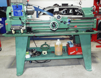

Later in the year, medical malarkey started giving me some grief. I ended up trading in my pacemaker for a pacer/defibrillator, which involved some dicing and slicing at the hospital. So far, so good, only to then get whacked by the Chinese plague. :evil:
Anyhow, I powered up POC V1.2 again in mid-December and it has been continuously running since then. The Ø2 rate is at 20 MHz and it's just sitting there on my desk, humming away. Every now and then, I check uptime and read and write some disk blocks to exercise the hard drive.
