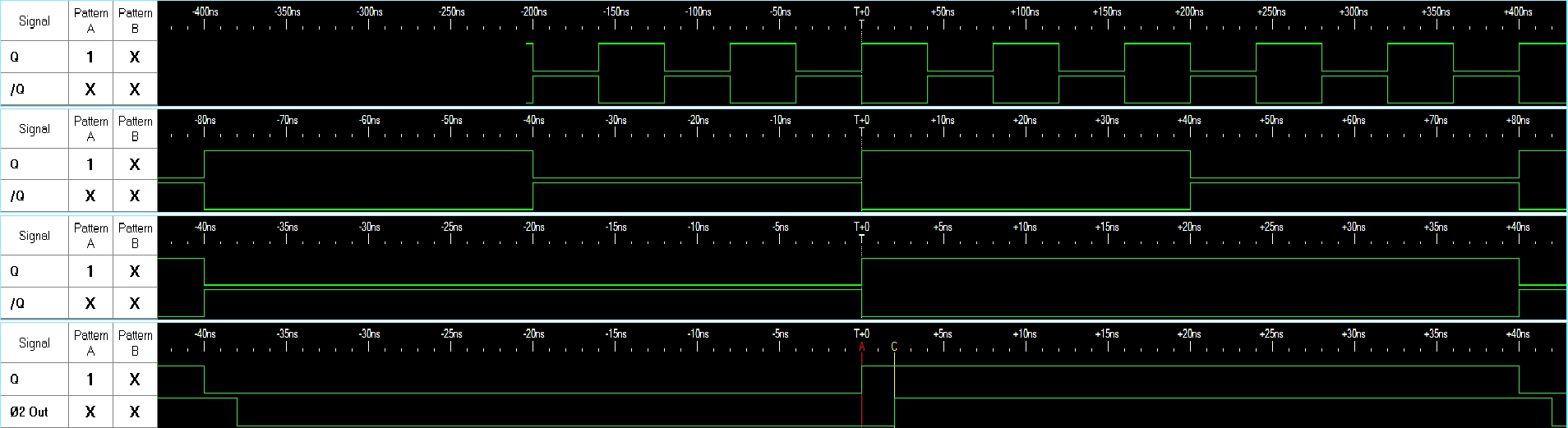

In a system that generates Ø2 from a flop, the Q and /Q outputs are exactly 180° out of phase.
I used to believe this, but it turns out not to be a reliable assumption.
In the context of what we build, I think my statement can stand.
If one is in hair-splitting mode, it could be argued that Q and /Q are not exactly in step due to the sub-nanosecond times required for electrical impulses to navigate their way through the flop's internal circuitry. I'd readily concede that. However, in the practical world in which a high-speed 65C02 or 65C816 system may have a 50ns machine cycle time, the Qs can be considered to be exactly 180° out of phase.

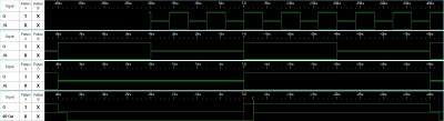

Your post got me curious, so I once again put the logic analyzer to work to see just how closely the flop's outputs complement each other. Below are some signal captures gotten from a 74AC74 flop in POC V1.2. This is the flop that the clock stretcher replaces. Sampling rate is 500 MHz and the capture trigger is the rising edge of Q. Other than one signal in the final trace in the set, signals are being picked up right at the flop's pins, with the jig's lead length being approximately 210mm.
Clock Generator Outputs — 74AC74 Flip-Flop @ 5 Volts
Trace descriptions:
  • The first trace is a "high altitude" view of the flop's Q and /Q outputs with the scale resolution set at 10ns/div.
  • The second trace is the first trace with the scale resolution increased to 2ns/div.
  • The third trace was a fresh capture with scale resolution set to 1ns/div, which is the finest resolution to which the logic analyzer's software can be set. Q and /Q appear to be 180° out of phase. The uncertainty is ±1ns.
  • The final trace is a little different than the previous three. Here Q is being picked up at the flop, as before. The Ø2 Out signal is Q being passed through a 100 ohm metal film resistor, which is present to dampen ringing. Triggering is still from Q. Note that Ø2 Out lags Q by 2ns (interval A-C on the time scale).
I think for our purposes, the Q and /Q outputs may be considered to be exactly 180° out of phase

I once again put the logic analyzer to work to see just how closely the flop's outputs complement each other [...] I think for our purposes, the Q and /Q outputs may be considered to be exactly 180° out of phase
Hmm, glad to see some experimental data. And indeed those first three traces seem to verify one case of a flipflop whose complementary outputs do switch simultaneously. I'm kind of glad to hear it, actually. Nevertheless, the datasheet doesn't guarantee this, as I already explained.
I don't object to someone collecting experimental data and using it to help achieve their diabolical goals! :twisted: Like so many decisions, it's a tradeoff. The upside is, you may gain a benefit from relying on the undocumented behavior. And the downside is the greater or lesser risk of disappointment you face, commensurate with how casually or thoroughly you yourself personally verify the parts.
As for the fourth trace, can you elaborate, please? It seems to bear on a different topic altogether. You're comparing the waveforms immediately before and immediately after the damping resistor, is that right?
I agree: testing one or two flops doesn't make a whole data set (although testing the flop in V1.1 produced identical results to the one in V1.2). My point is at the levels we hobbyists work, the Qs can be considered to be exactly 180° out of phase.
Diabolical goals? :lol: There is no goal, other than a quest for information. :D
In this case the upside is the benefit you gain from relying on the undocumented behavior.
The timing diagram of the flops I am using clearly shows Q and /Q changing state at the same time (page 6). The references are tPLH and tPHL. Nothing in the data sheet says those two parameters can be expected to differ.
74ac74_d_dual.pdf
74AC74 D-Type Flip-Flop
(461.14 KiB) Downloaded 79 times
Correct. That capture was strictly for curiosity's sake and had nothing to do with the observation of the Qs' change-of-state relative to each other.
