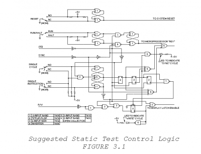

One of the prototype cards has been set up as a static debug board. I've taken the Mostek example circuit from the hardware manual (pg. 125) and put it into an old Xilinx XC9536 CPLD. I happened to have a few lying around from a previous project and they are both 5V powered and 5V tolerant. It's very much a work in progress but the halt/run/single step operates properly. What is missing is an address/data bus display.

Hey, I see you just posted about ordering a WDC cpu from Mouser. And earlier you mentioned creating your own version of the Stop-Step circuitry published in the original MOS manuals from the 70's. Just a reminder, the 21st century WDC product is such that the RDY input can extend read cycles and write cycles. (The original NMOS chips couldn't extend writes, only reads.) Hence you may wish to or be forced to alter the Stop-Step circuitry used. Cheers,

@Jeff, Thanks for bringing that up. Can't say I understand the write cycle part of the step-stop circuit, have just implemented it as given. Haven't read much of the 65C02 data sheet yet. Last time I seriously wrote 6502 assembler was back in the early 80's, so I'm just a little rusty ;). Am looking forward to the new instructions. The bit set/reset stuff makes me wonder if I should put some IO on page zero.
Well, I wouldn't bother with that circuit, myself -- it's needlessly complex. It accommodates the old NMOS parts, which don't allow stopping the clock. But on the new CMOS parts you can stop the clock. Also the circuit features the ability to step one instruction at a time, which is nice but not really necessary. All you really need is the ability to step one clock cycle at a time.
