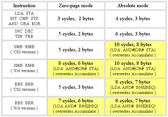

As a rule, vintage 6502 computers don't map their I/O devices into zero page. It's almost a tradition that the decode hardware will put I/O at some higher address instead. :) But should new 65xx designs follow the rule, too? I started this thread to talk about how much faster I/O in zero-page can be, and how the pros clearly outweigh the cons for some new designs.
I have edited this post in light of subsequent discussions. Here are the main points to consider:
  • benefits of I/O in z-pg: speed
  • benefits of I/O in z-pg: smaller code size
  • possible impediment: users' unfamiliarity with the idea
  • possible impediment: consumption of zero-page addresses (balanced against fast I/O as a priority)
  • possible impediment: decode hardware has less freedom to ignore address lines -- you need full decoding (or close to it).
Code Size and Speed
The chart below shows various instructions commonly used for I/O, listing the size and speed. In the cases (shown in color) where a given mode or instruction is not available, a roughly-equivalent "next best" code sequence is evaluated. For BBS/BBR and their equivalents, the usual optional extra cycles apply (for branch-taken and branch-taken with a page crossing).
The 33% speedup for byte-oriented I/O (eg LDA STA) is noteworthy. Even greater are the gains for BBS/BBR (about 55%) and SMB/RMB (100% :shock: ) -- bit-oriented instructions which, unfortunately, are available only on the 'C02. However, even the SMB/RMB-equivalent code (used by '816 and NMOS '02) shows a 20% speedup if the I/O is in zero-page.
IMO, these gains could in some cases make or break the viability of a heavily I/O bound application. Example: SPI or a software UART.
If I were being more rigorous, the equivalent routines should begin with PHA and end with PLA. But that'll often be unnecessary, as Garth mentions below.
On the '816, "Zero Page" is known as Direct Page, and is relocatable via the Direct Page register. It's worth remembering that, during I/O, this register must be set to zero (or whatever page is decoded for I/O). This is usually a non-issue but may be a nuisance if you're using D's esoteric capabilities elsewhere in your code.

Even though I've said it would be nice to have SMB & friends, your substitute code was of course covering all (or most of, since it did not preserve P) the bases, but we usually try approach the code in a way that needs less of that.  For example, the SPI bit-bang code I have on my website includes this for sending a byte:

The speedup we see here is from shorter instructions, from not having to push/pop A, and from not having a bit mask held in A. I hope I'm correct in assuming CLK_HI_PULSE assembles an INC abs followed by DEC abs (or vice versa).

          DEY           2 ;Decr the counter
          BNE  Looptop 2/3;if counter not 0 yet, branch back & repeat the loop.
          PLA           4 ;clean the input number off the stack
          PLY           4 ;
          RTS
The next version averages 272.5~/byte -- a 9.7% speedup compared to the original. Y is not used, and the "bottom" of the loop is duplicated -- ie, there are two instances of BNE Looptop and the preceding instructions.
SEND_BYT: PHA            3 ;Push the input number as TopOfStack
          LDA  #1        2 ;value of the clk bit
          TRB  VIA3PB    6 ;ensure clk is low
          TSX            2 ;X=S so we can use X to address TOS for shifting
          LDA  #2        2 ;value of the MOSI bit
          SEC            2 ;the only 1 that'll get shifted into TOS
          ROL  101,X     7 ;carry <- TOS <- 1. msb is first to go to C for testing.
Looptop:  BCC  BitIs0   2/3;if C clr, branch fwd
          TSB  VIA3PB    6 ;bit was a 1. Set the MOSI bit in VIA3PortB
          INC  VIA3PB    6 ;Pulse the clock line.
          DEC  VIA3PB    6 ;
          ASL  101,X     7 ;carry <- TOS <- 0
          BNE  Looptop  3/2;If TOS<>0 br back to repeat the loop.
          BRA  Exit      3 ;
BitIs0:   TRB  VIA3PB      ;otherwise Bit was a 0. Clear the MOSI bit in VIA3PortB
          INC  VIA3PB      ;Pulse the clock line.
          DEC  VIA3PB      ;
          ASL  101,X       ;carry <- TOS <- 0
          BNE  Looptop     ;If TOS<>0 br back to repeat the loop.
          PLA              ;clean the input number off the stack
Exit:     RTS              ;
The "I/O in zero-page" version averages 189.5 ~/byte. This is 44% faster than the already-optimized version. And X and Y are both preserved.
SEND_BYT: RMB0 VIA3PB    5 ;ensure clk is low
          SEC            2 ;the only 1 that'll get shifted into Accumulator
          ROL  A         2 ;carry <- Acc <- 1. msb is first to go to C for testing.
          SMB1 VIA3PB    5 ;bit was a 1. Set the MOSI bit in VIA3PortB
          INC  VIA3PB    5 ;Pulse the clock line.
          DEC  VIA3PB    5 ;
          ASL  A         2 ;carry <- Acc <- 0
          BNE  Looptop  3/2;If Acc<>0 br back to repeat the loop.
          BRA  Exit      3 ;
BitIs0:   RMB1 VIA3PB      ;otherwise Bit was a 0. Clear the MOSI bit in VIA3PortB
          DEC  VIA3PB      ;
          ASL  A           ;carry <- Acc <- 0
Exit:     RTS              ;
Corrections are welcome if there's a typo or other boo-boo anywhere. Further speed increases are possible, up to twice as fast as the original -- or more. :shock: I can share that code if anyone's interested. With that version, I/O in zero-page is definitely helpful, but the speedup is mostly due to a table-based approach. Each nibble of data generates a 16-way branch, and each branch destination outputs 4 bits without pausing to take a breath! There's also an assumption that all bits of VIA3 PortB -- including the six bits not used for SPI -- may be read, held in a register, then written back later. That's problematic if an interrupt might modify any of those six bits, as the changes would be lost. But if interrupts don't touch those bits, or if the bits are used as inputs, then you're good to go! :D
cheers
ps- the lead post has been revised somewhat -- for clarity, and for an '816 and NMOS '02 perspective on I/O in zero-page.
