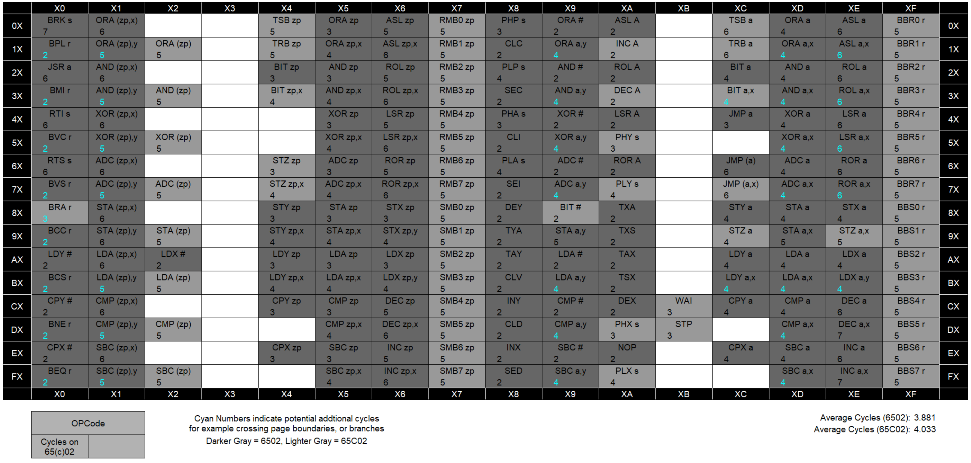

I've been procastinating by mostly gaming but also by making this:
it should be kinda self explanatory. (i tried to avoid using too many or any colors. so it's mostly black/gray/white)
i liked how clean to look at this Opcode matrix is: https://www.masswerk.at/6502/6502_instruction_set.html
but sadly i was unable to find such a clean version for the 65C02.
sure you got the datasheet and sites like this: http://www.oxyron.de/html/opcodesc02.html but neither are that great to look at...
so i just made my own!
i know the 65C02 has some different cycle counts on some instructions, but pfffft. who needs that.

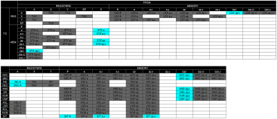

i also made these 2 tables to show off all addressing modes for Loads and Arithmetic/Logic instructions:
Cyan instructions = 65C02 exclusive
tell me if there are some wrong cycle counts or missing instructions.
no idea if these are useful to anyone.

Interesting instruction tables. In the one for transfers, don't forget the stack as a memory addressing mode.
I would try structuring the opcode table with a different grouping of bits, which better reflects the way opcodes are internally decoded by the 6502. Broadly speaking there is an aaabbbcc pattern, which gets confused if you make the table "square" with an xxxxyyyy pattern. I think it makes sense to have rows with the aaa000cc bits, and columns with 000bbb00 bits.
