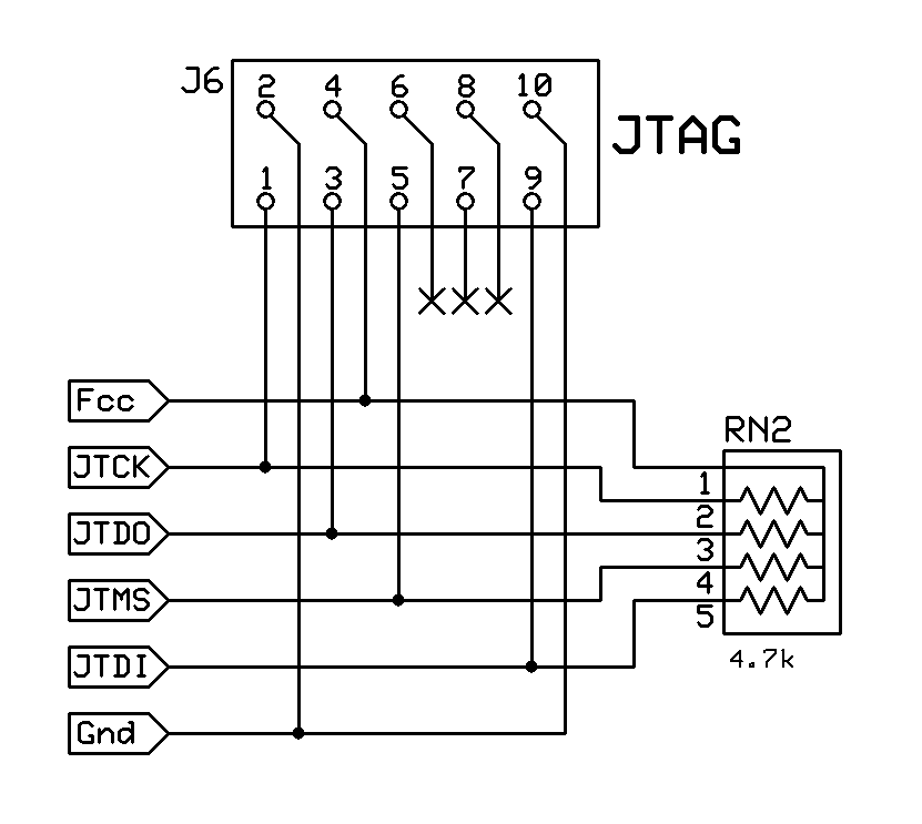

I tried to read your JTAG connection schematic but, once again, color is preventing me from clearly seeing what's in it.
how? the full schematic above your post is in Monochrome.

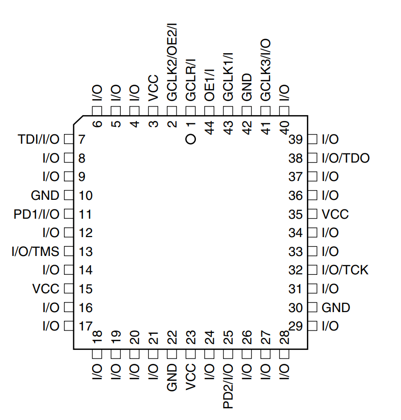

OE is exactly what the name implies. That said, those pins are not dedicated to that function and can be used as regular I/O pins.
PD is "power down" and would be used to reduce power consumption when the circuit is idling. As with OE, PD can be used for regular I/O.
Other than avoiding the use of the designated JTAG pins as I/O (there is a booby-trap waiting for you if you do declare one of those pins for anything other than JTAG), and applying your clock signal (if used) to GCLK and reset to GCLR, you are free to use pins as required. However, I recommend you design your logic before you lay out the rest of the circuit and let the fitter decide how to best use the CPLD's resources.
yea turns out the datasheet shows most if not all of these, sadly not in a list that explains them directly, but via a block diagram.
also to design the logic i need to set input and output pins so i need to define where the inputs/outputs go before i make the circuit...
or am i missing something?
since you use the Chip's pin number to assign Inputs and Outputs...
I saw the small graphic that you said is the JTAG header and thought it was supposed to be different than the main schematic.
also to design the logic i need to set input and output pins so i need to define where the inputs/outputs go before i make the circuit...or am i missing something?
During the early stages of the design flow, it's best to not assign pins. For example, when I was designing the logic for my POC V2.0 unit (ATF1504AS), I declared all the inputs and outputs, but did not assign them to specific pin numbers at that time—with two exceptions:

What happens when you take this route is the fitter that runs following a successful compilation figures out which macrocells to use for different parts of the logic and after the fitter has done that it then assigns pins. Note that I declared only two pins: reset (pin 1) and Ø2 (PHI2) on 43. Everything else was assigned by the fitter.
If you assign pins before you've finished your logic design you may discover the source will compile but the fitter won't be able to fit the design to the CPLD. You can determine if your design will fit by examining the file xxxx.fit, where xxxx is the name of the source file. Scroll all the way to the end and you should see something such as the following:
----------------  End fitter, Design FITS
$Device PLCC44 fits; JTAG ON; Secure OFF
FIT1504 completed in 0.00 seconds
That's the fitter informing you your design will fit within the constraints of your device and that the JTAG port is not to be used for logic. Here's where you need to watch out for a potential bobby-trap.
If you program a device to use the JTAG pins as logic I/O you will not be able to erase and re-program the device later on because the JTAG port will no longer be a JTAG port. Hence you must be careful to select the correct device code (f1504ispplcc44 in the above example, the isp after 1504 stands for in situ programming). Otherwise, the fitter will assume the JTAG port is not being used as a JTAG port and will likely assign those pins to something else. If the above blurb says JTAG OFF find out why before you program a device and turn it into a paperweight.
Assuming your design fits, higher up in the xxxx.fit file you will see something like the following:

The above is the pin assignments the fitter worked out for your device and design. Using that list, you would then lay out the circuit to go with the logic. That is when you assign pins.
During the fitting phase, several things are happening, one of which is the distribution of macrocells to different logic functions. Each macrocell has a limit on how many terms can be accommodated and the fitter tries to equalize macrocell usage as efficiently as possible. If you force pin assignments you may end up with a macrocell that is expected to handle more than it can, and the design won't fit.

Proxy wrote:
I'm also not 100% sure on the pinout of the JTAG connector.
See below.
File comment: JTAG Port
In my POC units, Fcc is connected to 5 volts (Vcc) through a self-resetting fuse. Be sure to liberally bypass FCC to ground with both an electrolytic (100 µF is good) and an MLCC (.1 µF is good).
pin     1 = RESB;                                 /* system reset          */
pin    43 = PHI2;                                 /* system clock          */
So why did you assign reset and Φ2?

That would be down to the features of the ATF150x family. There are 4 "global" input only pins.
On the 1504 pin 1 is global clear, pin 2 global clock 2/output enable 2, pin 43 global clock 1, pin 44 output enable 1
oh, i didn't know i need a pullup for the JTAG pins.

Martin A wrote:
actually there are 3 global clocks. Pin 43 (GCLK1), Pin 2 (GCLK2), and Pin 41 (GCLK3).

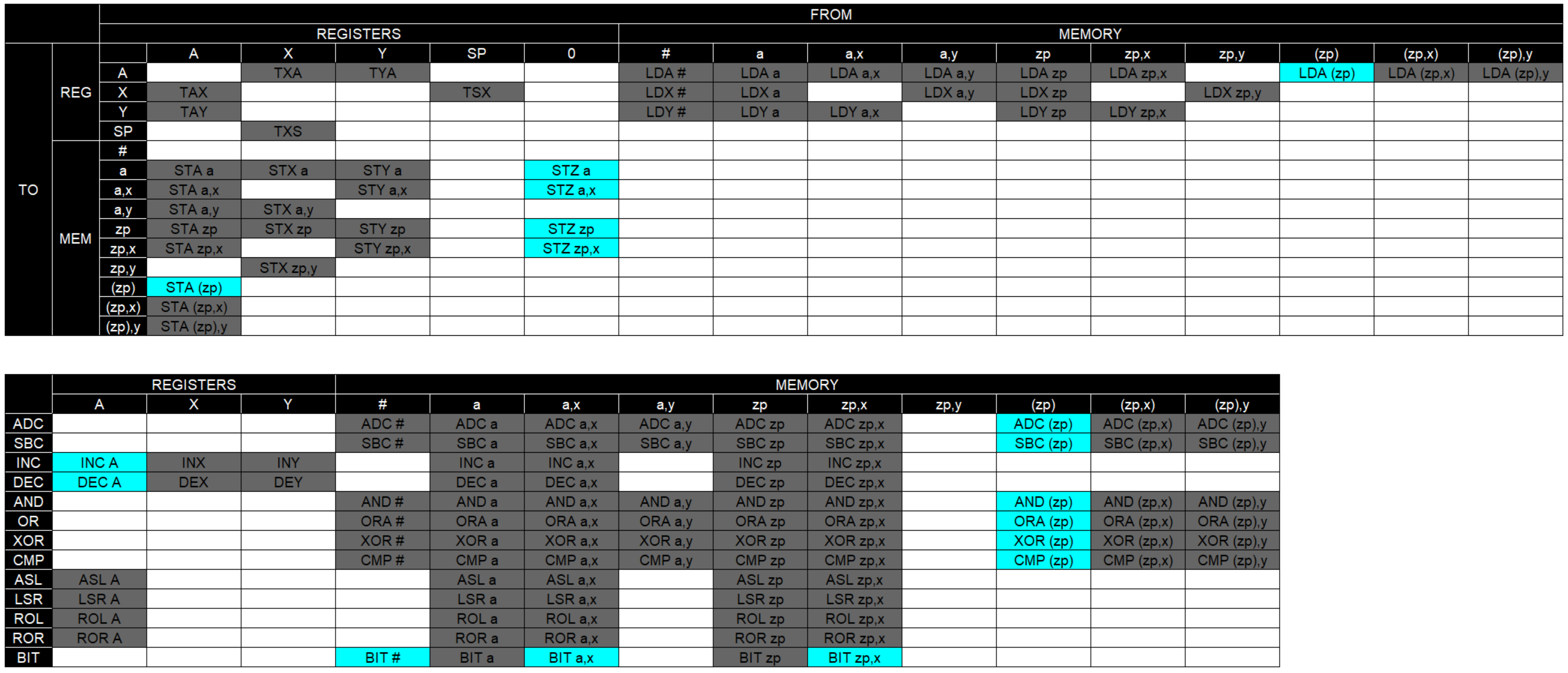

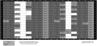

I've been procastinating by mostly gaming but also by making this:
it should be kinda self explanatory. (i tried to avoid using too many or any colors. so it's mostly black/gray/white)
i liked how clean to look at this Opcode matrix is: https://www.masswerk.at/6502/6502_instruction_set.html
but sadly i was unable to find such a clean version for the 65C02.
sure you got the datasheet and sites like this: http://www.oxyron.de/html/opcodesc02.html but neither are that great to look at...
so i just made my own!
i know the 65C02 has some different cycle counts on some instructions, but pfffft. who needs that.
i also made these 2 tables to show off all addressing modes for Loads and Arithmetic/Logic instructions:
Cyan instructions = 65C02 exclusive
tell me if there are some wrong cycle counts or missing instructions.
no idea if these are useful to anyone.
anyways i should stop with this and just order the damn boards. i've checked over the PCB in KiCad multiple times and didn't find any mistakes. i checked the files generated by WinCUPL and compared it to the PCB (which is pointless as i can always change the pinout of the program if i did make a mistake there).
the only thing holding me back from ordering all the stuff is fear that i somehow still missed something... and i don't know how to work against that.

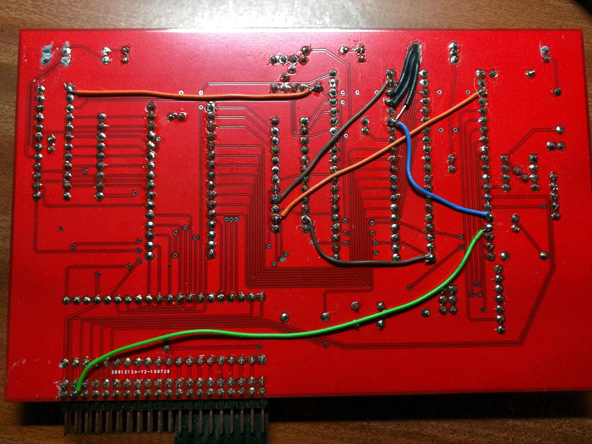

Sometimes you just have to do it and start somewhere (with PCB). Then when you want to make changes... well... you do this...
then you think about ordering a new PCB ;-)

PostPosted: Fri Apr 03, 2020 9:50 pm
Interesting instruction tables. In the one for transfers, don't forget the stack as a memory addressing mode.
I would try structuring the opcode table with a different grouping of bits, which better reflects the way opcodes are internally decoded by the 6502. Broadly speaking there is an aaabbbcc pattern, which gets confused if you make the table "square" with an xxxxyyyy pattern. I think it makes sense to have rows with the aaa000cc bits, and columns with 000bbb00 bits.
