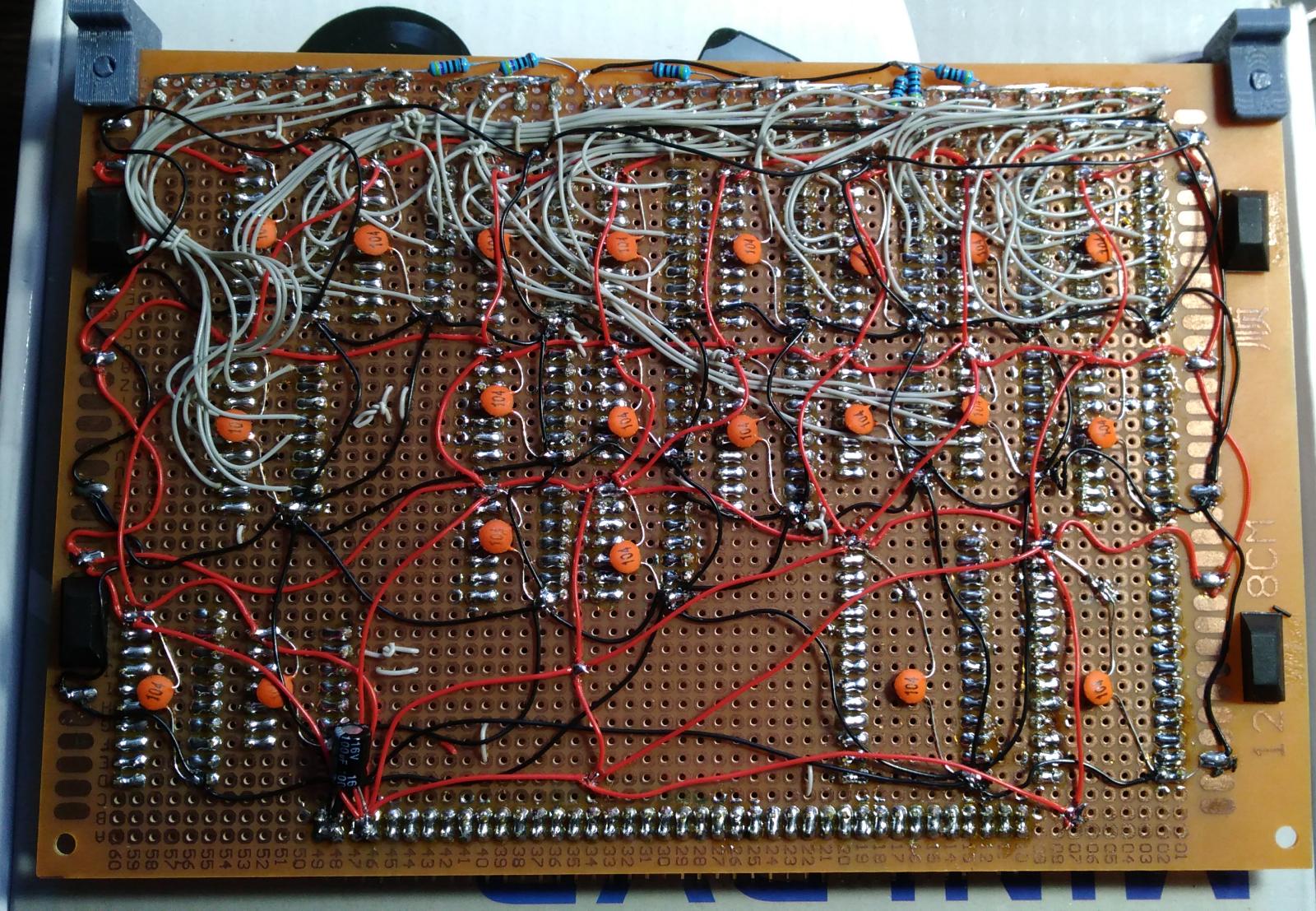

Thanks for the replies. I'm going to add vertical wires to form the proposed grid and see what influence it has.
A couple notes:
Power and ground is routed on the underside using soldered wire made for wire-wrapping.
Clock is coming from a 555 timer, but is buffered by some gates, and rising/falling edge are as fast as the rest of the signals.
We'll see how it goes.

So this would be one of the cards. I've added vertical wires, and additional ones here and there where I saw fit. Also most columns have an individual wire going to the backplane connector. Now the two remaining ones.
OK, great. Obviously I can't promise this'll resolve the symptom you were observing. But improving the ground distribution is not difficult, and may have benefits beyond what's involved in this immediate situation.
Also good. But I'll note in passing that the assignments on the backplane aren't optimal. The distance between a typical signal path and its return path would be smaller if the ground lines were assigned near the center of the backplane rather than at one end. I'm not suggesting you change that now, though.
cjs wrote:
So it seems to me that the boards in this product are about as optimum as you can get (short of using axial-lead capacitors in the same way)
That's right, and thanks for your comments. I guess I'm subconsciously assuming that SMD caps would be used in a project which also uses SMD IC's -- whose Gnd and Vcc pins are closer together, and this changes the situation. ATM I'm not able to be more concise -- perhaps I'll refine these thoughts later. This stuff is sometimes hard to think about, and always a challenge to explain.

It seems to be doing the business. Will provide more detail later, but clock edges look cleaner, and it executes successfully a little program I wrote in assembly that just counts to 256 by two's on a 1 MHz clock.

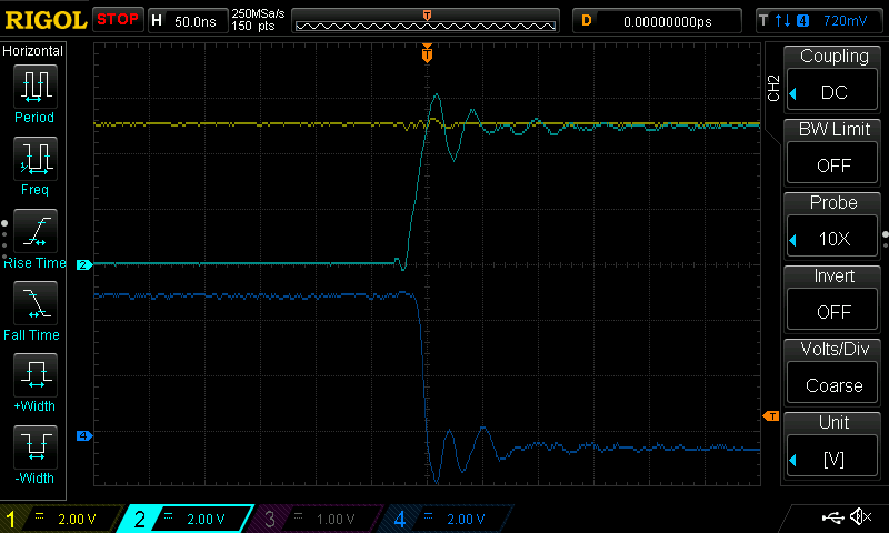

There is still some ringing on the clock (see attached, clock is light blue), but I'm not sure how much is coming from the circuit itself, or if it has anything to do with probing artifacts. It seems to work every single time now. I also attached a screenshot from a logic analyzer connected to the accumulator, showing it counting by two's as programmed. I also fixed an issue with bus conflicts during reset.
I'll try to test the RAM today.

The ringing on the screen doesn't look too bad, of course the probeheads of your scope also have some capacitance,
so the ringing might be slightly worse than seen on the screen if no probeheads are attached to the signal.
// I just had to mention this in case you might encounter a situation where your design only works with the probeheads attached to the circuitry.

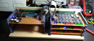

Also made a frame for the CPU (right) and peripherals (left) to sit more comfortably. First card on the left holds RAM, ROM, clock and reset. I will use a shorter section of the IDE cable and cut down the rest, but as of now comes in handy for moving things around.
